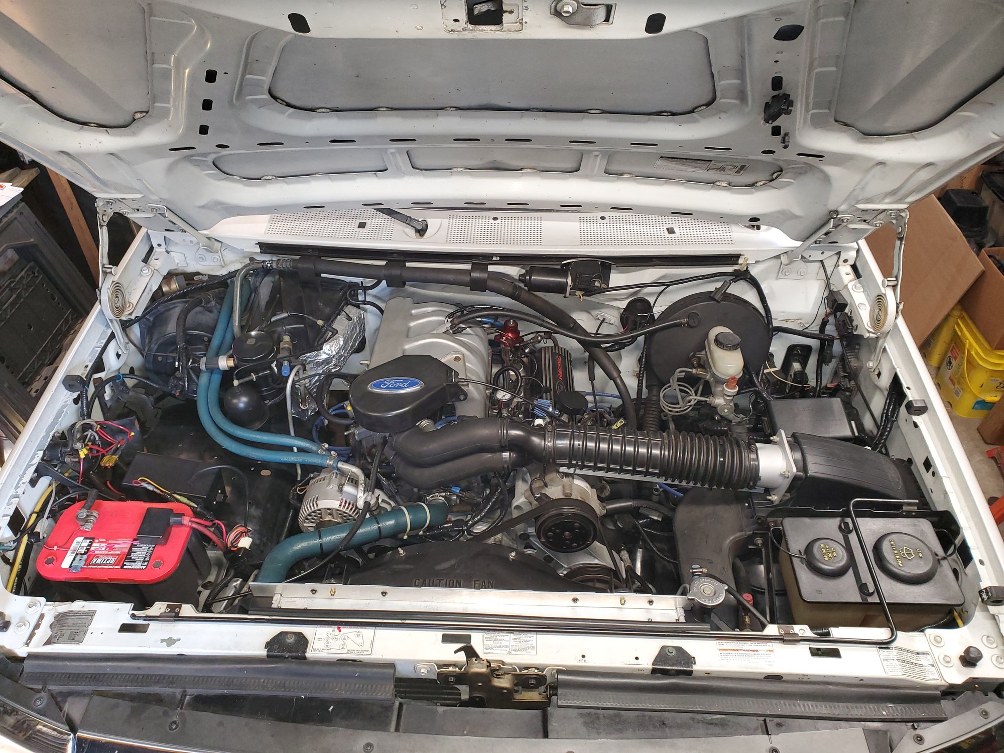

Not dumb question. I wanted to keep it to begin with & change later, but was pretty much shamed into going to SD since it's considered waste of time running MAF & could tell I wouldn't get much help if I had issues trying to run it.
And issues I had enough in the first place, anyway. Some of my own creation & others that were just there to begin with.
Adam I haven't had a chance to plug in the shift curve values that I THINK will cure the 3-OD cycling that happens at the 29mph up-shift & load as well as get it back to high 40s of stock engagement & test drive.

Here's what I did for my air box & ducting going SD, & no that's not a meter in the tract:
