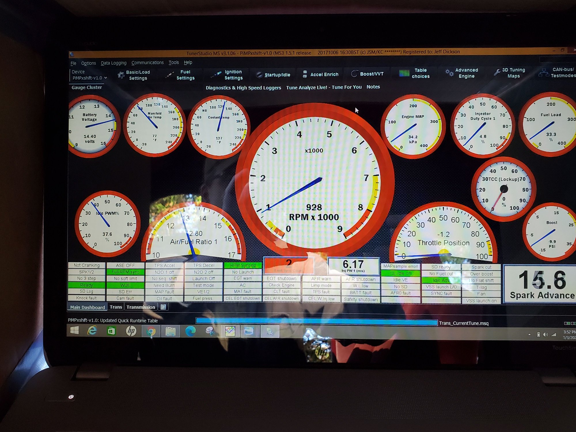

Originally Posted by wwhite
Can units be displayed as well on TS?
This is the first customization I've done to the "dash"
No not running boost, just leaving it for the vac reading for now.

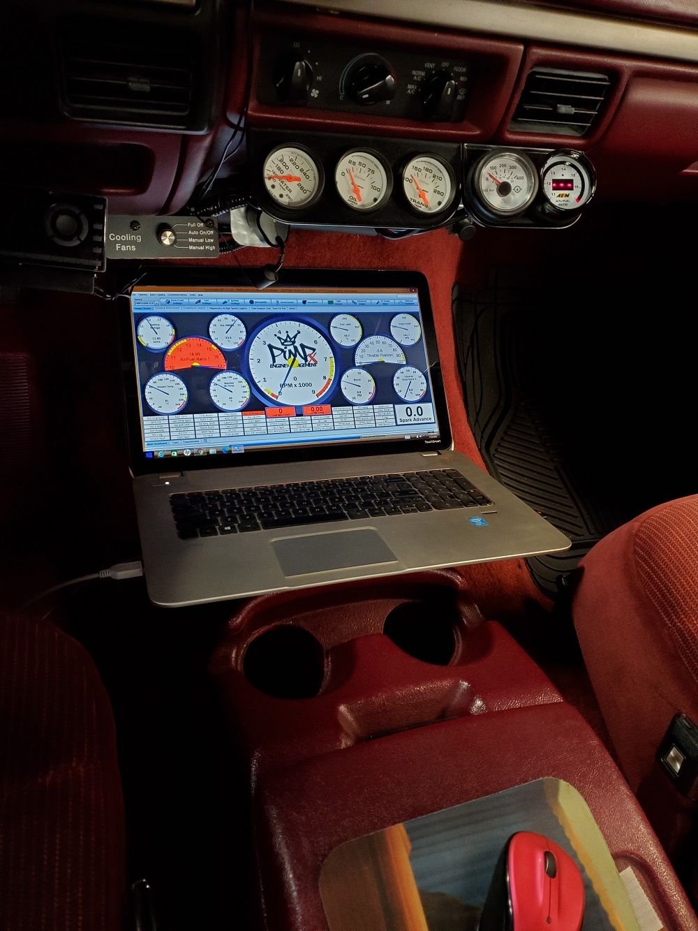

Working on frame to shade & secure laptop. This is temp & not done save for short tune trips.

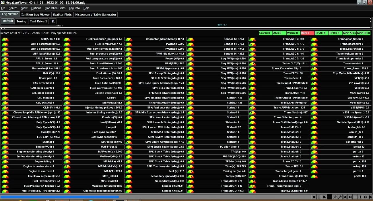

Available channels in Meaga Log Viewer.
Not all are active, but most are. Some are extrapolations, some direct measurements.

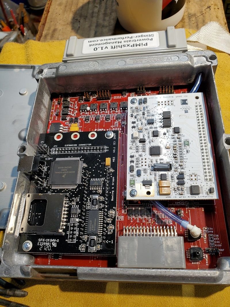

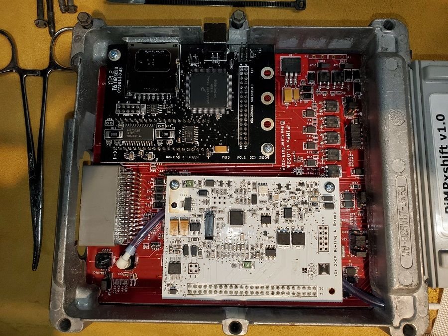

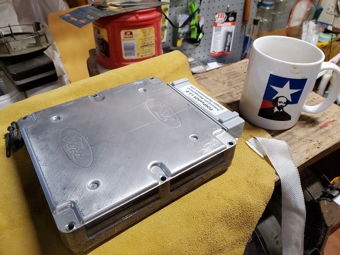

Some pics of the ECU. By the way stinger call it an ECU & yeah, I know since it controls the trans it's technically a powertrain control unit/module. Not stressing over it... it's just the computer.
Really nice components.
By the way, when you talk to the 1 of the 2 guys on the forum for tech support, the name on the copyright of the red board is going to be one of them.
