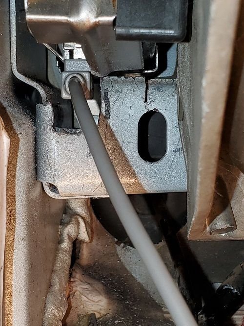

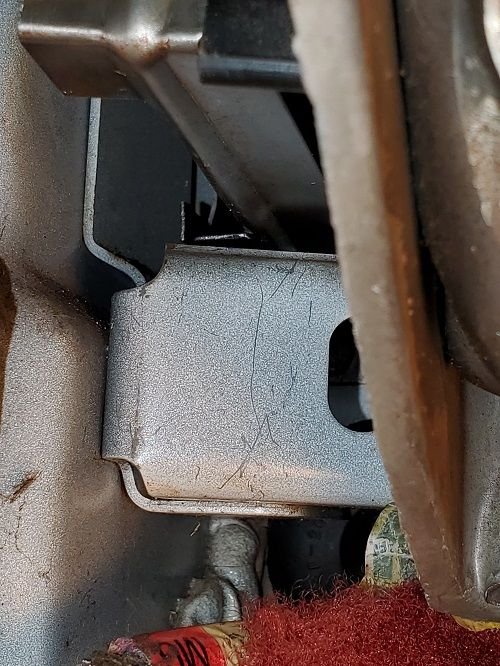

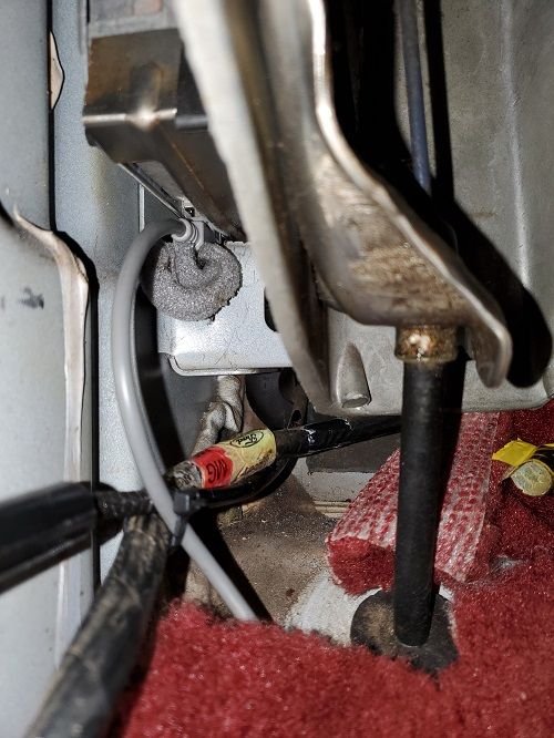

What I'd wanted to ask of those who did installs in OBS applications is, did any of you have to cut a cab support to run the USB-B right angle connector?
After cutting down the ECU cage per supplied supplement instructions, I ran into this cab-firewall brace the only place the cable could go.
With the help of a saws-all, drill & drift & hammer to bend over tab:
Nice chunk of rolled foam packing material to keep it from falling out:
I can find no mention of this listed on the stinger site.
Cable runs under carpet & padding, comes up under console foot cut-out.

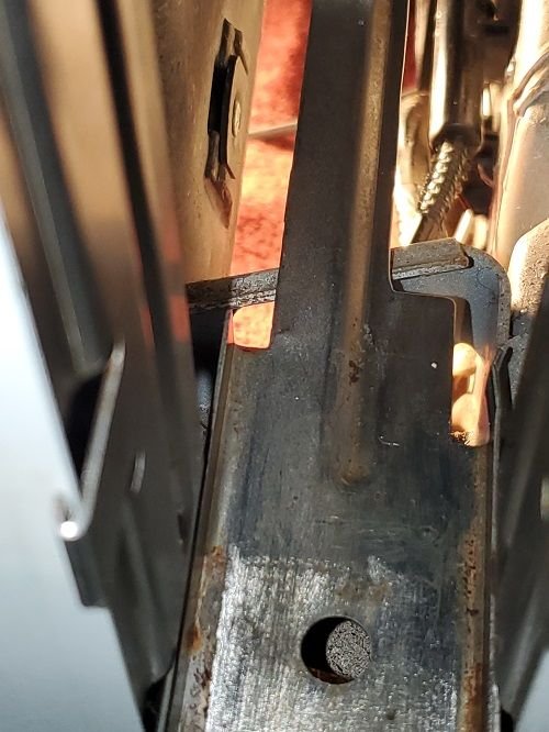

Yes, I think the earlier '87-91 years is a little bit more involved to get it to fit as shown by Mikulh posts.
I had the the exact same issue Dave. I didn't make my notch as deep, just enough to get the right-angle connector in and with no rubbing of the wire. They offer an expansion port thats located on the back of the ECU and its connector is a straight angle so no modification needed other than the steps listed on the Start-Up Guide they provide where you have to cut the ECU support bracket. Where do you have yours coming out at, the console foot cut-out? I have mine coming out behind the kick panel and bundled on the emergency brake release handle:
I think they also offer a wi-fi option for those with the expansion port.

I missed the part where you ground that out. My notch shown is as deep as I had to go & it looks deeper than your grind.
I measured, cut & folded it over with a long drift & couldn't squeeze it in, even trying to tilt cage.
So I drilled some small holes and bashed it over some more & there was just enough room to plug it in with some long assed needle nose pliers.

When I pushed my plug in there, it was resting on the notch & maybe just 20 thou clearance against the case.
Don't see how yours got in there.

I forgot I had pics of what I did. I like what you did compared to mine. Yes getting it to plug in is not easy, I also had to use long needle nose.
