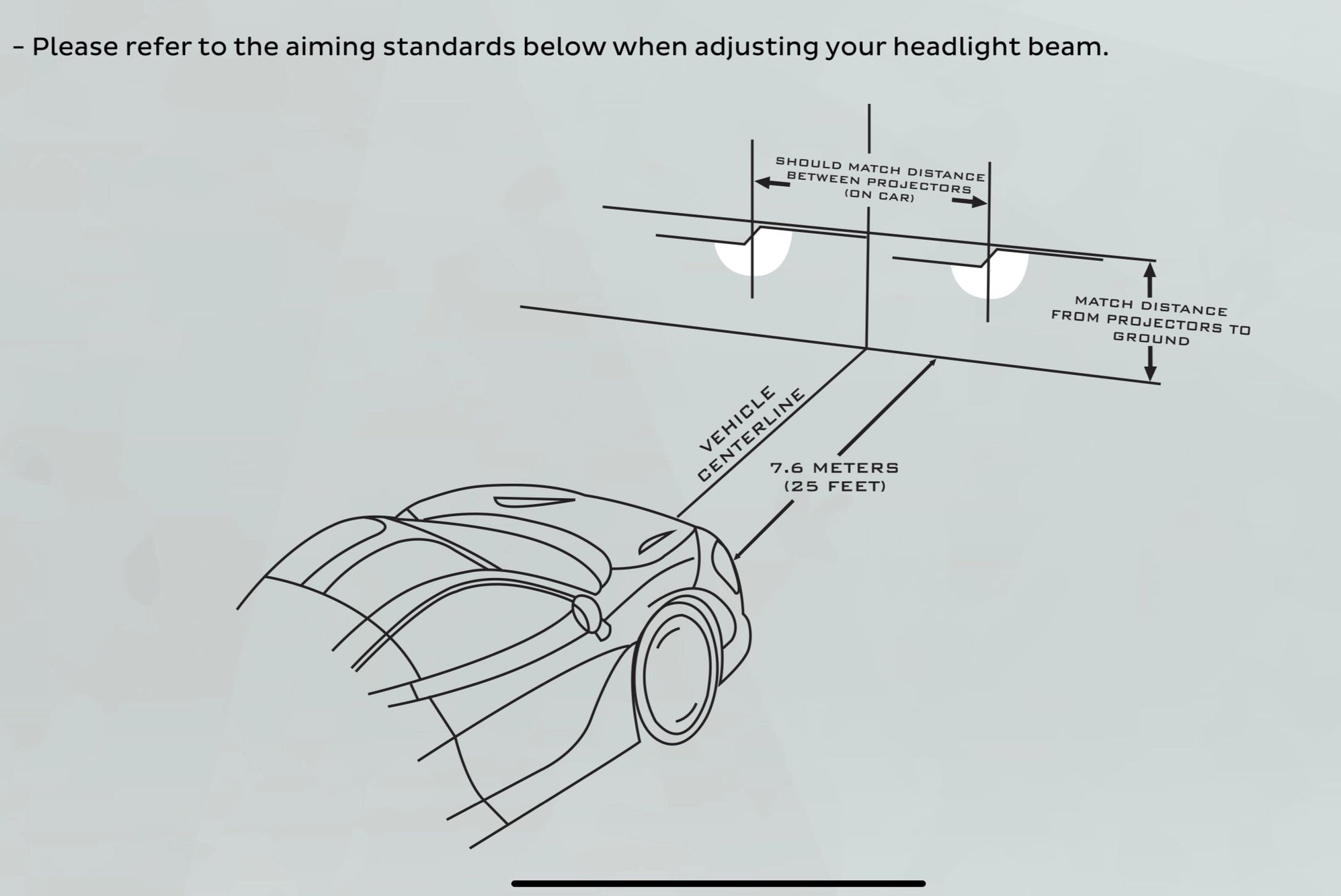

Seems to be a bunch of hating on the Z pattern, but if the lights are adjusted properly you should only see that when up close to the object viewing it on (garage door). The father away from that item the smaller the Z becomes. After I installed them yesterday it was light out so I really couldn’t test the pattern, so last night I did, which is a pain in the *** by the way (not Morimoto’s fault, just access). When 25’ away from the building the Z is definitely visible, but once on the road good to go.
Until you drive on county roads with trees, hills, etc. It is definitely visible along with the areas that aren't lighted.

how far away is the truck from the wall in these pics? Is there a downward slope? Seems pretty low based on the instructions. If you’re happy with them that’s all that matters.

Its about 30 yards off the wall and I’m on the downward slope on the other side of the parking lot. Truck is nosed down pretty good in this pic. I just took the pic to show the low vs high beam pattern. That diagram is actually what I used to aim them on level ground.
