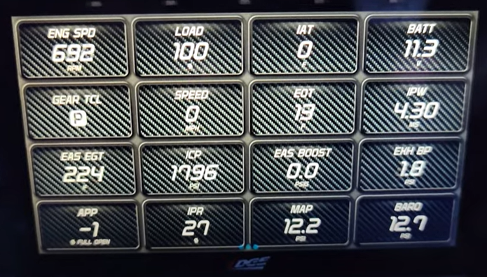

I got impatient. It was 3 degrees when I got home from work this evening. I checked the battery voltage and it was exactly 12.00V on the dot. I let the glow plugs run for a minute or so and attempted to start it. It was noticeably slow to crank but after a few seconds it did start. But only for a couple seconds and died. I immediately attempted to start it again and it started pretty quickly. Again after a couple seconds it died. I immediately tried to start it a second time and it quickly started; did the choppy running thing for 5 seconds or so and mellowed out.
So my batteries may certainly be on their way out, but with the new GPR my 7.3L appears to be plenty capable of cold weather starting for now. The 12.00V is concerning though. I'll see if it was a fluke. I pulled those logs off of my CTS3 and I don't recall if I did that before or after starting it last so I may have stole some power. I'll have to watch my voltage for the next couple weeks to try to rule that out I guess. If I start dipping below 12V after a few days of sitting I will be replacing my batteries sooner.

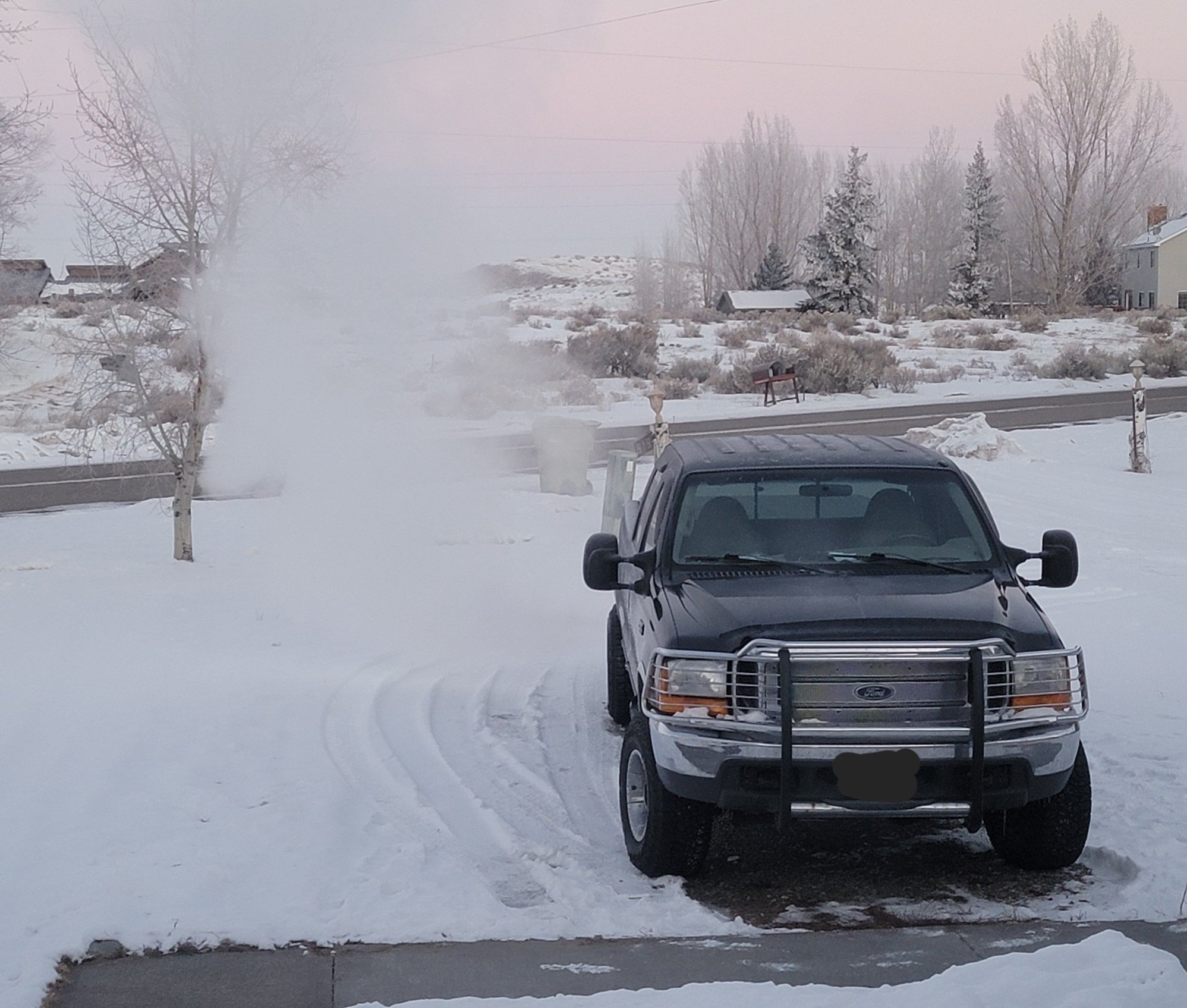

The thermometer on my back deck was read -5*F. Truck is showing -3*F. I read 12.25V at the batteries. Let the Glow Plugs run about 90 seconds.
Picture is about a minute later at high idle.

Trying to figure out why ICP, IPR and IPW are so high. I don't have any data for reference starting at that cold temperature, but 1796psi ICP, 27% IPR, and 4.3ms PW at idle seems really high. I would expect the engine RPM to be much higher at those numbers, even when cold. Unless one or more injectors are not firing, creating that load.

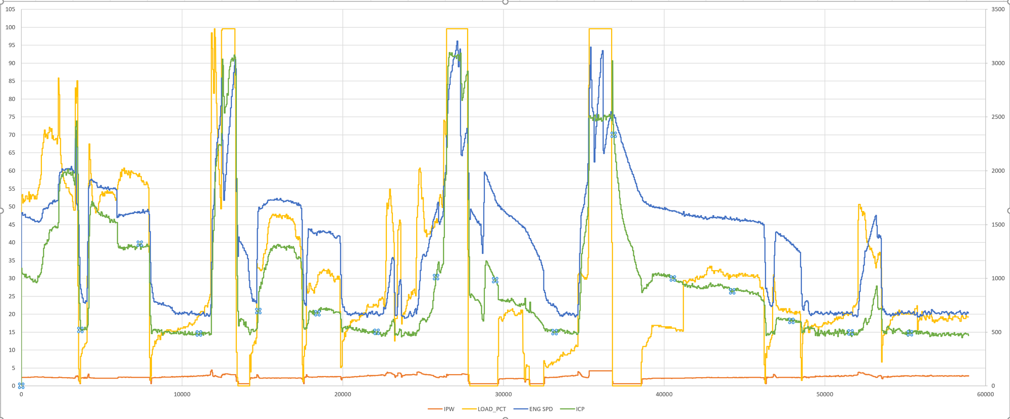

I'm not familiar with when to expect what readings yet. But this was a short drive I did after the engine warmed up last night. I am running 1023 tunes with stock injectors. I believe those first 2 short pulls were in the Daily Driver tune. The last one was in the Ludacris tune. All 3 were really short pulls though. Never even left 3rd gear.
The engine speed and ICP are using the right axis.
This data looks good to me. Even in the hot tune where IPW is somewhere above 4ms, ICP stays at 2500psi.
Did it run well for you on this test?
It did run well.
