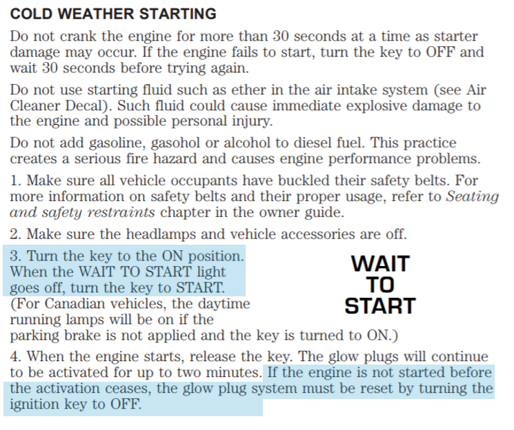

I agree with you - sounds reasonable to me. You want the glow plugs on during cranking. No need to cycle glow plugs 2 minutes in cold weather. That glow plug tip is not adding much heat to the cylinder walls, and like you said, that hot air around the glow plug is gone in one revolution of the crank, and cold air is rushing in. It's the tip that is doing the work of igniting the atomized fuel - just need a few seconds to get it hot enough to do that, and the WTS light tells us when that is.
Excerpt from the owners manual on cold start procedure.
Those of you that have better luck with long GP cycles - I'm curious why that is. Certainly keep doing that if it works for you, I just do not understand why it would help.
