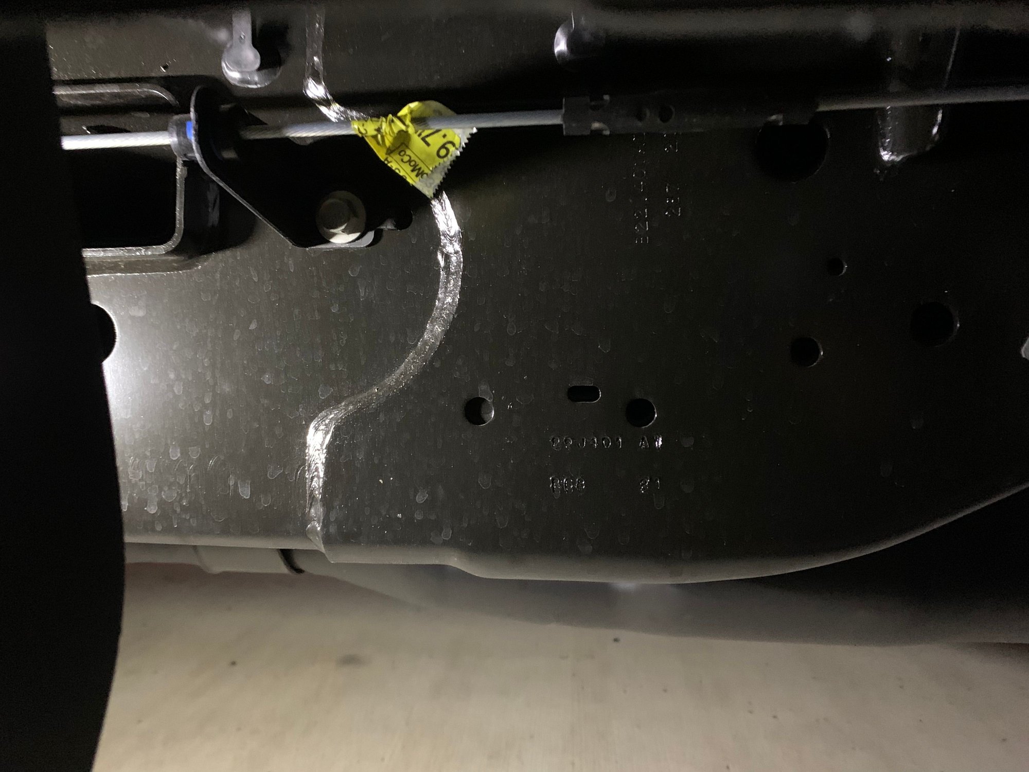

Look on the frame close to the back of the cab location. There is a white plug there for the fancy auto-steps that is powered when the doors come open and go off when the door is shut. There should be one on both sides and it will be two wires going to those plugs, one blue-ish and one is white.

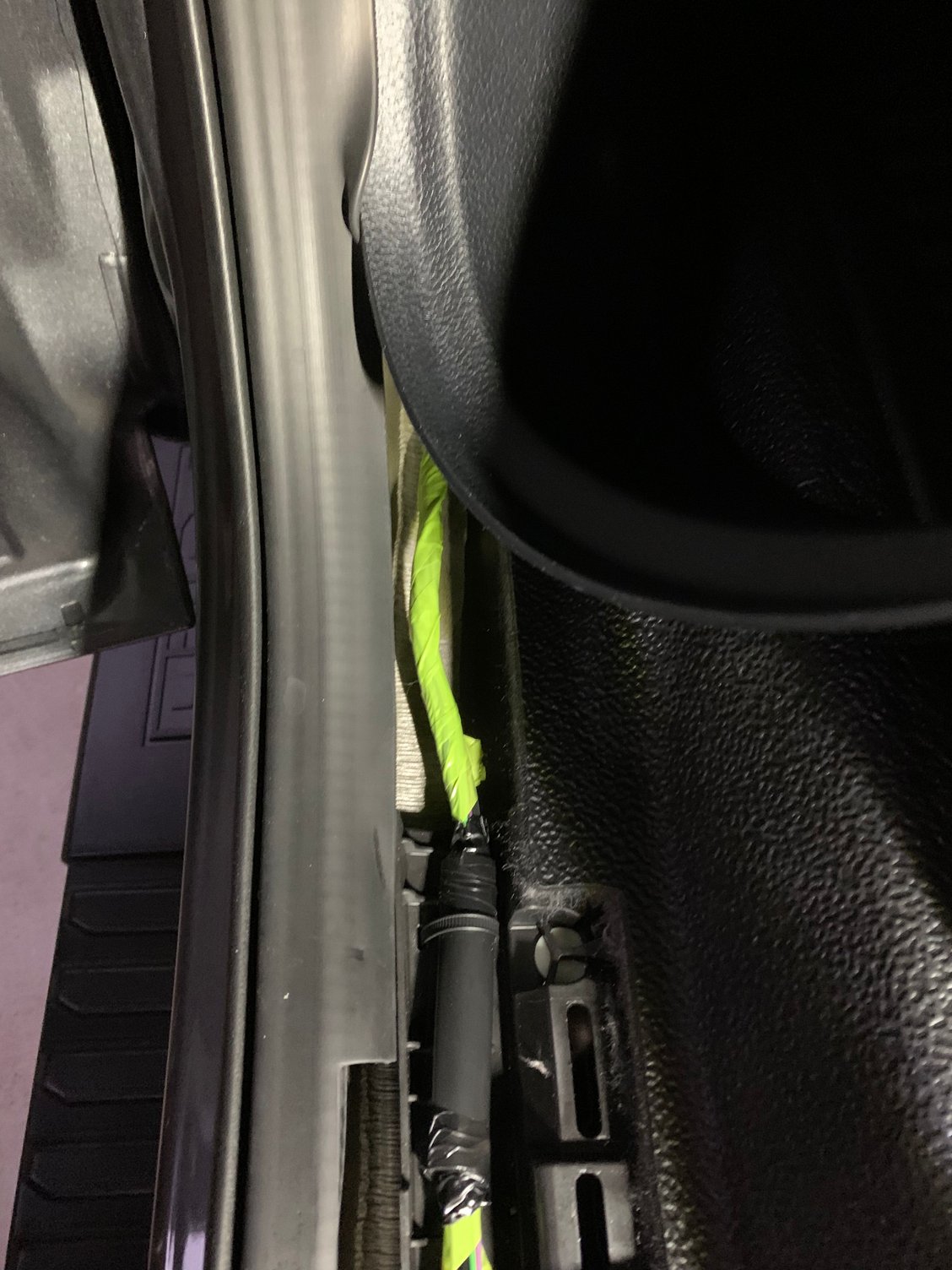

Ok, not all hope is lost. If you pry up the driver and passenger front door seal plastic, there should be a plug that isn't used for anything. I don't have a pic of it, but there are multiple threads here that show it. That is another power source that will work for ya.

Frame rail area

I can’t find a plug in those areas. I guessing that being the XL is the reason. I will try from the video you sent. Thanks for that info. Have a happy New Years!

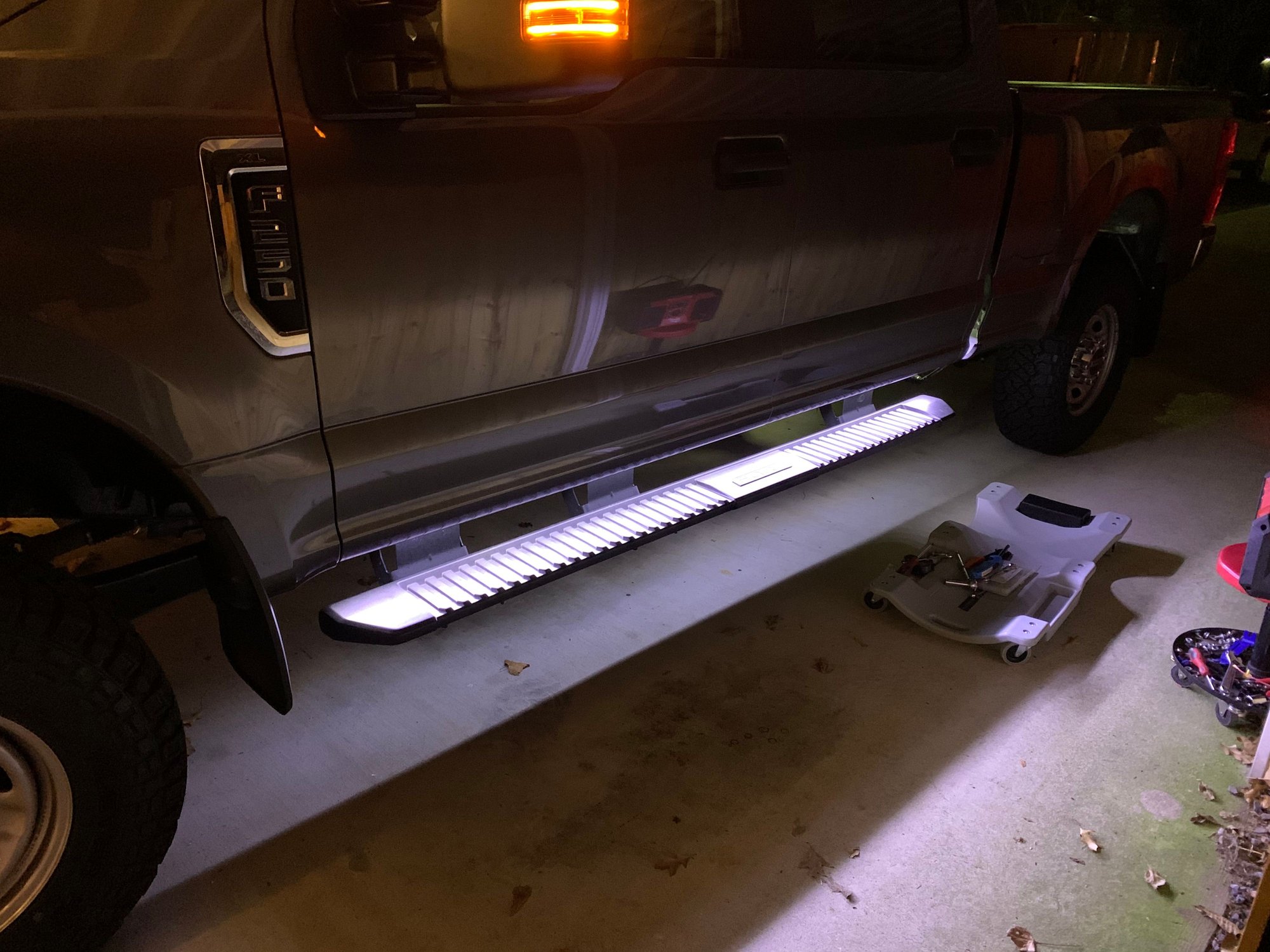

With your help I was able to make it work. Thanks

Looks great! Happy you got it working.

Do they stay on all the time or just when you open the door?
nice job, looks good! What did you use for lights ?
