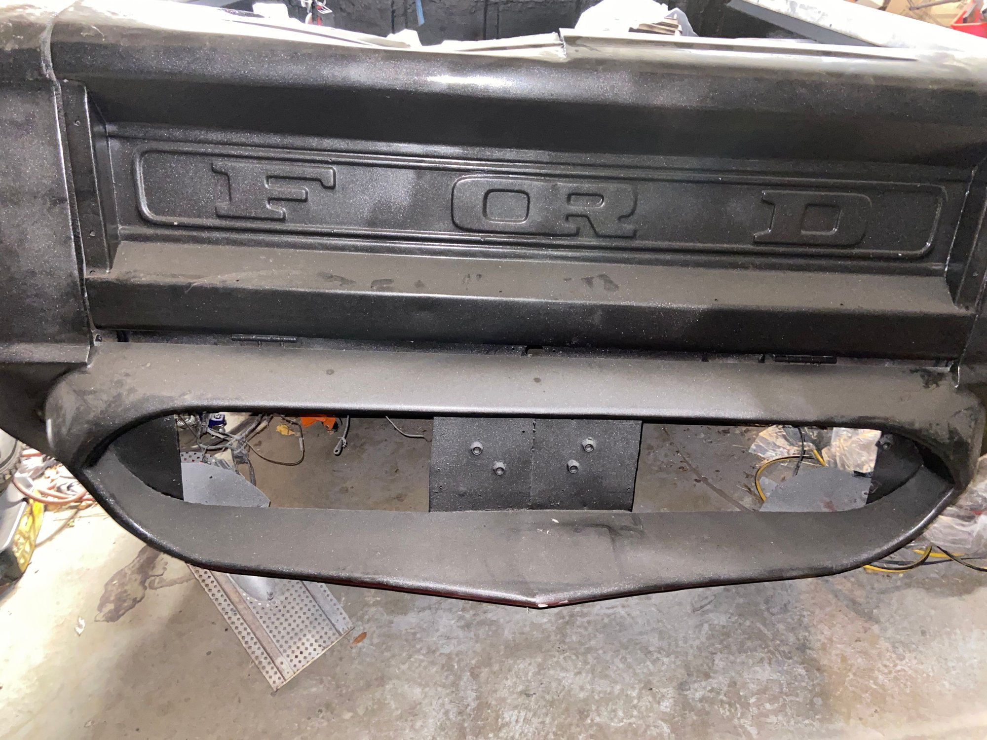

Please provide a pic of the bed in total. Looks like a total clusterF of a custom job and whoever did it narrowed the actual bed tailgate width by extending the sides (after eliminating stock tail-lights) inward. So, if what I just said is true, purchasing any different “stock” tailgate isn’t going to fix your issue because they’re all going to be too wide. You’d be better off undoing the custom work to restore proper tailgate width, depending on how they performed the mod. Or as suggested above, bulldoze the bed and seek a replacement.

Someone sure put a lot of work into that! I do not follow the thinking but do understand labor... More confusing now that I see it!!

Looks like it pivots on a couple of standard house door hinges. That’s quality work right there. Meowza.

New bed. Start over. The cost of the body work is costly and will surpass what a decent bed would cost. Are there any more modifications done to it? It gives me a headache just looking at it, how about pics of the entire truck?

I know I'm a little late, but it looks to be like you have a bumpside tailgate which has been narrowed to fit a wrong bed. Just my thoughts.

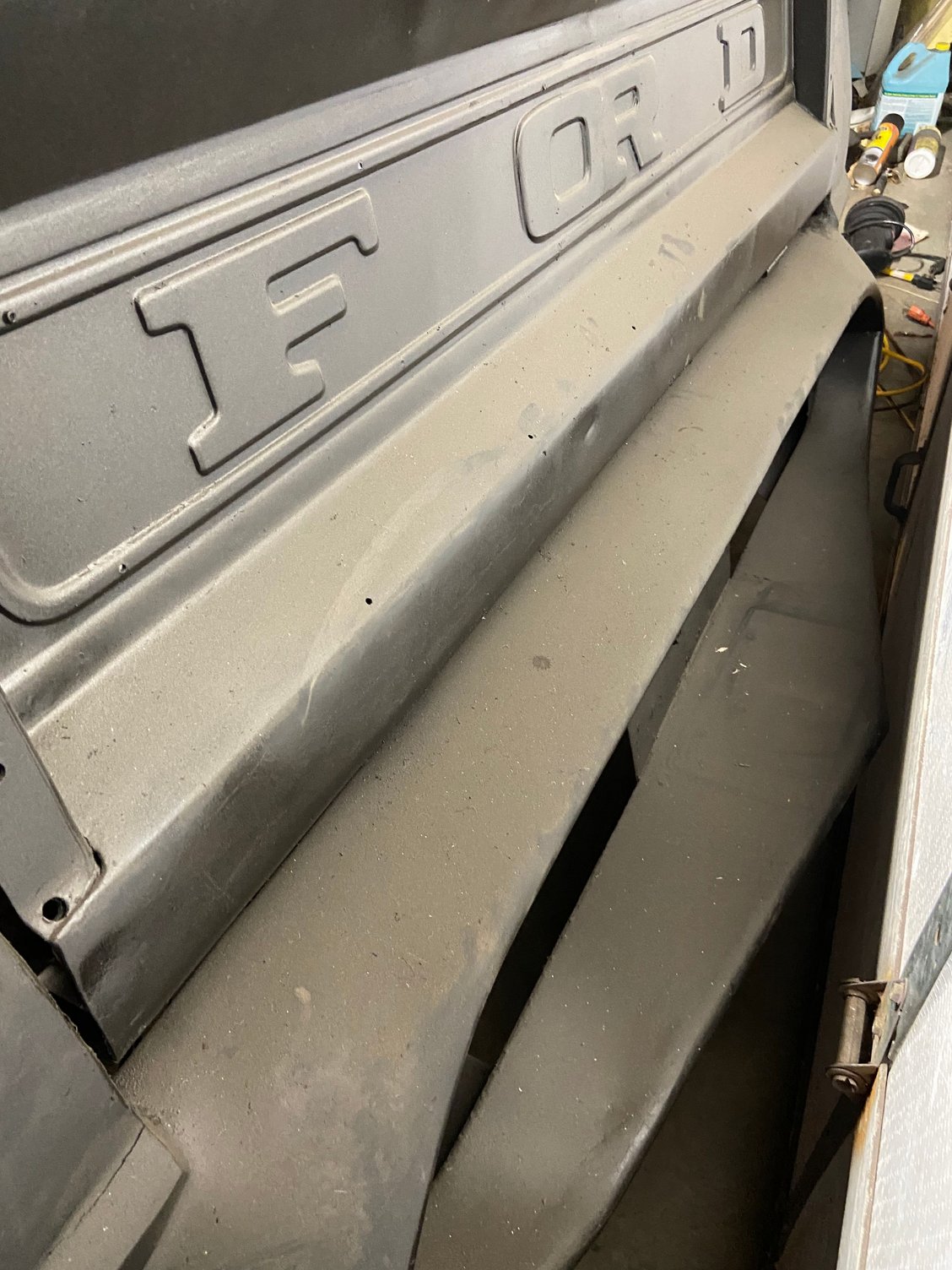

If you were closer to Kansas "I'd give it a go", repairing that gate... Judging by the fact it split along where they welded it together, I suspect it needs to be dissembled to access all of the inside, renforced inside and welded properly or problems would reapear in just a small amount of road use...
