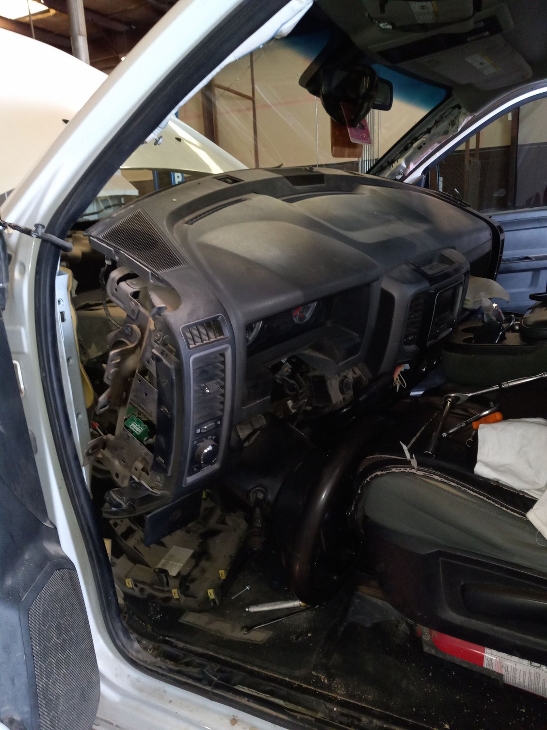

That'd the beauty of these old trucks you can remove it easy and can do it in a jiffy, just the other day had to change out a heater core on our 2016 ram 6.7. The entire dash had to come out as well as the hvac system, surprisingly it's not hard after watching a poop tube video and knowing where the bolts are to remove it.
