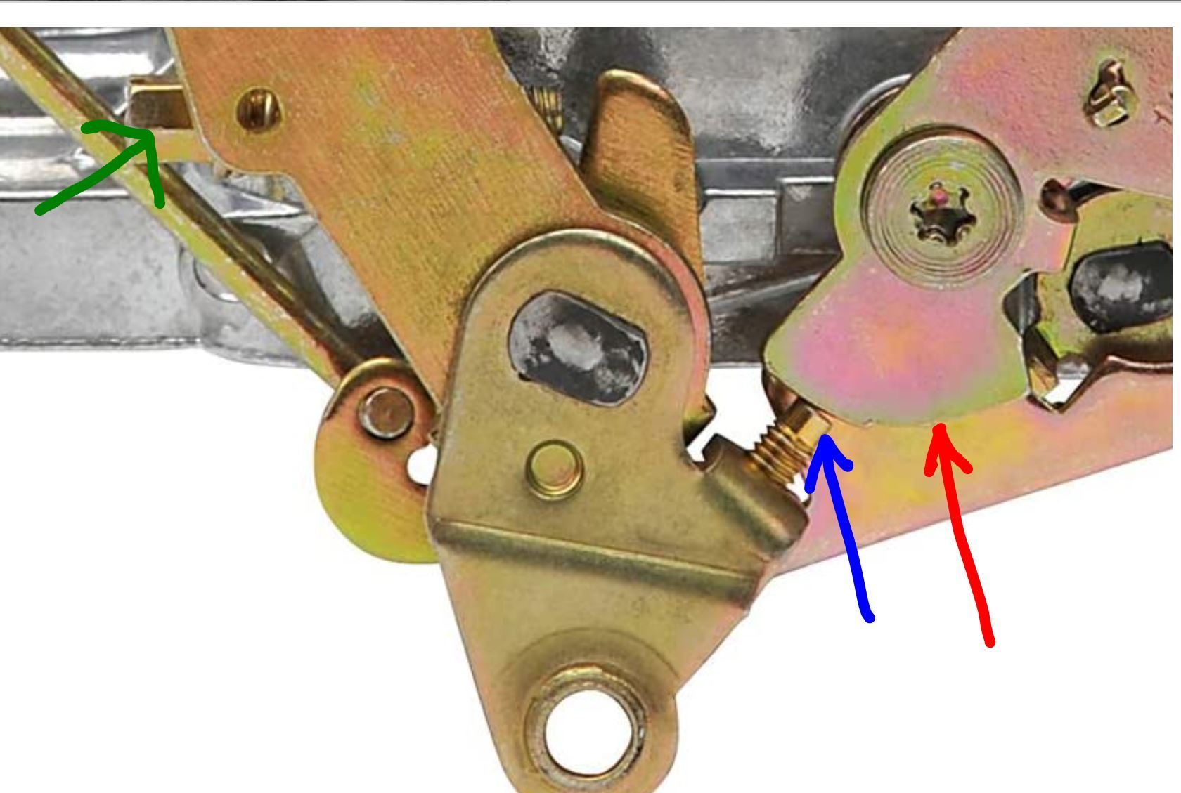

Generally four things on a carb are supposed to control idle speed.
1. Choke valve - which you propped with a screwdriver (make sure you don't bang and scratch stuff in the throttle area)
2. Idle mixture adjust - which you have adjusted to a reasonable start point

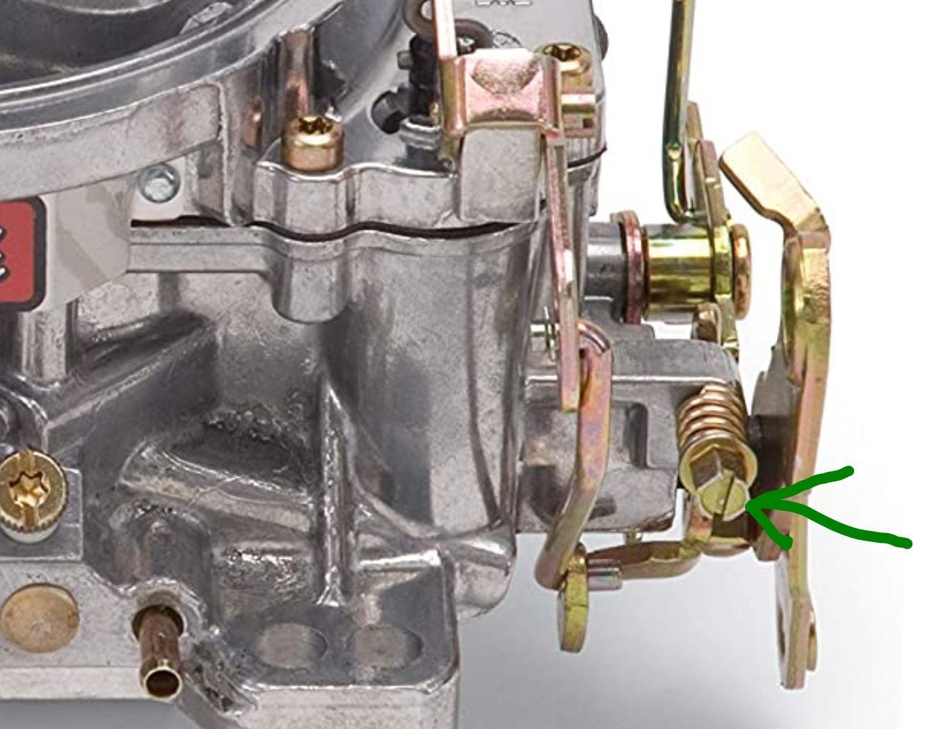

3. Idle Set screw - check this next. See the green arrow in the pics below. Screwing this in and out moves the throttle valves opened and closed - just like stepping on the gas pedal. This screw sets the throttle valve position when you take your foot off the pedal and the spring pulls the throttle closed. Try unscrewing this a bit - your idle should drop
4. Fast idle cam and screw. This works with the choke - the choke will both close the choke valve and rotate the fast idle cam. See the red arrow below. When this cam rotates, it pushes on the screw (blue arrow). This opens the throttle valves - just like the green screw and the gas pedal. It is only supposed to engage when the choke is on. Yours may be engaged due to the choke, or may be engaged because the blue screw is extended too far.
After you figure this out, get your idle down to below 800 or so, and set the timing to where you want it (maybe 10 or 12 BTDC). The 'Advance' would most likely come from the mech advance in the distributor - which is advancing due to the 2000RPM. That's why you need to get below 800 - so the mechanical advance is not working. Changing the timing will likely require you to adjust idle again with the set screw (not the mixture screws)
Then go back and set your idle mixture. Adjust the mixture screws to get the fastest RPM idle. Then adjust the Idle set screw to get to the idle speed back to what you want, then adjust the mixture screws again, and then the idle speed again to get the idle speed you want. That should be close.
You might grab a book or other doc and do some reading on your carb and distributor settings.

I should add that in the photo above - the (red) fast idle cam is engaged - the cam is on the (blue) screw and the throttle is partly open because of it. You want a gap between the cam and the screw

Yes there is a gap at the fast idle screw, it’s not touching, I’m guessing because the choke is being held open.
when I turn the idle set screw, the engine dies shortly after. One thing that I forgot to mention is that I took out the screw driver and adjusted the choke so that it was not needed. I don’t believe anything changed. Choke is also not currently wired up
