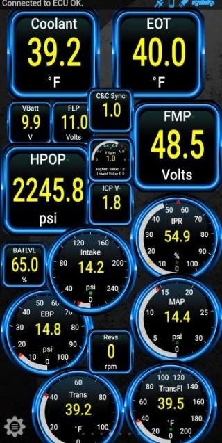

Thanks for tips I added the pids for both syncs,
Dig this cranking test today, all good numbers, except no syncs, 1st test I had revs too,
then as I screenshotted another test I didnt notice I had syncs, but no revs?? wth?
the syncs never came back, I think im looking at ficm or the front connector to it... dang it, not having neiter syncs would eliminate my pigtail on the cam sensor I suppose.

Okay, some new up dates, I plugged the truck intoday to warm it up, even though its not cold out, maybe 50s, the syncs come up with rpms, didnt realize this,
ive been turning up the batt charger to get more power in there, so cranking is up on the rpms
as I went i eventually got a p2285 code, I unplugged and it sounded different cranking, but no start, tried more than a few times.
Can the IPR be bad even though my Press numbers bounce around, its not like they are always in the same spot, like a bogus read.
no oil in the ICP when i look with the connector off.
Id have to think with good press numbers and not crazy IPR numbers im in a good spot, I dont get it,
Ive moved wires around a bit more and looked but i dont see anything out of the ordinary...

This is showing no sync. Needs sync to start.
The next step is to verify you have a fueling command (injector pulse width). It is issued by the FICM when both syncs are achieved and you have proper "starting" conditions.
From the data shown in your link above, you have proper ICP pressure, proper system voltage, proper cranking speed, and both syncs. Lets see if the FICM recognizes all that!
