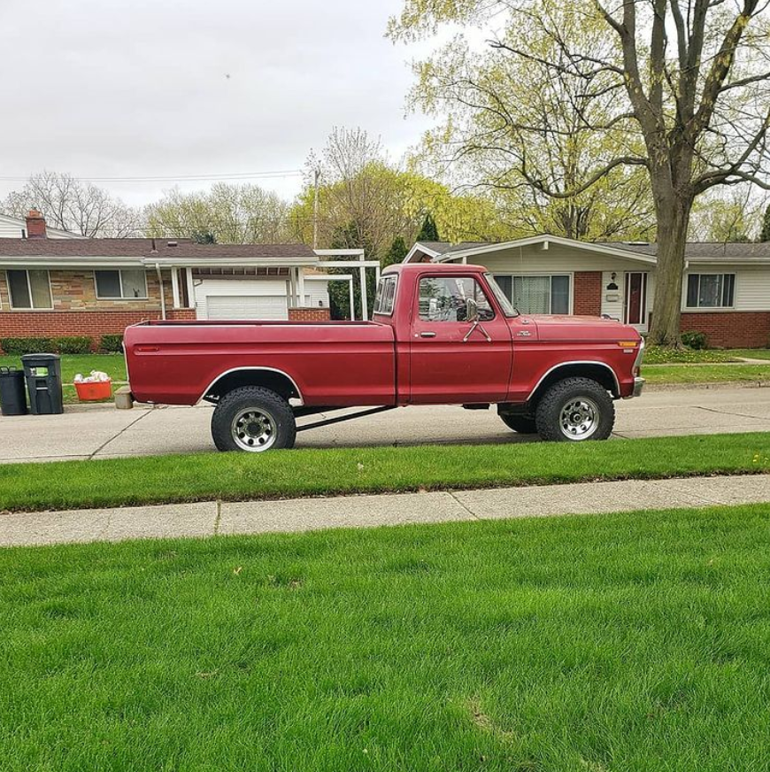

After I got some new wheels and tires on it. Mickey Classic III's (16") wrapped with Mickey Thompson Baja ATZ (approx 33's). I highly recommend these tires by the way!

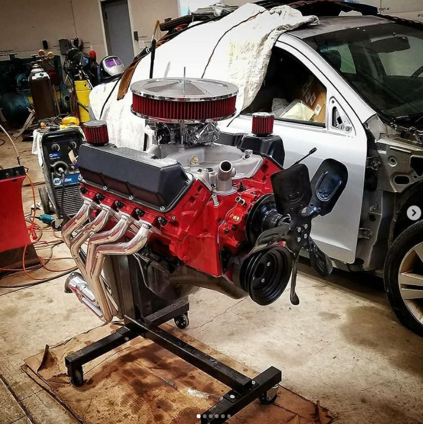

I traded some work with my professor and he let me bring my truck into his barn, pull the engine and, rebuild it. Luckily my school had an engine machine shop so I was able to prep the block completely.
400ci bored .030" over
squared deck
Align honed mains
cone and honed the rods
Everything was new except crank, rods and, block which were reconditioned.
I used Tim Meyer's pistons (9.3:1), bigger RV Cam (cant recall specs now), ported and polished heads, dual plane intake, 4 barrel 650cfm holley carb

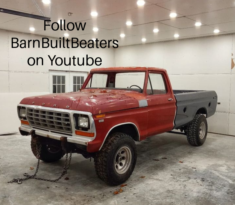

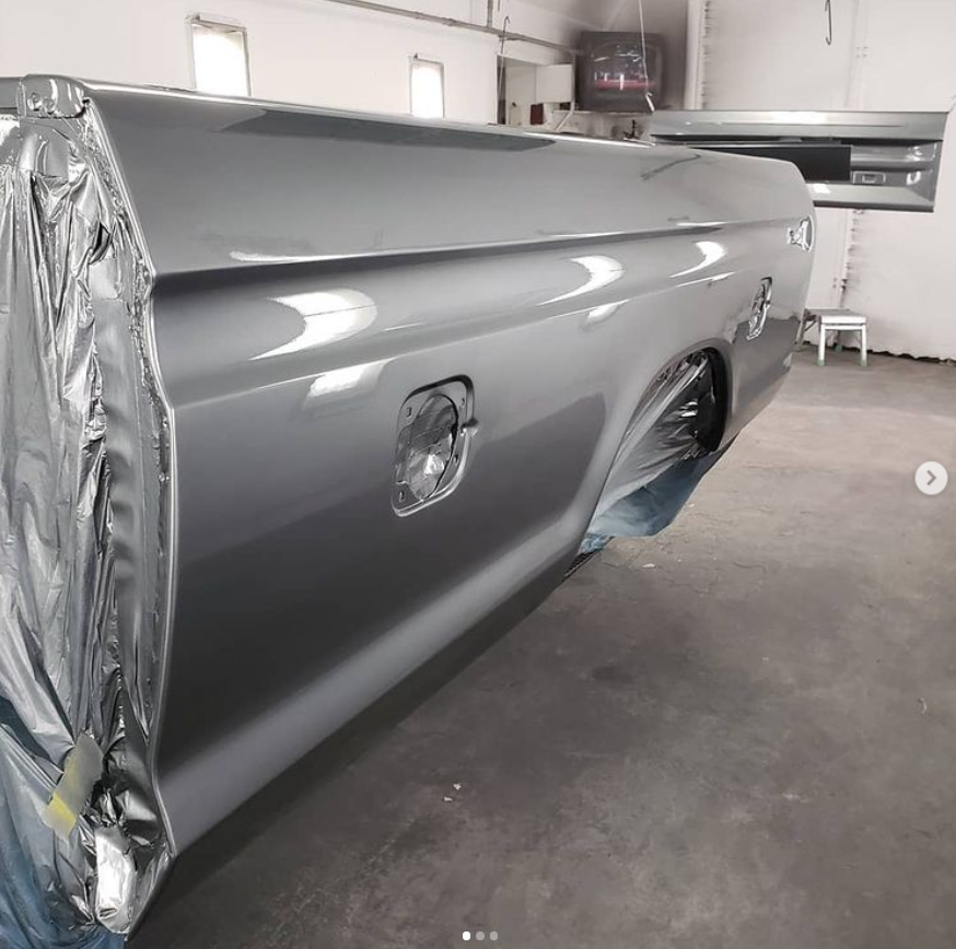

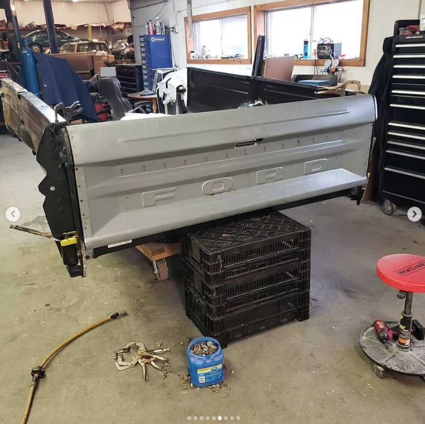

About three years ago, I ordered all new replacement panels and I built a brand new box for my truck with the help of my best friend. Luckily I happened to make friends with this kid in college. Happened to sit next to each other and we had the exact same schedule so naturally we became really good friends. His family owns a bodyshop which he had been working there since very little and eventually became one of the shop's lead painters.
FYI, I probably would not go this route again. The panels fit together terribly and required a lot of rework. Could not have done it without my buddy.
Here is the paint pre-mixed. Any guesses on colors?
"Boring" grey, Selenite Grey (Mercedes). Pretty crazy how many colors go into a grey!
I remember having to pick out a color. I knew I wanted grey but not sure what exactly. I looked at a newer F350 but the shade was a bit too dark, however the flake was near perfect. I then looked at a Grand Cherokee, shade was perfect but the flake was way too big. My buddy hands me a "50 shades of grey" book, a book filled with every shade of grey you can ever imagine. I was overwhelmed. How would I know a 1"x1" square of color would look good on my massive truck. We happened to walk behind the shop where there happened to be a larger Mercedes (ML?) in Selenite Grey. This was nearly perfect in both shade and flake. That is exactly how I ended up with this color.
Note: Any project going forward I will end up picking a manufacturer's color. You are bound to get rock chips and this would make touching them up much easier due to being able to easily buy a paint pen.

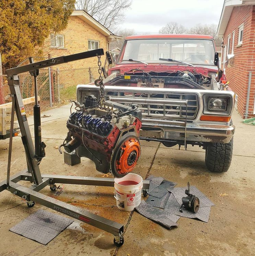

I ended up pulling my 400. I had a starter issue and eventually had to pull it. I ended up selling this engine as I received a generous offer that I couldn't pass up.

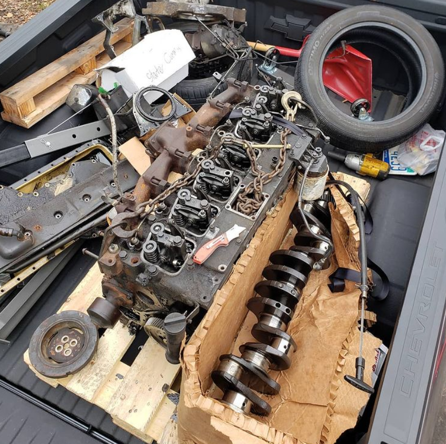

Here is the new engine. A 12V Cummins. I got a good deal from my friend and picked this up. I had always wanted to do a diesel swap. Naturally I wanted to keep it a "Ford Product" but when a good deal presents itself, you snag it.
Here are a few parts I have for it. a Hamilton Stage 3 Street head and a S475 Borg. I am still accumulating parts but boy if I had known how expensive diesel parts were, I probably would have stuck with a gasser. I am commited now though!

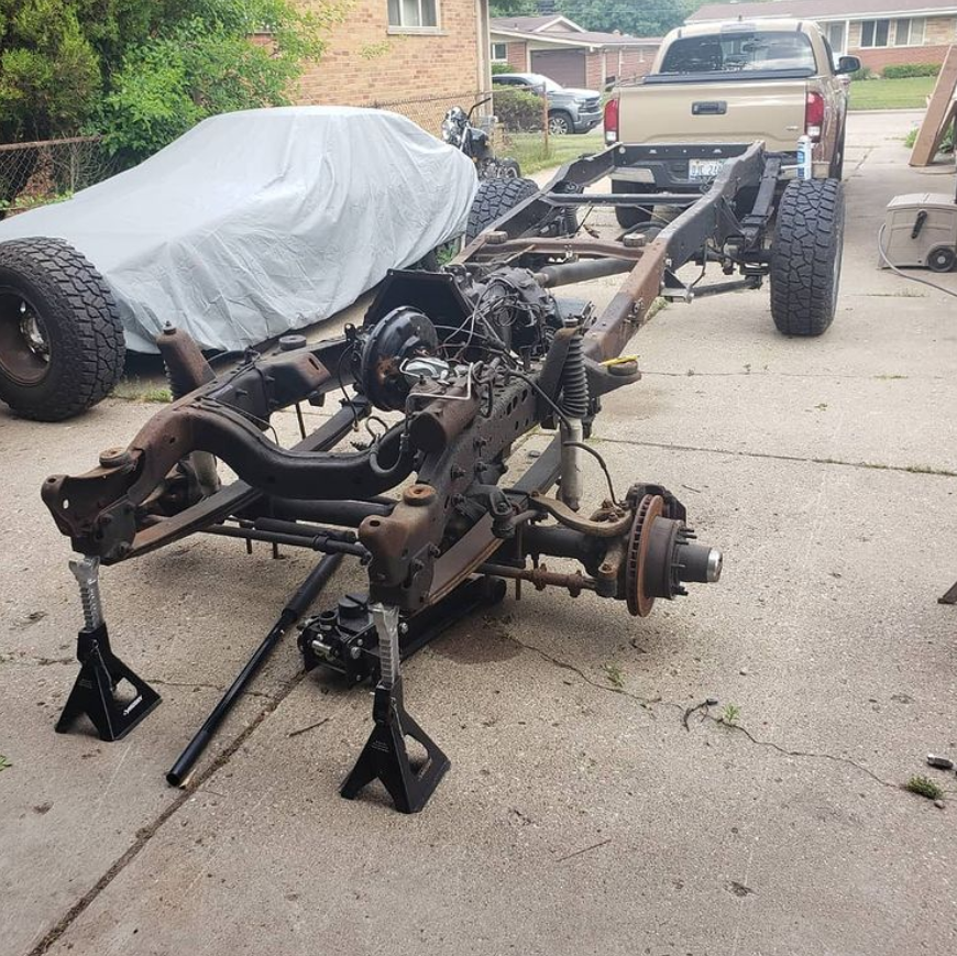

I have read about frame issues and grenading axles so I got incredibly lucky with this find. a 2018 Ram 2500 Chassis. Here me out.
Stronger Boxed Frame
Stronger Axles
Modern Suspension (4 coils so should ride better)
Came with hydroboost brake master
Bolt Pattern is the Same
4 disc brakes (may have to up my wheel size though)
Wheel spacing bother front to back and left to right is very close to our trucks.
Obviously I will have to cut some out and make body mount for it to fit my body as it is a Megacab, long bed truck.
