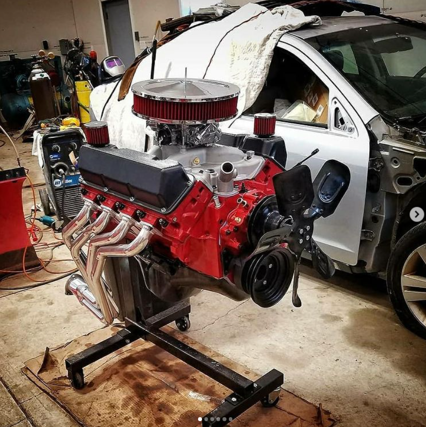

I traded work with my professor in college and he let me park tear my engine out and apart to rebuilt it. Funny thing is, he actually had nearly the identical truck! Our school had an engine machine shop so everything was gone through. Unfortunately since I was not in this class I was unable to do this myself but watched along as it was done. I honed the cylinders out .030" over, used Tim meyer's pistons (approx 9.3:1 i believe), a bigger cam (cant remember specs now), Dual Plane, 4 barrel Holley Carb, port and polished heads. The only thing I reused was the block, crank, rods, and oil pan. I think both performance and appearance wise it turned out well.

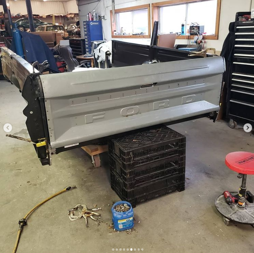

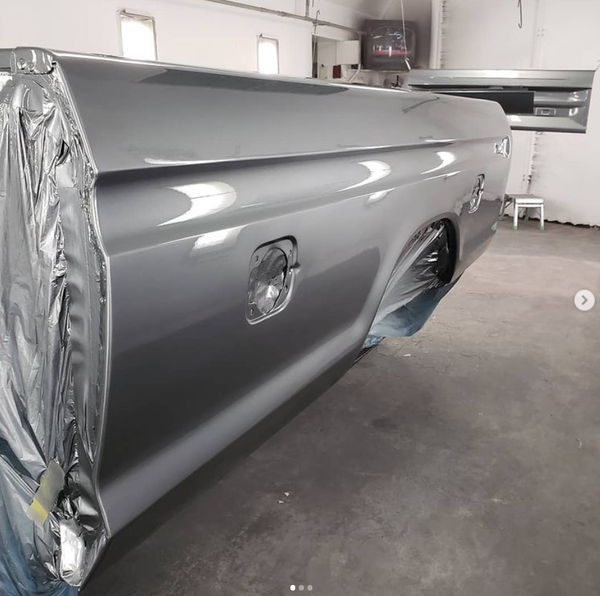

Another big project. The bed on my truck could probably have been saved but I figured the time and the energy spent doing so was not worth while. I ended up buying every replacement panel LMC makes and I build I brand new bed. Would I do it again? probably not. The panels fit together terribly and took a lot of rework. In the end it turned out absolutely amazing. I couldn't have done this if it wasn't for my best bud. He has worked in his family's paint shop being one of the lead painters since he was little.
A picture of the paint before it was mixed. Any Guesses?
Selenite Grey from Mercedes. I remember picking this color out. I walked around the body shop looking at the grey cars. Ford truck, loved the color but the flake was too big. Jeep Grand Cherokee, flake was perfect but the color was a bit too dark. My buddy then hands me a book FULL of any grey you can imagine. I felt overwhelmed... How would i know if these 1"X1" squares of colors would look good on my truck. Then someone mentioned a Mercedes out back they remembered being Grey. This was PERFECT a beautiful grey with the right sized flake in it. Luckily it was on a larger Merc SUV so I was Confident it would look good on the truck too. My buddy shot it and it turned out amazing. a skill I want to learn just not on something so important to me.

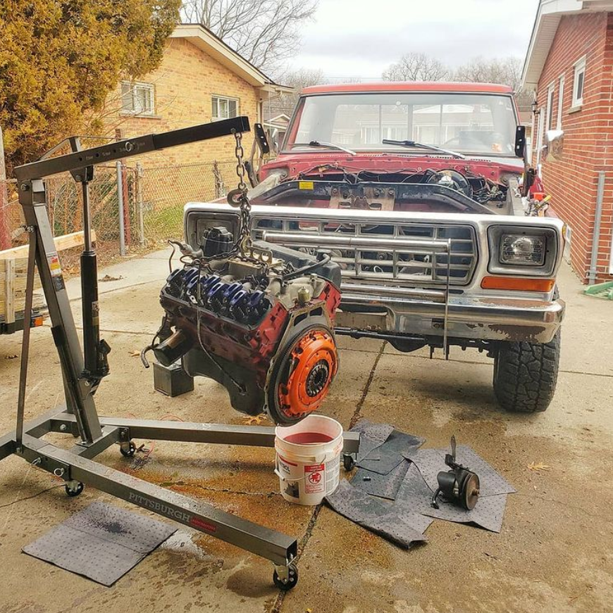

When I got back the first time I drove my truck again, the starter sounded terrible and wouldn't turn the engine over. I troubleshot a lot until eventually it was just time to pull the engine. I had an opportunity to sell this engine and did so as I got a really good offer and had always dreamed of putting a diesel in here (I'll explain further down this post)

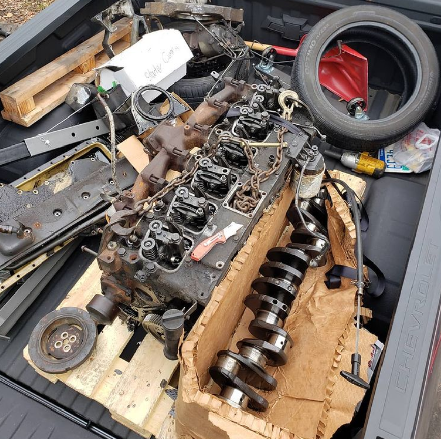

So the Diesel... Originally I wanted to keep it Ford with a Powerstroke but my buddy was selling this 12V cummins and I got a pretty good deal on it. He told me exactly what was wrong with it and well this is for the future! A 12V is pretty cool and im not upset it isn't a "Ford" product.

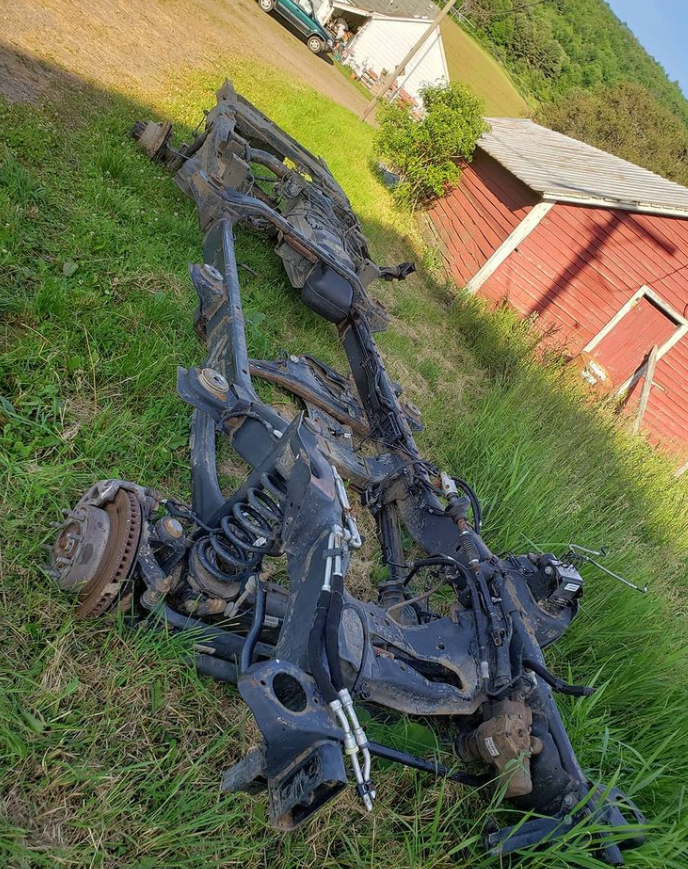

Then the other amazing deal. I am still not sure how I got so lucky. It is a modern frame swap, a 2018 Ram 2500. So a Dodge/Ram chassis/powertrain with a Ford body. I wiill have to cut in half, weld back together, and make body mounts. There are a few reasons I did this.
1. a Boxed Frame
2. Modern Suspension, 4 corner coils
3. Beefy Axles for the torque the Cummins will generate
This is by no means all the work I have done to my truck, just some of the bigger projects and future projects. I have many many many ideas for this truck and honestly I am not sure If I will be able to accomplish them with my knowledge. Some of these include carbon fiber parts that I will be making, a data logging/custom gauge setup, etc. This is trial and error and I am willing to show you all my successes and my failures.

I think your truck will look great in the grey color you chose.
