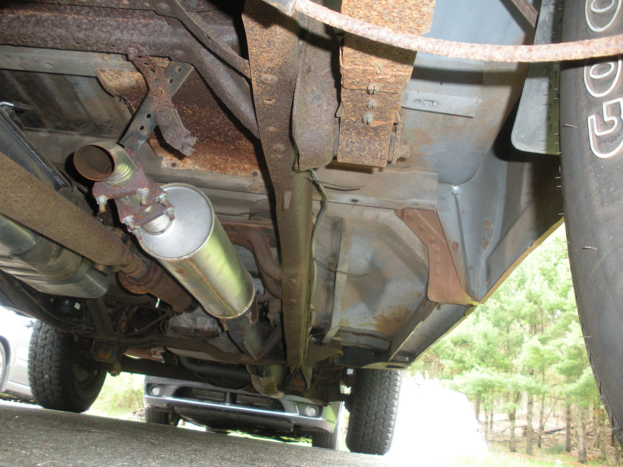

An option is to run only the two cats. Do away with the muffler. Replace it with a piece of pipe and replace the tail pipe. The new cat back system without muffler will not rot as it dries very quickly. It is not at all loud. I've been running mine this way for twenty years.

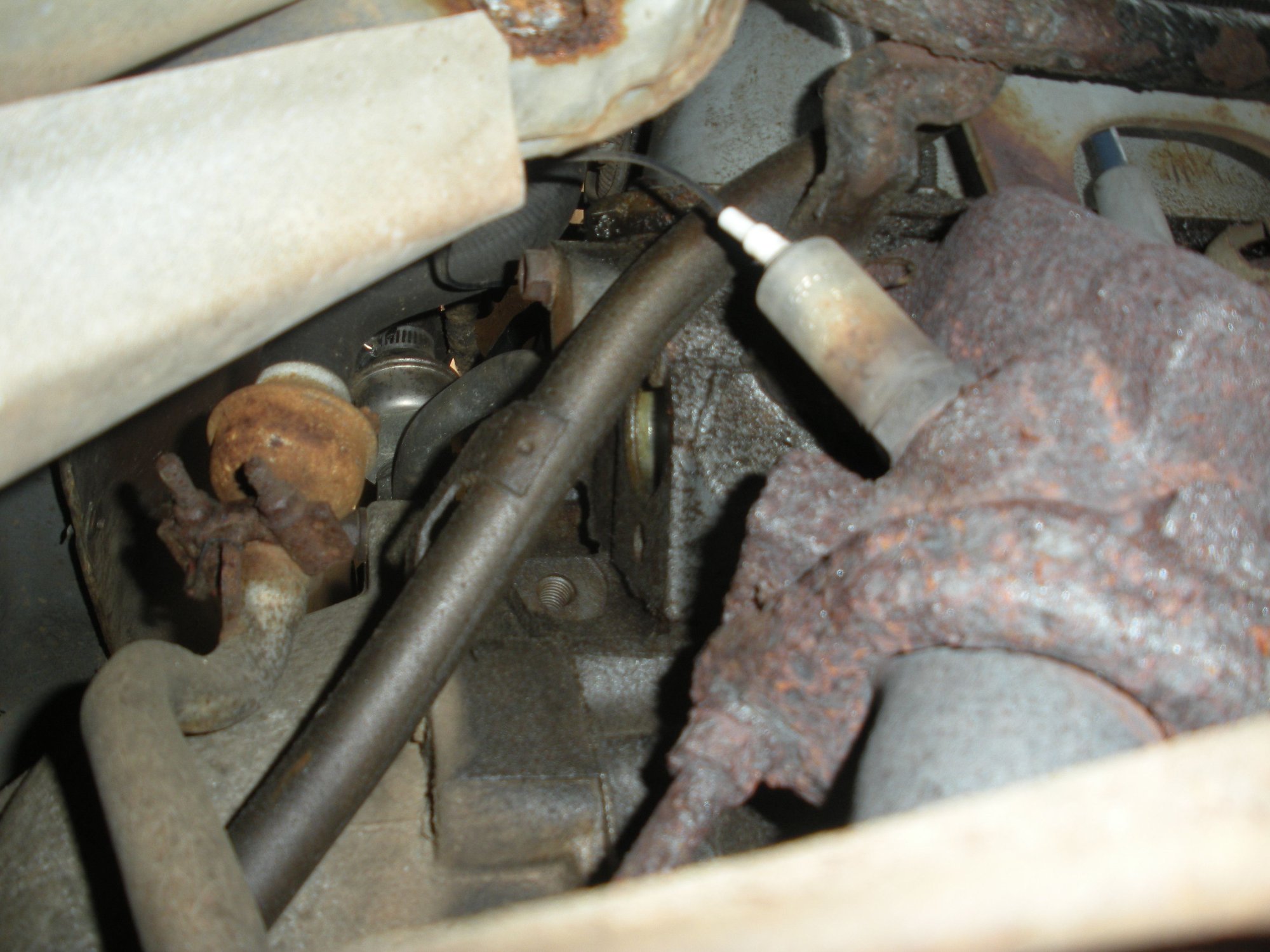

FWIW, here's what I have on my 86' EFI. Cheap, easy to install and replace.

The O2 sensor is located by the back of the right side valve cover. Looking up from below.

While we're doing show and tell, here's mine. That shiniest, offset piece is the muffler replacement. OEM muffler was an in at the top out at the bottom. That piece and the tailpipe are twenty years old.
