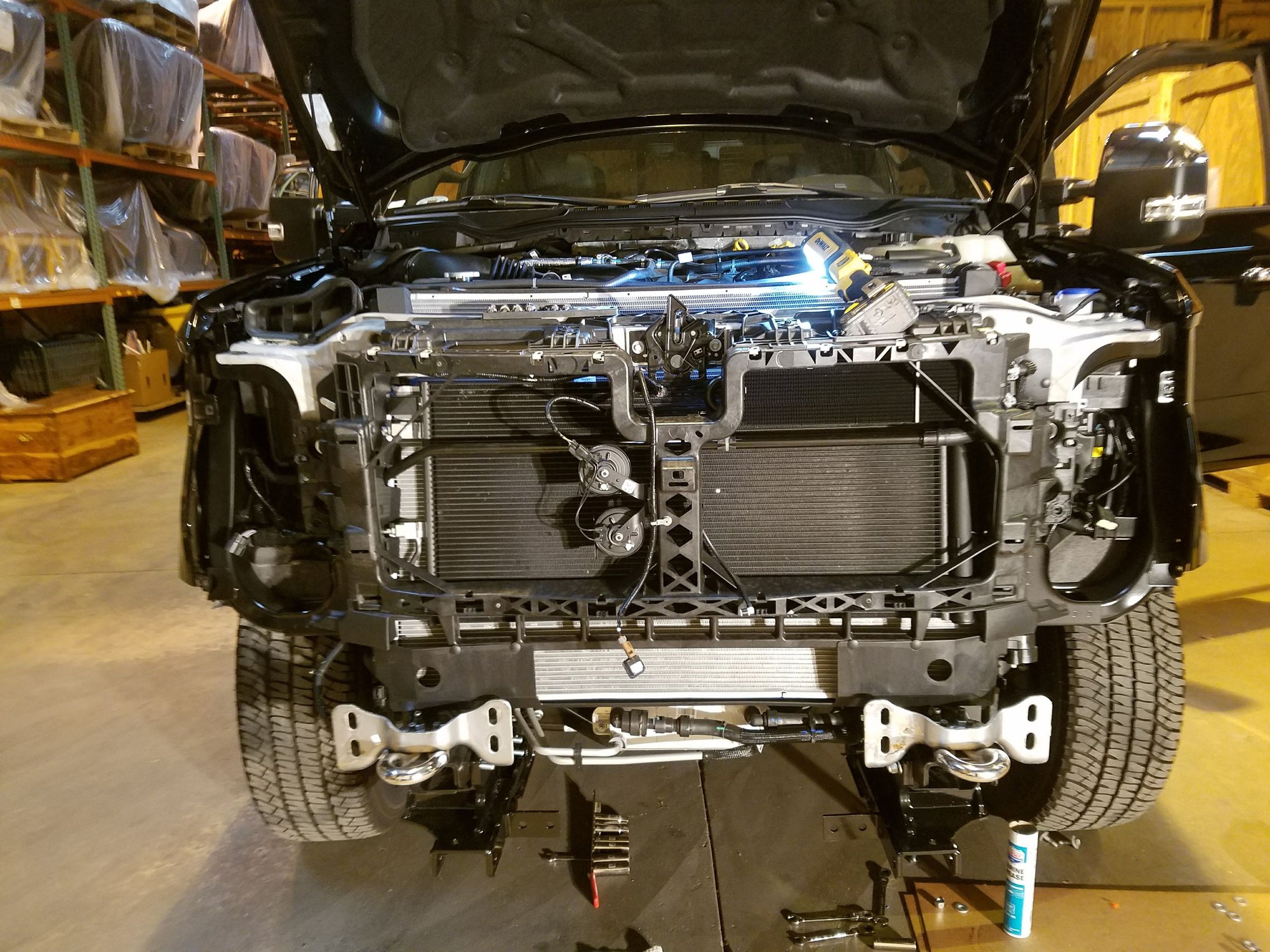

I have a friend getting a plow installed in his 2022 superduty. He's having problems with the adaptive cruse and pre collision system. What tips and tricks are advised to get this all sorted out?

its more that when the plow isn't installed neither system works... it may be a shottie install so far. What I guess I'm looking for, is there any settings to turn them on and off? Will collision avoidance flip out when the plow is on?

I did notice the mounting of the sensor is totally different from my 2019. Where ours are a separate unit the 2022 is part of the molded air scoop. There is a rectangle about the same size as our sensor molded right into it. That won't allow as much flexibility in mounting position.

Another option may be to relocate the adaptive cruise sensor box. There are a few companies that make a bracket to relocate it to the grill area. They are used for aftermarket bumpers that would block the sensors.
Most expensive, but moves it the highest:
https://www.addictivedesertdesigns.c...l-AC18152503NA
Less expensive, but lower location and may still be blocked by plow blade:
https://dv8offroad.com/products/ford...acket-fbff2-br
