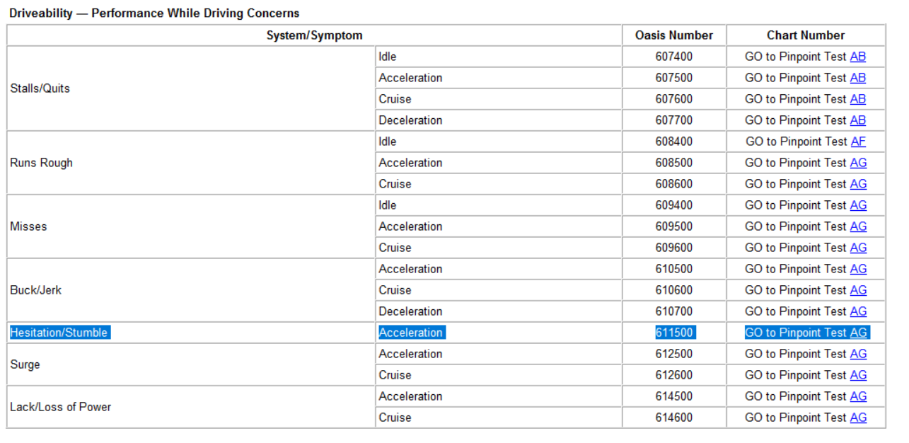

I was looking through the Ford Service Manual for another FTE'rs issue and ran across this.
Pinpoint test AG is attached as a PDF.
Maybe it will help.

What a great set of tests in one document, Sous, thanks for posting. I gotta get brave enough to run some of the WOT tests for sensor checks mentioned in there - probably a more consistent way to check for ICP sensor bias, for instance.
Noted the "Cody Test" is in there, the procedure to check for injector leaks using shop air:
Also that annoying EBPV code we sometimes get, even though the valve is operating correctly - there's a visual check to justify ignoring it. Gotta love it when the manual says to ignore the code and just drive it.

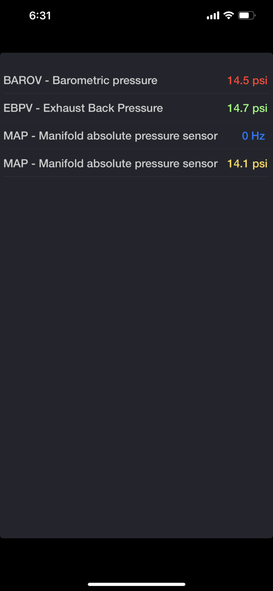

A
This is my reading. Absolutely nothing from the BARO???
Absolutely nothing from the BARO. This was warmed up and idling
what are my
options? It’s a 02. Don’t really wanna buy a brand new one. Is there a place I can send my PCU

What do they read with the key on, but engine off? Also, are there multiple choices in Forescan for BARO? If so, pick the other one. Oh, and change the units from kPa to PSI, so we can recognize the values without having to convert them.
Lastly, where do you live? Specifically, at what altitude?
Mark

ill try to get all the readings on PSI tomorrow. if anyone has free time, im not sure which exact BARO, MAP, and EBPV ones to select in forscan. Also what measurements? voltage and PSI for each?
what all reading do i need just so i can have a list of what t o grab, so my rookieness doesnt drag this thread on.

After driving home I did a KOEO and this is what I got. Perhaps all is working fine
