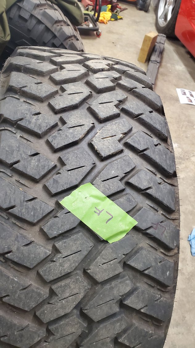

Just rotated my tires for the first time this morning at about 6,700 miles. The rears are wearing pretty even but the fronts were noticeably more worn on the inside of the tire than on the outside.
What would cause this?

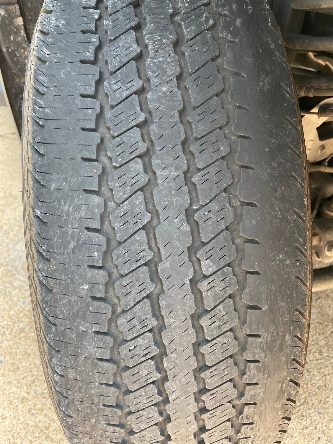

Toe-in checked out fine. My tire guy said he could increase toe a bit, but then the truck may not track as good.
There is apparent no rubbing. Those are OEM tires with no lift.

That really looks like toe out.

Smoking Joe is correct. Wear on the inside of both tires is going to be excessive toe out. Too much negative camber can contribute to uneven wear, but the main culprit by far is going to be the toe setting.
I got 30+ years in automotive, including wheel alignment (both custom alignment and "set it in the green" alignments), so the above is a general but solid guide to go by.

So, SFA tire wear as described and shown is unrelated to cornering exuberance, loading or tire pressures. It is improperly set toe and too many shops are selling customers a line of stuff. IFS could have improper camber as well, but not for the SD. Dealerships have the proper equipment and if you can't trust a local shop I would go to the dealer. My pops would always explain to a customer what was going on with their tires and suspensions. Sometimes we brought them into the alignment bay to show them if it was a problem case. Integrity is getting harder to come by in automotive field. Dealerships included, but at least they start with the correct tools and information. Special alignment for lane departure assist??? Nice.
