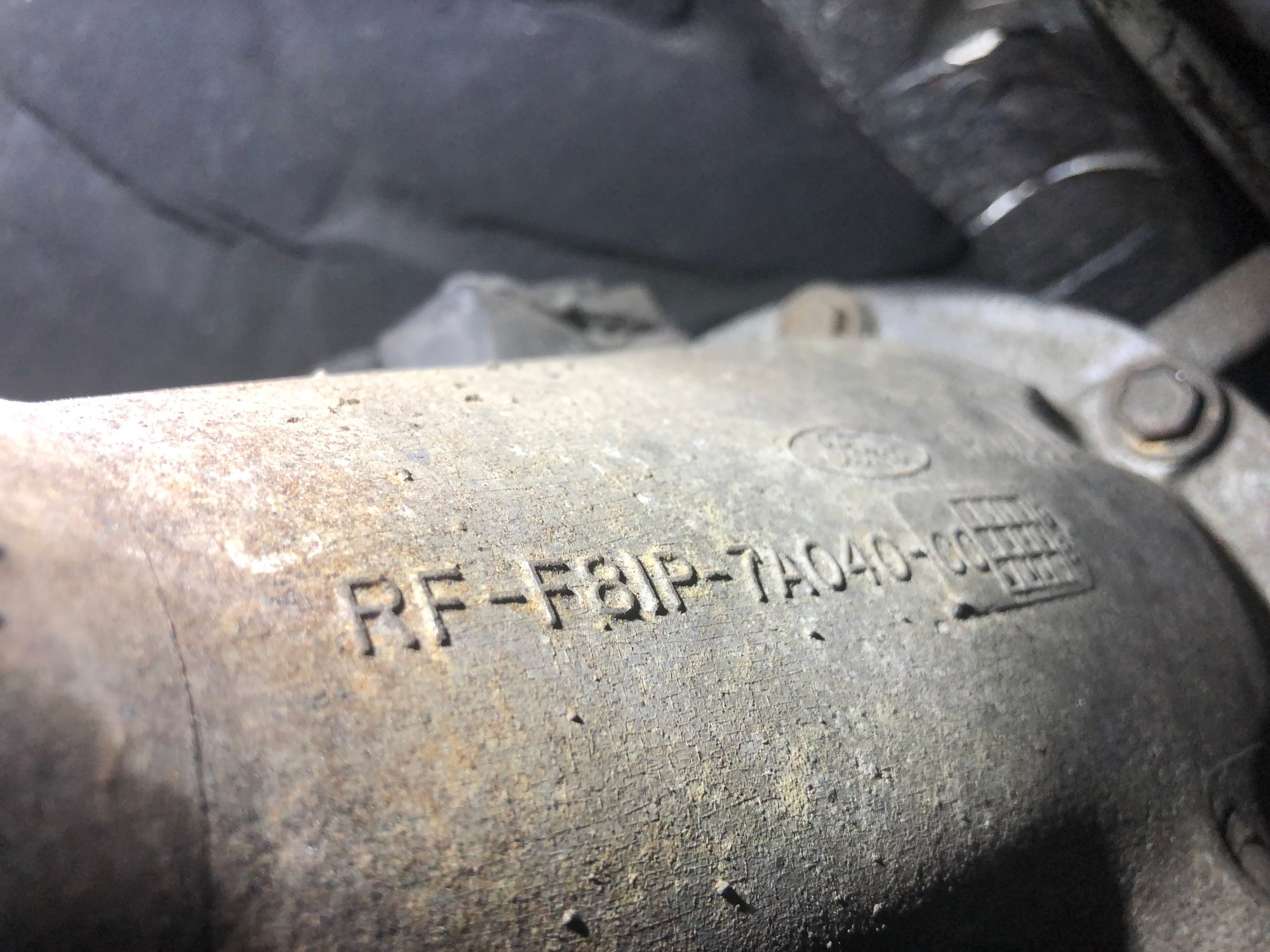

I'm really not that good of a forum guy. I usually only look at them when I have a problem. I had an issue this past weekend that I need help with. I made an attempt to use air shocks on the EX and unfortunately they failed. While trying to get back home, the back end started jumping around like crazy until I brought the speed down to below 40, then started rumbling.When I went to inspect what was going on, I found the tail housing on my 2WD 4R100 was cracked all the way around just behind the seal. Apparently the bouncing was caused by the failure of the air shocks, and then rammed the driveshaft into the tranny. Obviously I'll be replacing the shocks with a much more reliable model, but I'm having trouble matching my tail housing. I see plenty of them for sale that look like the right one but the only exact match I found is three times the cost. I'm sure that there are many castings of the excursion tail housing, but I can't find any references to which castings are usable on my EX. I have a 2000 7.3 2wd Excursion that is stock height, and I like it that way. I'm sure that some of you all have done the 2wd to 4wd swaps since all I seem to see here and on facebook are the jacked up 4wd versions. Maybe someone would be so kind as to point me in the right direction with respect to the tail housing casting numbers. My EX was #142 off of the line and I'd like to keep it on the road. Thanks in advance for your assistance.

By the way, the decoder page on the ATSG does NOT decode the assembly part number, transmission model or the barcode numbers which I would hope contain the actual base part number that I could use to replace my tail housing.

  • Brand
    Ford
  • Manufacturer Part Number
    RFF81P7A040CC
https://www.ebay.com/itm/16477478700...EAAOSwRNJgWJVe
Perhaps someone has a parts xref tool that can help with this.

You can see what I mean, I can find them all day long cheaper but the casting number holds me back. I'm very budget conscious, and if I buy one that "appears to be " the same and get it shipped, and it isn't compatable, I've just wasted the money that I was trying to save in the first place. My way of thinking is that Ford (and all the other manufacturers) purposely put in these roadblocks to make you dependent on a dealership for service functions. It just ain't right. God forbid that a shade tree mechanic try to replace a simple part. WE CAN"T HAVE THAT CAN WE! It's amazing that there are even auto parts stores anymore. Just wait till all the forced "ELECTRIC WONDERS" arrive. I'm sure that when we all have electric vehicles, MOTHER GOVERNMENT will have figured out how to actually supply the electricity to all of them and will have eliminated the traffic jams from our lives. Maybe the fairy dust will regrow my hair as a side effect.

The casting numbers surely changed repeatedly. Contact that vendor, and tell him what you have. See if he is 100% certain it's correct for the year/make/model you have. I wouldn't keep a truck down.

Just for future reference and possibly for entry into the tech folder, I've finally found out the differences between the transmission tail pieces for the 2WD, 4r100, 7.3 diesel, Excursion. There are 4 different configurations of the tail piece looking from the engine side of the tail piece. The one for the excursion has a protrusion up from the bottom that has a hole in it. Also the bushing and seal have 2 configurations, Small dia. and large dia. The one for the excursion is the one that has the larger of the 2 bushings and seals. The castings were made with multiple numbers but if you get the 10 1/2" long version configured as noted above, that should work for the 2WD excursion. In addition, the transmission slip yoke for the one piece 2WD driveshaft (the one with a dampener originally around the outside of the shaft) Ford # F81Z4841EA, has only 2 versions. Both versions are Spicer parts and both are only available special ordered through a Ford OEM distributor new as they are considered proprietary to Ford. All the parts sites and dealers I called gave me the discontinued line. I had to beg the dealer I finally got it through to special order it directly from Dana Aftermarket using the Spicer numbers. The original equipment number is nickel plated, Spicer # 3-3-6001X, and the replacement non plated version Spicer number is 3-3-6661X. At the time of this post, Dana aftermarket only has 24 of the former left in stock. When they are gone, there will not be anymore made and we will be at the mercy of the junk yards and shops that have previously ordered them. The Spicer yoke plug kit is part # 500166-22. Also for reference, the universal joints that originally came with the driveshaft, are an extreme PITA to remove. I had to cut mine out with a cutoff wheel. They had to be original equipment. I guess Spicer gets the credit for mine lasting for 22 years. While looking, I found that the slip yoke was used on the 2000-2004 2WD Excursion and the 1999-2004 RWD F-350 Super Duty (both SRW and DRW). I wouldn't wish this search on my worst enemy as it has been very difficult and time consuming, hence my long winded explanation. If I got something wrong, I apologize, but I did the best I could and tried to document it properly.
