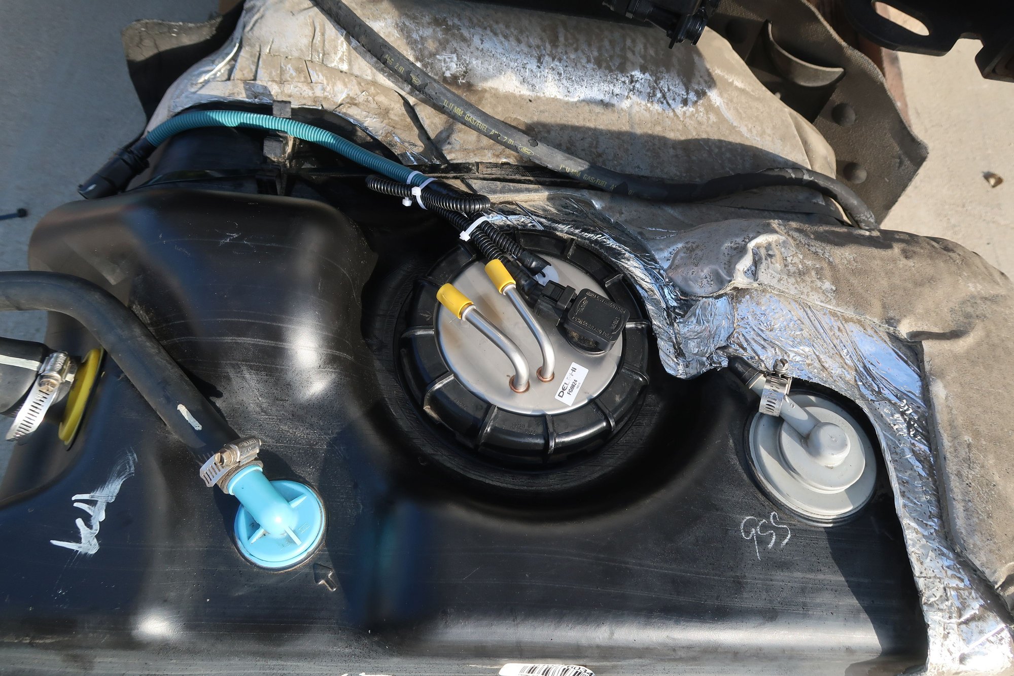

Got a new fuel pump installed and ready to put the tank back in.
Many thanks to Tom's procedure in the Tech Folder, huge help.
Hopefully that is our problem, we'll know in a week after our next trip.
The fuel level sender was not reading properly at the top end so it was probably getting there, too.
Also, what's with the OEM evap hose? The outer casing was flaking off and turned your hand black just grabbing it. It was soft so needed replacing. It is an 11.11mm (7/16") hose. Who uses/carries 7/16" hose? I replaced it with 3 ft of 1/2" fuel rated hose which works fine.
Our Ex is a CA emissions version so there is an additional Fuel Tank Pressure sensor in the plate, only difference I can tell from the 49 state version pump assembly.
Removing the old tank pressure sensor was a pain as I didn't want to break it while twisting it off the lock.
Not sure why, but from the Wiring Diagram it looks like the Fuel Tank Pressure sensor output goes to the rear Heated Oxygen Sensor (HO2S).
I was wondering what code would be set if the Fuel Tank Pressure sensor was bad, but it might be mixed in with the rear O2 sensor codes.

I had the same problem and changed the whole fuel pump and assembly. Mine is a CA version as well. For the tank pressure sensor, I discovered it's easier to remove and replace once the top assembly cover is mounted with the screw collar fastened. Then using a pair of channel locks with a rag over the sensor to give more leverage while pushing down.
