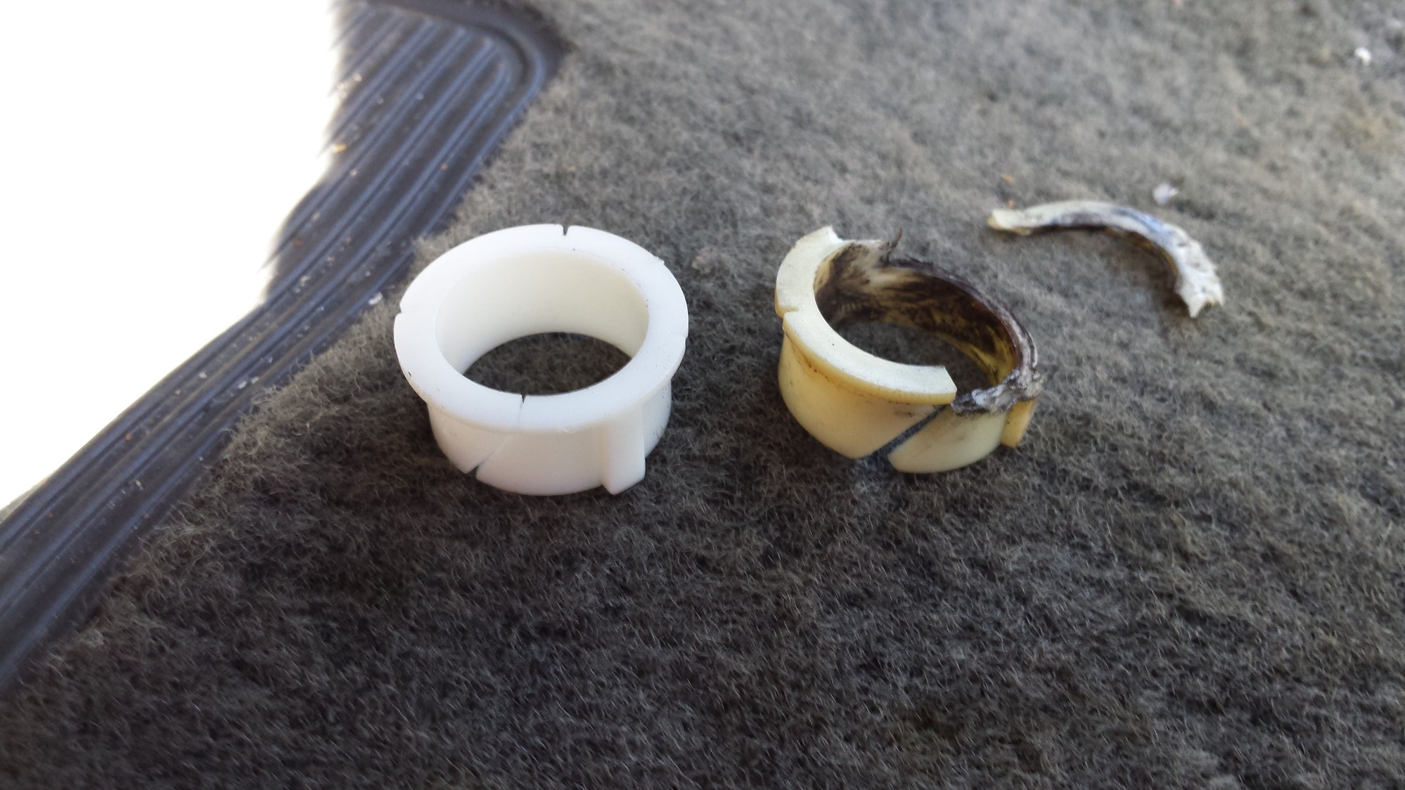

I usually have to go into 4th before Reverse on Mazda tranny and like someone had mentioned before, 5th before reverse on the ZF. Just some of the little quirks that go along with an old ford. Also, someone had mentioned the bushing on the clutch pedal shaft. I'd bet that thing is original and toast by now, it's probably worn the hole into an oval. It will leave you stranded sooner or later because the clutch safety switch won't engage due to the slope in the linkage. Simple fix of bypassing the switch, or replace it. Good luck man, hope this helps.
Here's what the bushing looks like (Sorry for the huge photo)
