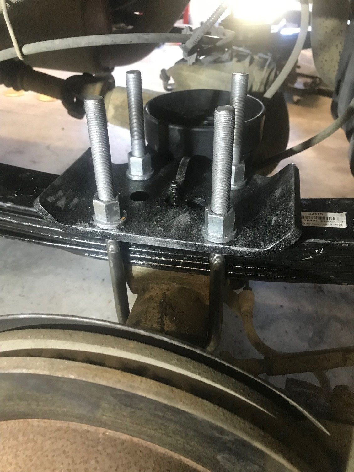

Looks like we got different U-Bolts then. This is what mine from PMF looked like, I needed to cut obviously

I believe my bolts were 8”. Is that the PMF top plate that keeps the bump stop/airbag tang? I am considering those but yours look a bit different.

Likes: 366
Yes, that's the PMF airbag tang top spring plate. The reason it may look different is I have the Daystar airbag cradles bolted to them (but not the airbags ) in the picture.
I figured I'd just keep like 5 psi in the airbags to level the truck if needed instead of using the stock traction bar leaf.
