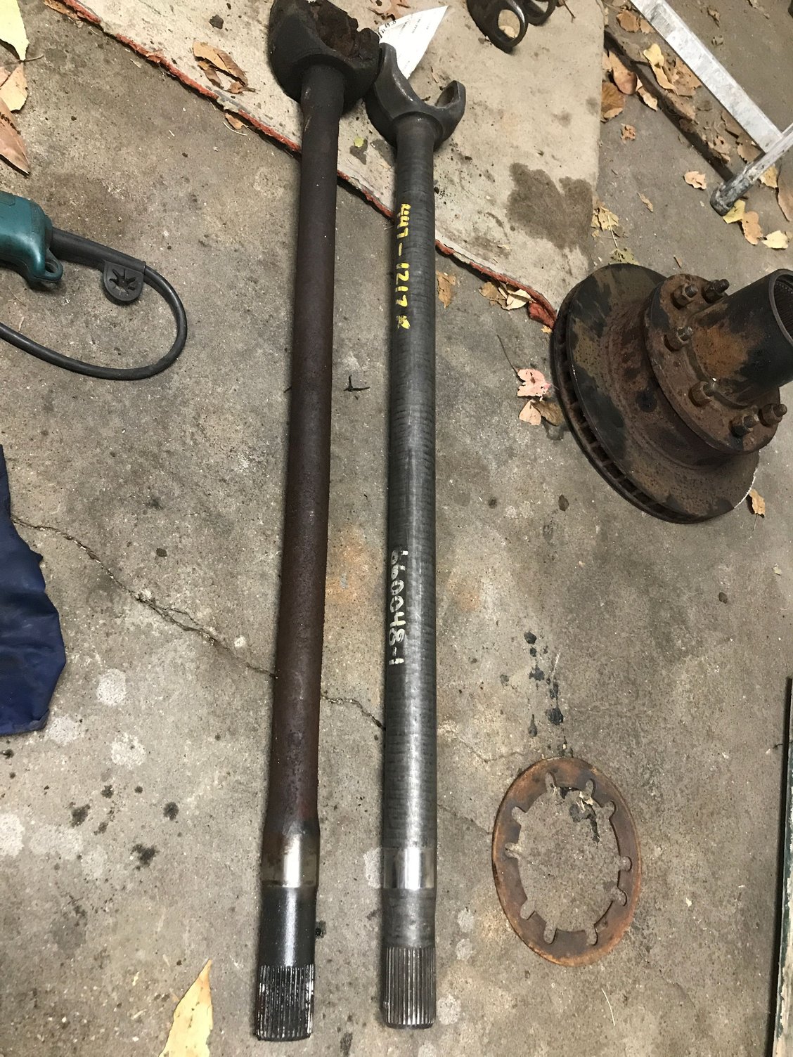

PA inner shaft and spacer plate
Hey guys, I bought the 7deg reamer and am assembling and blasting/cleaning up the pieces while Inland Truck is bearing and sealing the differential. Not going too fancy using the original carrier, some day I’ll put a trak lok in the rear end.
Replacing PA inner shaft because seal surface has heavy pitting. I got sent spicer 660048-1 which appears much thicker shaft, but same length, spline count. Any reason I couldn’t run this? I ordered 660182-10, should I get fussy about this or run it.
The spacer plate was on the passenger side right next to the knuckle. Did you guys have that and should I put it on? What is it for.
This d60 seems to have never been gone through with the exception of the hubs which had a mess of blue marine grease in there.

Old Dec 2, 2021 | 06:01 PM
moose4x4's Avatar
moose4x4
FTE Emeritus
Joined: Jan 2006
Posts: 2,288
Likes: 200
From: springfield Missouri area
That spacer plate is an alignment shim.

The shaft should be fine as long as the dia is the same where the seal rides.

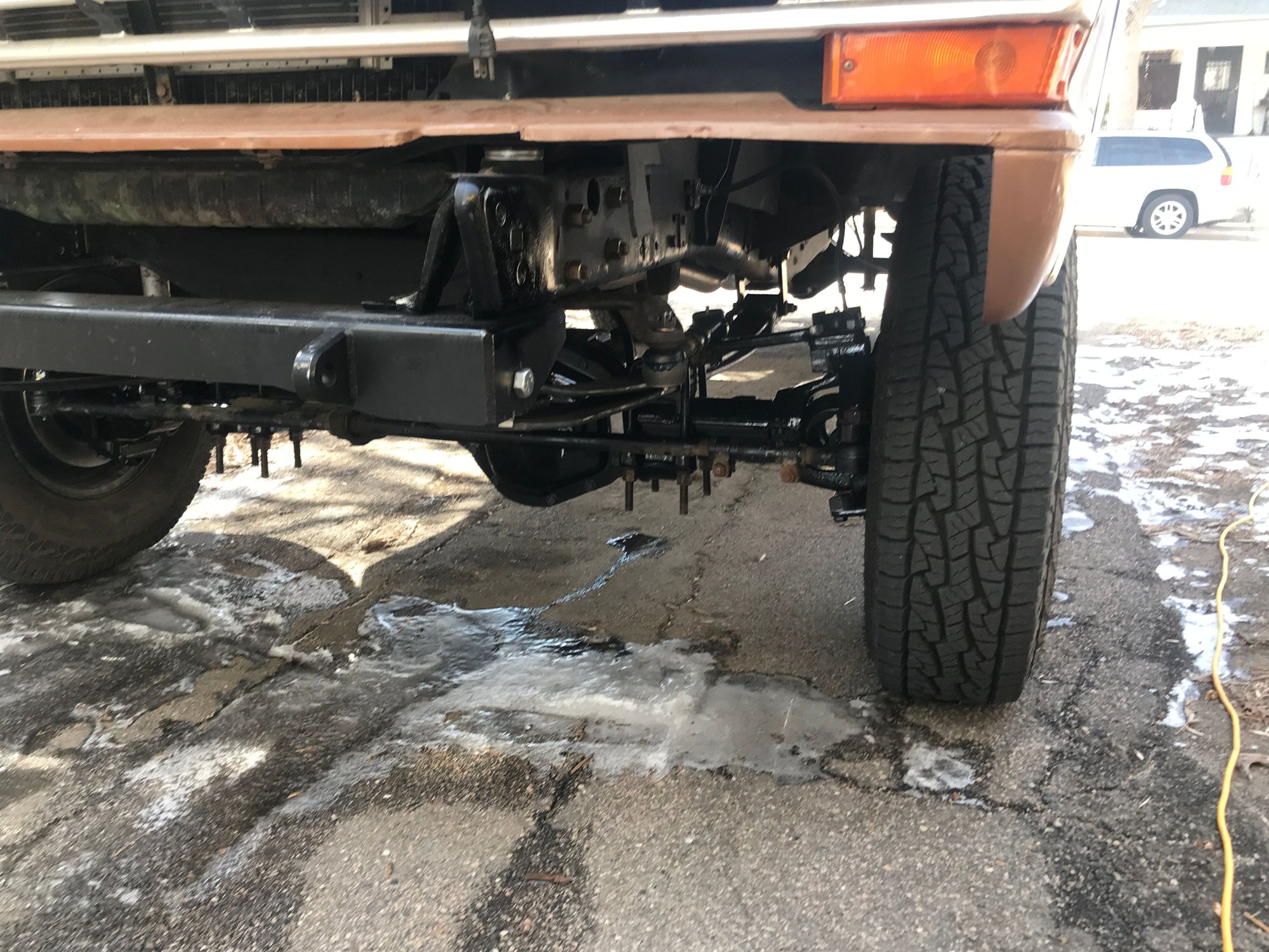

SD springs/bracket and axle are in.
I used the $75 HSS reamer for the steering arm, worked fine on the drill press. Seems slow going, using a socket to support it on the drill press.
Did you guys have trouble reaming the pitman arm for the 1 ton drag link? Didn’t know if it’s a special grade of metal.

Thanks for the suggestions on running the 1ton chevy drag link. Ended up following the recipe reaming d60 arm from the top, pitman arm from bottom, using es362s, es2027L, es2026R. Drag link is nearly parallel.
Tie rod and calipers were a direct swap from the 78-79 dana 44. There seems to be no real good solution to the shocks and towers being a bit out of alignment so will have to work that some.

Looks good! Having the drag link level is very important on these because it's length is so short.
