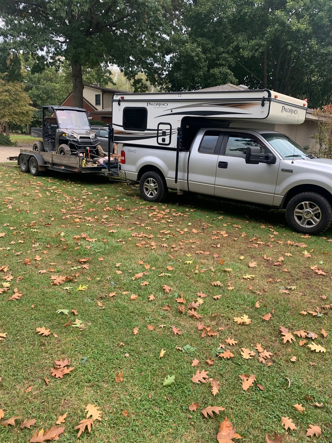

Nothing wrong with the smaller campers. We are having a fun time with ours

yeah I had a bronco 600 made for a import. Just not quite big enough for us. The diesel puts my payload down to 1284 which puts me a bit shy to get into a full size pop up camper especially towing our boat.
was just hoping to get enough to get closer to 1500 or 1600 lbs to be able to get the next size pop-up camper
nobody seems to know what exactly the hdpp parts needed, been kinda frustrating, eventually I will get answers from someone who knows.
