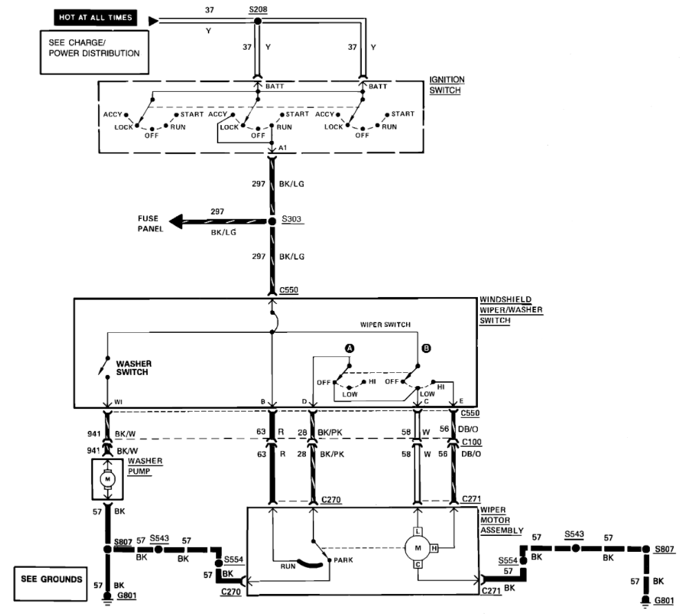

Here are some wiring diagrams for regular and then intermittent wipers on an 89 F150.
Regular
Intermittent
