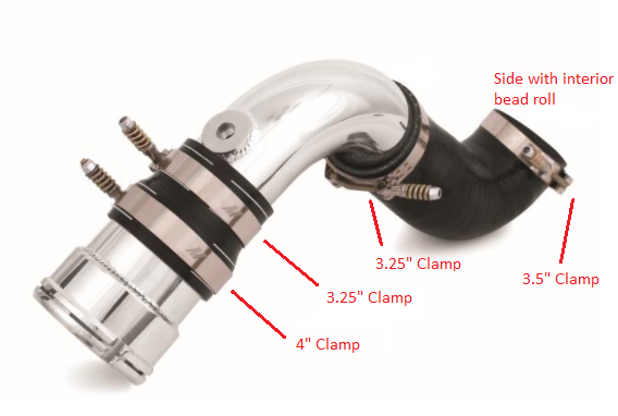

I bought the Misimoto cold side a couple of years ago on a Black Friday sale. It went on nicely, Sence then I have seen other brands that look very nice. Same idea but fewer joints to deal with. These new pipes replace the plastic connection that is prone to fail.

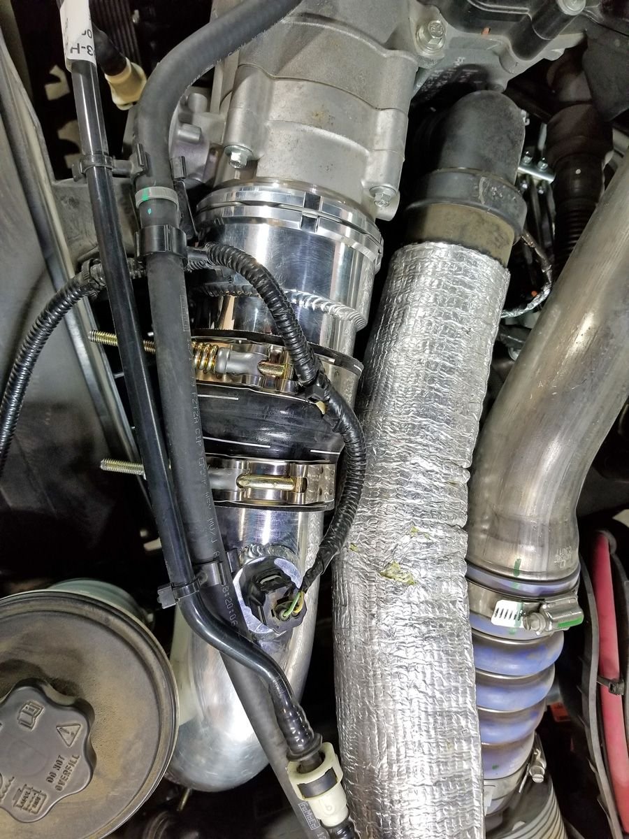

@ymsmiley don't worry about the oil. There's always oil in the system from the crankcase vent. I replaced the factory pipe with an H&S before the factory pipe had a chance to blow.
