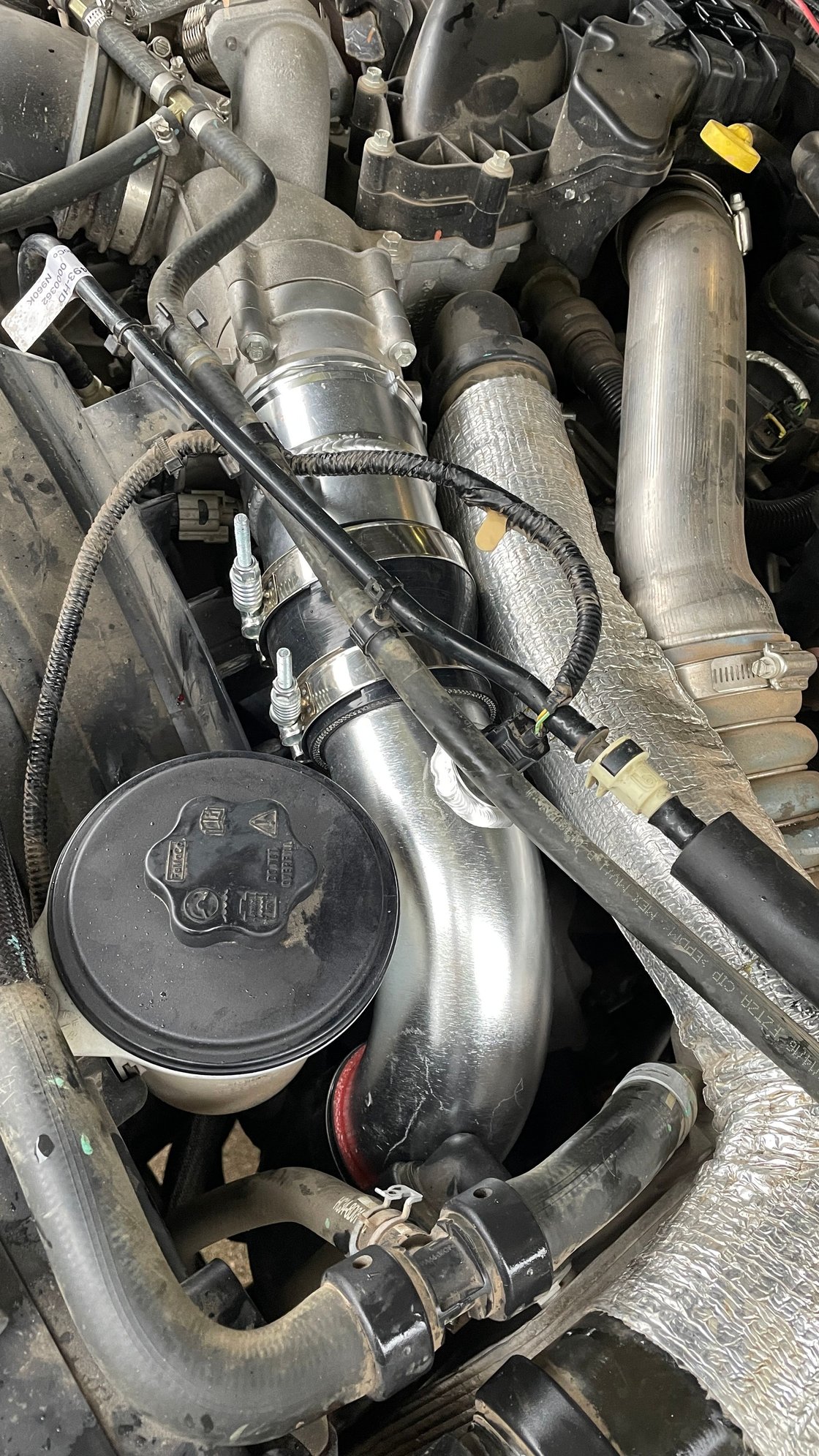

Here are the Amazon links to what I pieced together. For some reason my search results wouldn't return anything that fit 2017+ 6.7s so I just assumed the prior 6.7 would be the same. For $75 it was worth the gamble and I could return it.
2017+ intercooler outlet requires a 2.5in ID fitting. The kit supplies a 3in ID silicone fitting. You need to order a 3in to 2.5in 90 degree reducer fitting and cut about 2in off the 2.5 side to make it fit properly in the space available.
Kit
Amazon Amazon
Silicone 90 degree 3in to 2.5
Amazon Amazon
Here's everything bolted up. I had no idea how badly my truck was down on boost before the replacement. This kit restored boost and really woke the truck back up. 100% stock otherwise.
