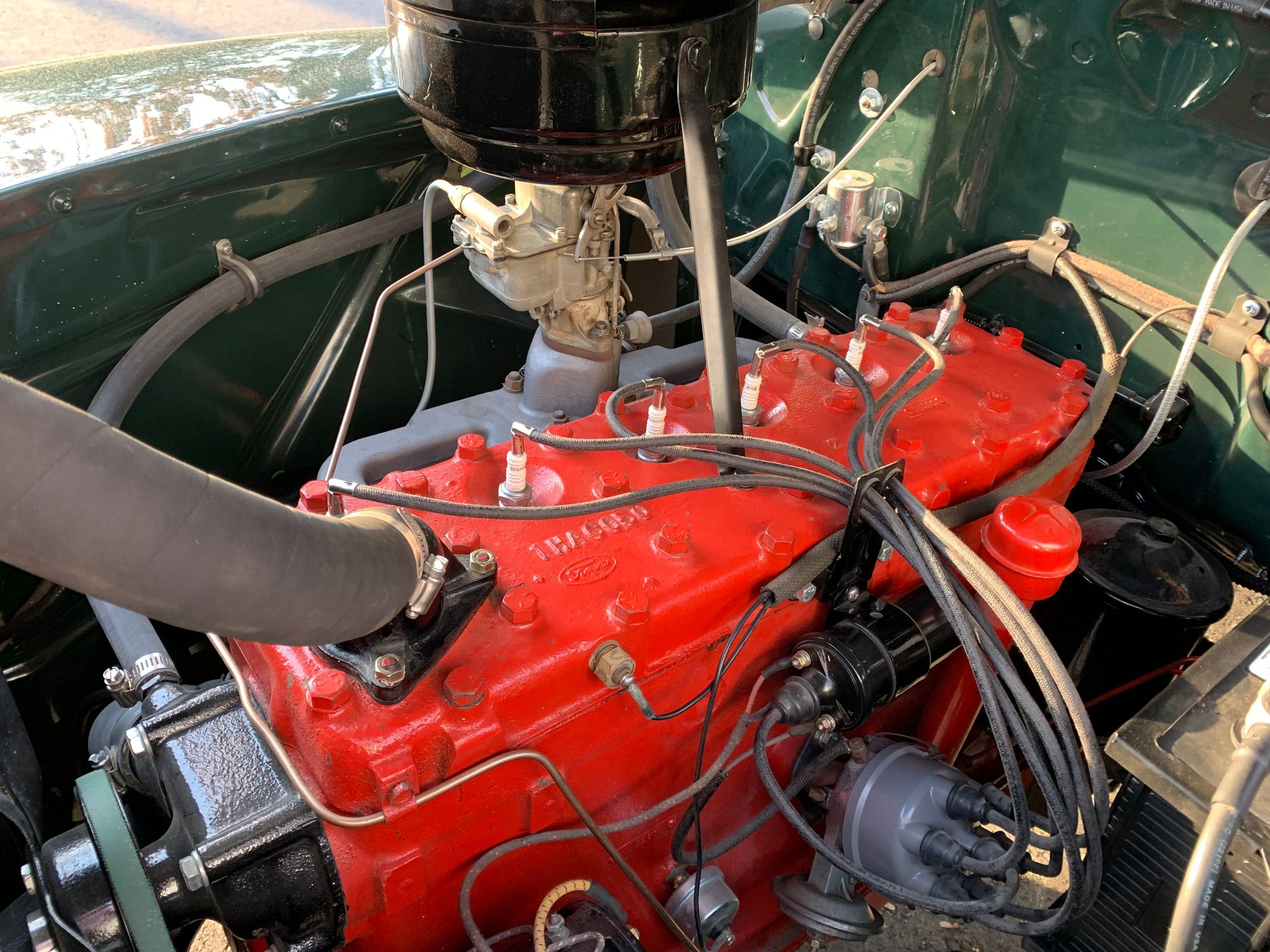

I just bought a 1947 tonner flat bed - fully restored. I tried to drive it from PA to CT this weekend but the vibration above 2000 rpm was so intense that I was worried it would rattle the rebuilt 226H flathead six apart so I had it towed after about 100 miles. It has original 6v system with spark plug wires that are metal clipped to the plugs. The clips seem like maybe there is a possible reason for vibration - cross fires on the cloth covered wires or ?

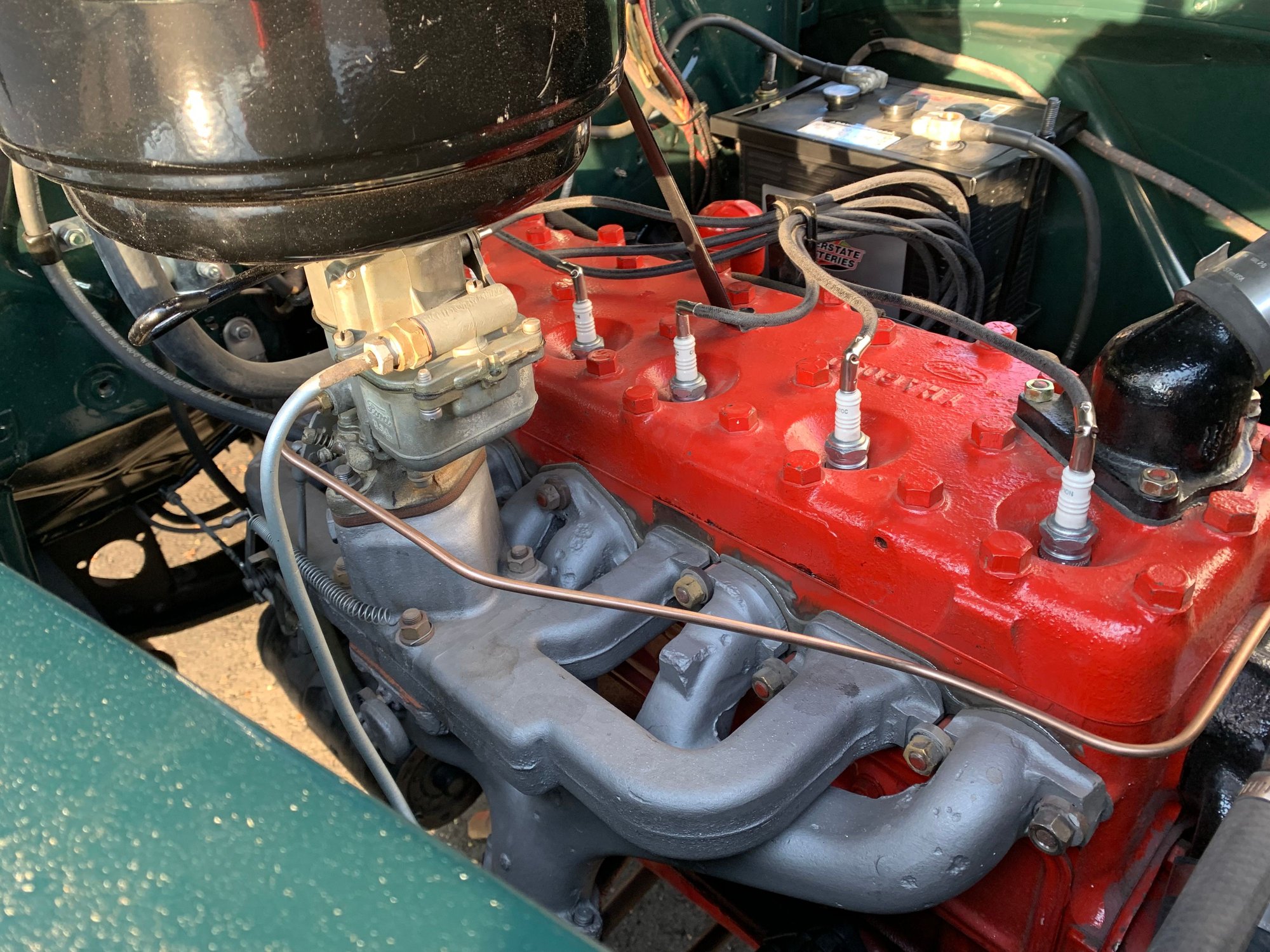

Could these wires be cross-firing at high speed?
The carb was leaking gas down at the flange when I stopped halfway - about after 50 miles.

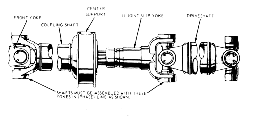

Is the driveshaft properly phased?
Driveshaft Phasing & Its Importance - Managed Mobile, Inc.

I will check right away - I have never heard of this? Thankyou!

Going to continue the vibration diagnosis with checking the spark plug wires next to see if there is proper fitment during higher rpms. They look period correct but not sure if the quality is good enough to prevent crossfire? Also, it looks like I need to torque the head down as there is a little seeping along the gasket - probably not re-torqued as the flatbed has not been run since the previous owner passed. I wish I could have talked to him about his restoration and next steps...

I'm still a bit confused if we're talking about an actual mechanical chassis/drivetrain defect-caused vibration, or an electrical induced misfire type engine shake? OP seems to keep referencing a misfire while also mentioning the word vibration, a condition most commonly considered caused by something mechanical.

One would think a miss fire or mixed plug wires would cause shaking or vibration at low speed in higher gears, I mentioned flywheel cause that truck should have the G engine, and it's an H, and ford changed flywheels almost with every engine.
