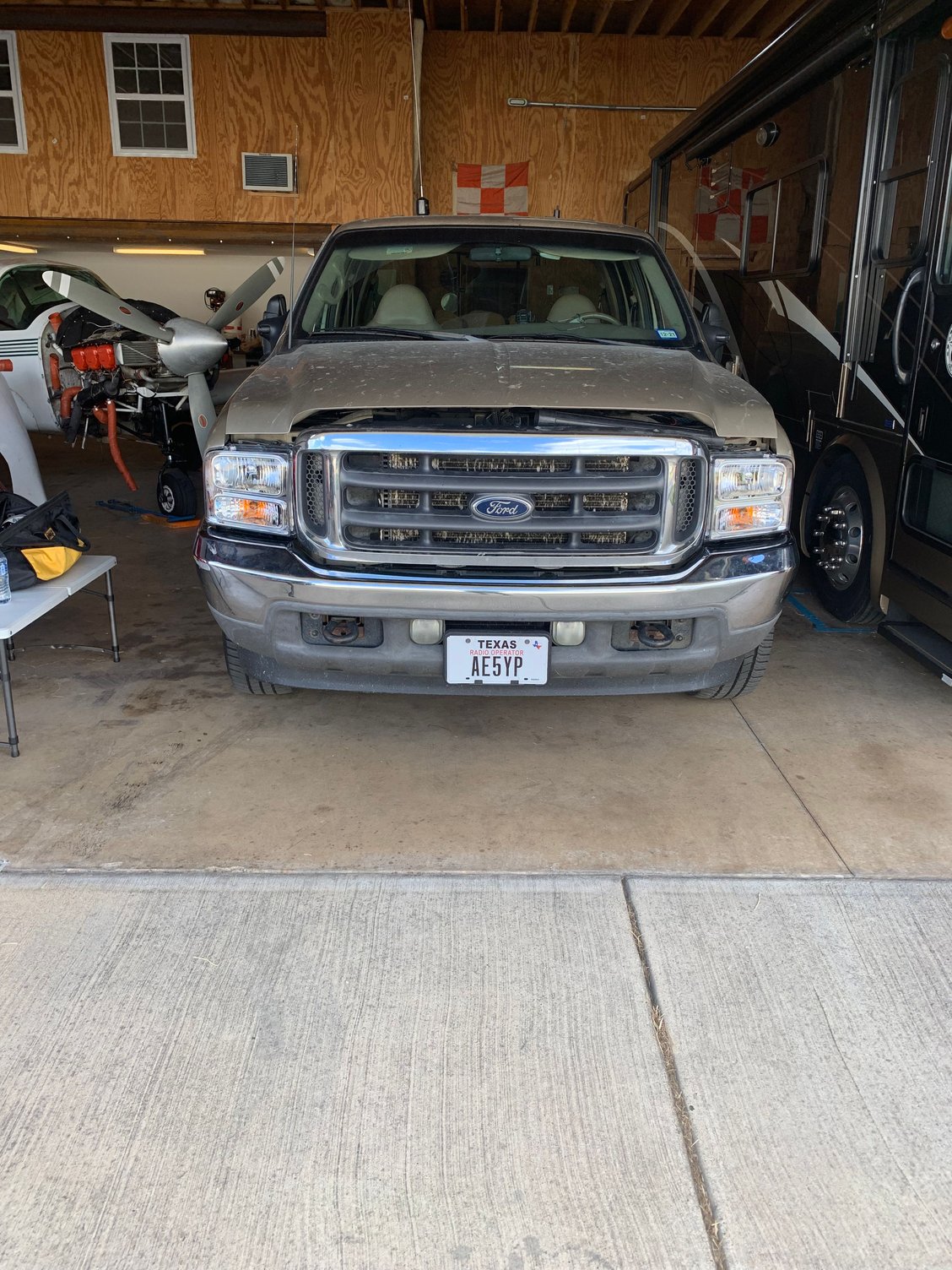

Take a look at the OEM 2005 Motorcraft light conversion. RiffRaff has new light sets and pigtails. Easy changeout only takes a few hours and basic tools. Huge improvement.
Did mine recently.
Did mine recently.
That looks good. Is each side a one piece housing?

@dn29626
Yes these are the one piece housing. They use the two posts holes on the top and the two on the bottom where the running lights attached to the header for mounting. Adjustments are integrated into the light for up and down but point straight based on the header mounts.
No more shady adjustment screws and clips.
