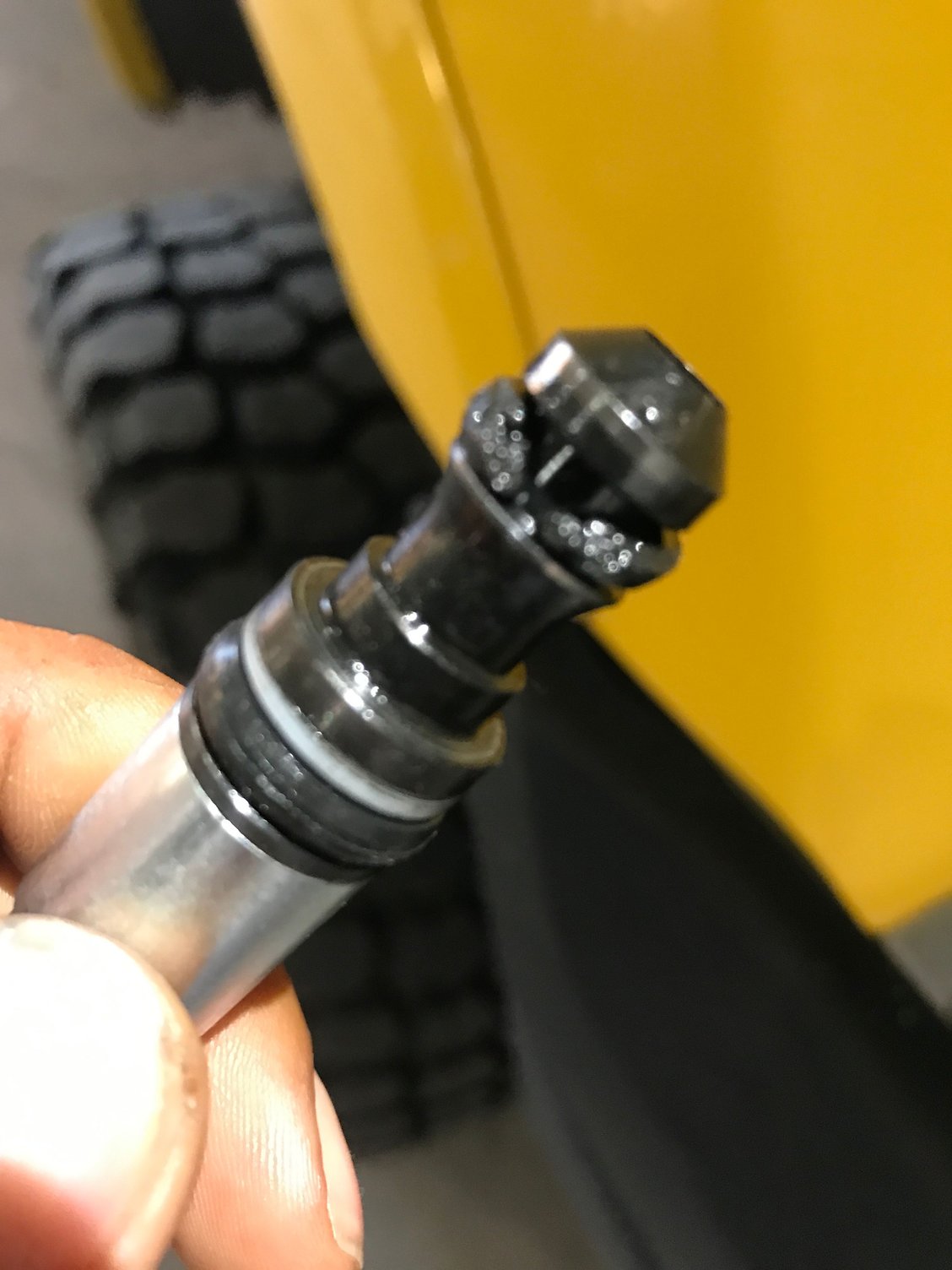

It always started after 1-2 seconds since I bought it new in 06. Except for when glow plugs went out. Ordered air test kit and air tested to find out drivers side did have leak under shop air pressure. Tore drivers side down and found leak to be at stand pipe. O ring was faulty.
Question, if stand pipe comes apart but oring iis ok, can you just put it back together? I know best practice is to replace which I am.
