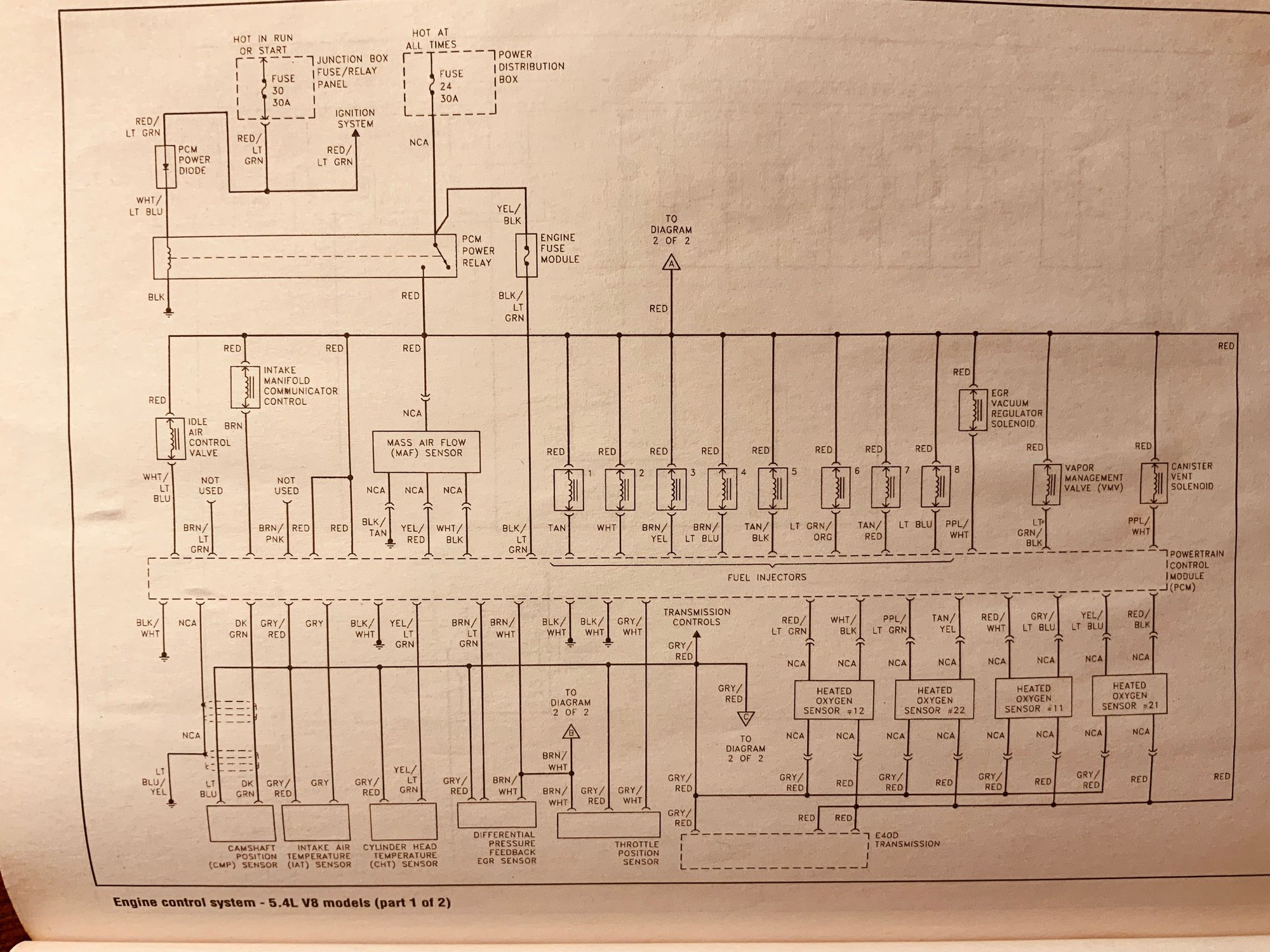

Old Nov 1, 2021 | 02:51 PM

From my 1997 manual but it has your E40D tramsmission electrical connections It shows red spliced to red and gry red spliced to gry/red. There should be Codes also to read ?

Thank you papa tiger, I also found one on a 95. I did find my problem.
