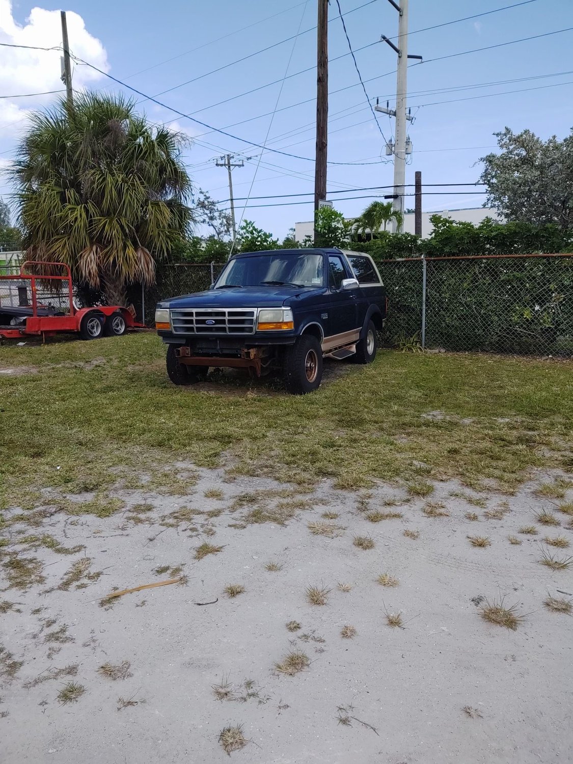

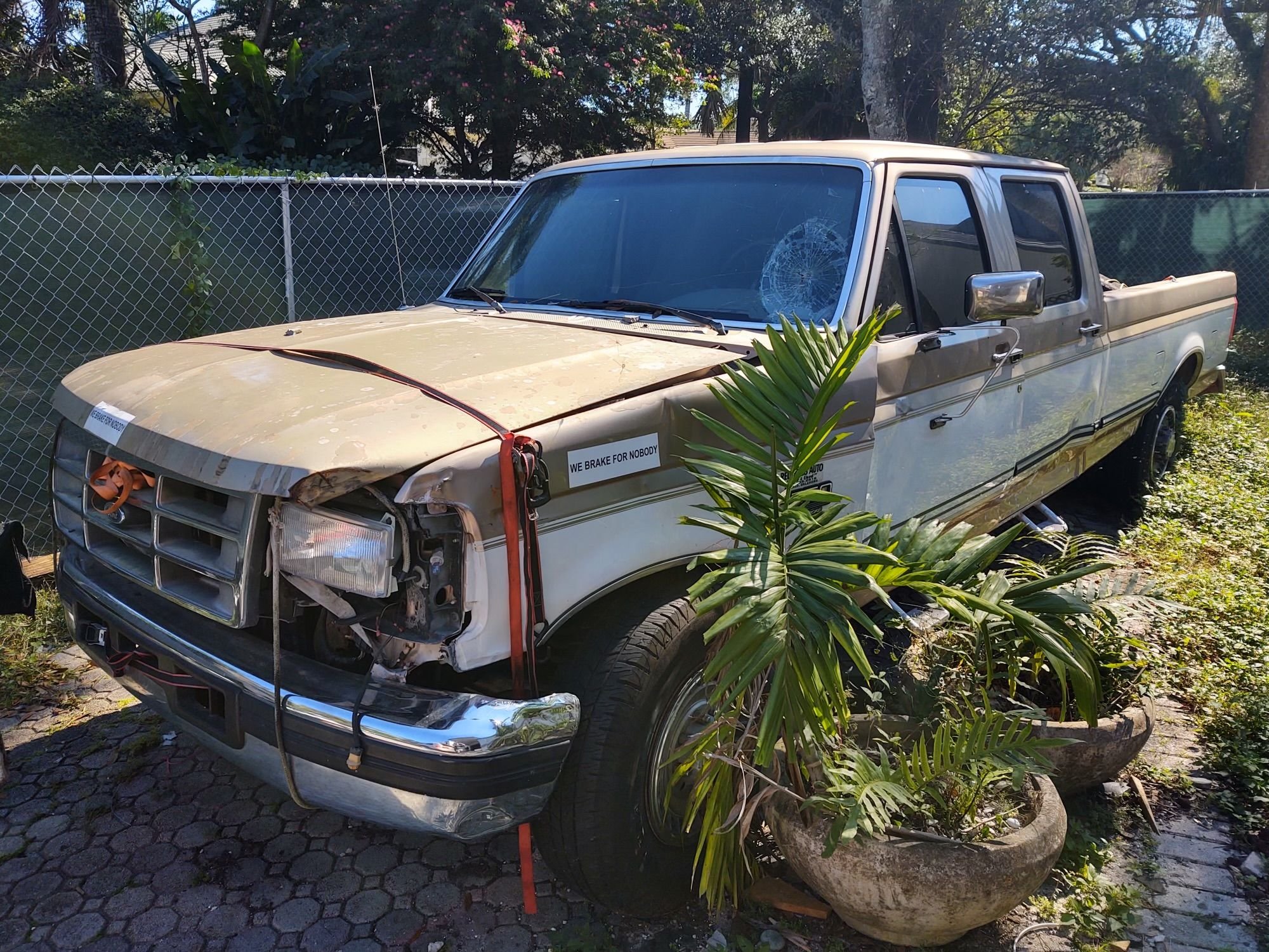

99 was early for the PS 7.3. Was IHI in obs trucks. I thought those were when Ford cutover to from the International Harvester production. Im sure my historical detail will get me in trouble.
My water pump would get the drip drip in cold weather, never used the glow plugs in FL, oil coolers were 50k oring job, and that crank sensor (keep one in the glove box) prob. I have a 97 IHI, diffs, and tranny going into my 97 Bronco from a 7.3 F-350 donor. Back to the 7.3 list of quirks. At least I have a bunch of spares and tools for that franken rig.
