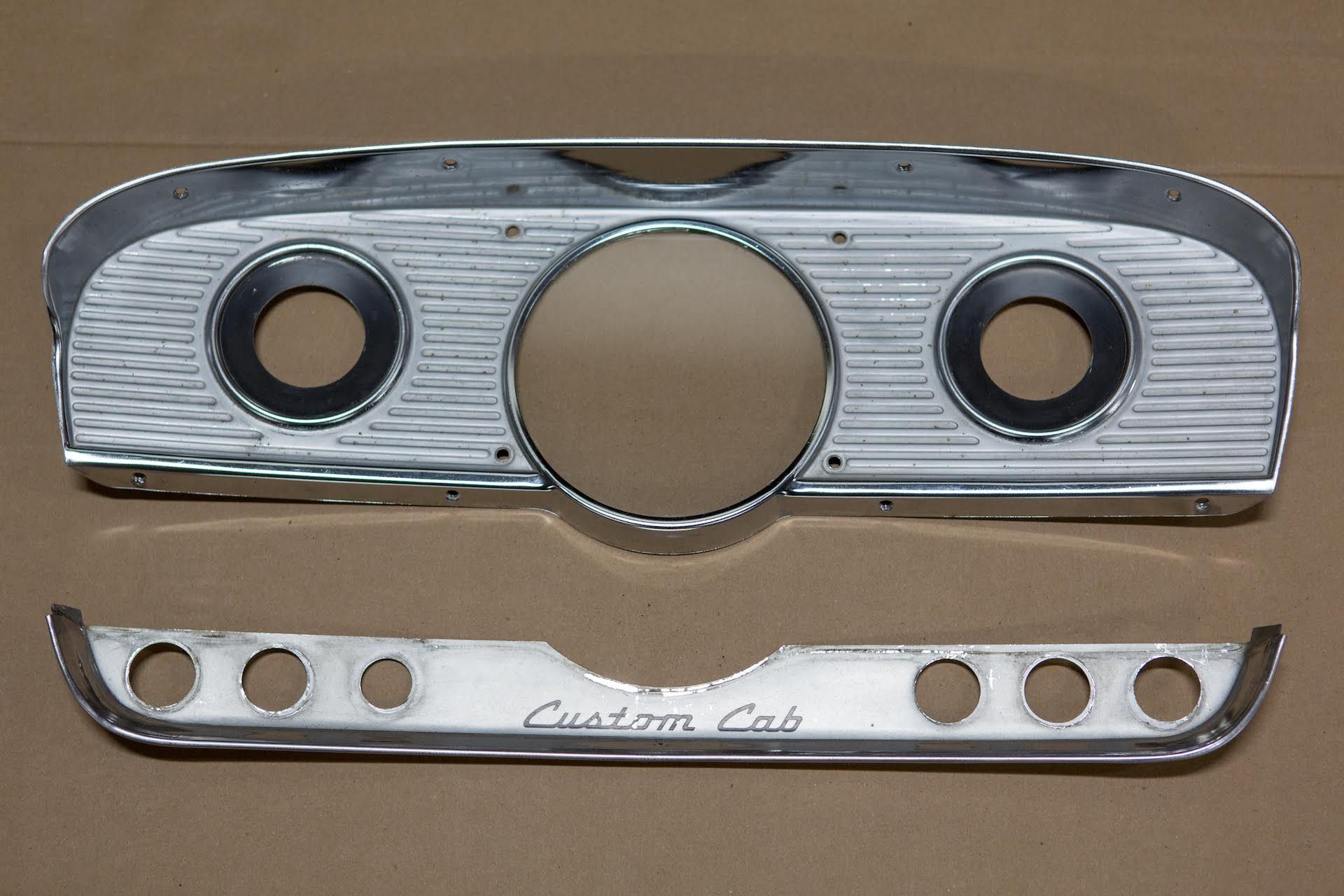

I'm looking to restore the instrument cluster panel and lower dash panel on my '64 F100.
Few questions:
- Are these parts steel? (They draw a magnet, so that's what I'm thinking, but wasn't sure.)
- Are the bright areas chrome?
- If I have these stripped and re-chromed, how do I get paint to stick to the chrome?
- Anyone know the grey paint color code?
- Anyone offer the 'Custom Cab' stencil and/or a replacement decal?

That chrome appears to be in pretty good shape. You might see how it polishes out with a mild chrome polish, or flitz. Then you just have to deal with repainting the recess areas. Ford made a silver paint known as "Argent", used on a lot of their silver finishes. It may be the same color here. If so, ford parts/restoration vendors usually carry it. If you can't find it an aluminum-colored paint matches pretty closely. Whenever I paint a chromed surface, I always mask and lightly sandblast to help the paint adhere. I'm thinking that, if you don't have to rechrome the part, you could probably skip this step.

If magnet sticks and is shiny on back side it is stick stainless. Paint wont stick very good . A lot of trim is stainless such as wind shield trim.

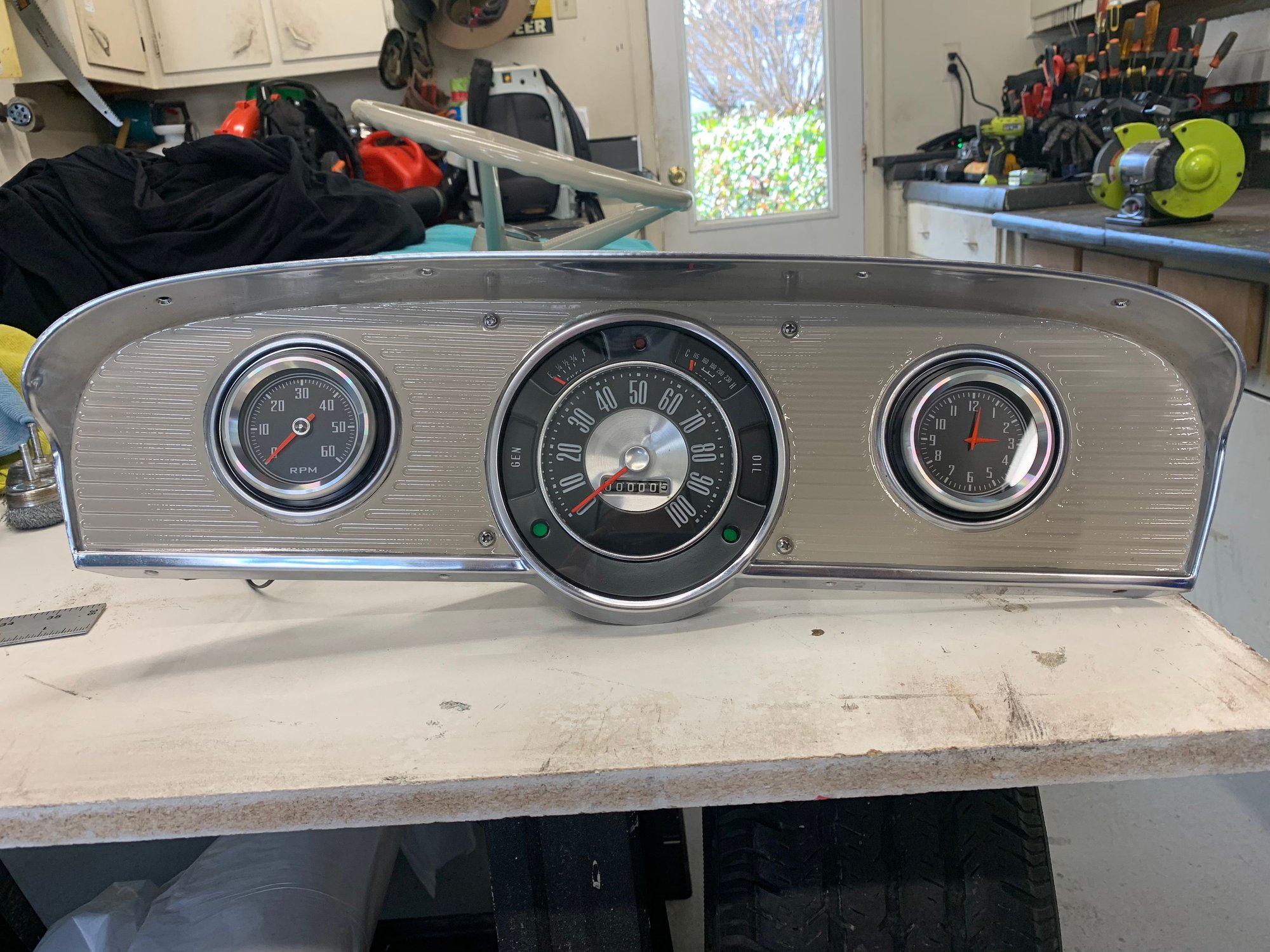

Not a very good picture but I just cleaned it up the hole bezel with some polish, rinsed, and then sprayed some rattle can semi-poly on top to keep from tarnishing. Mine was in much rougher shape that yours is. I just used black vinyl to trim out the two side circles. Was too much silver w/o the black. I really like the look of the gauge set but i'm too damn old to see anything other than speed while driving.

I did some internet digging. It appears the main cluster panel is chrome plated steel, while that lower 'Custom Cab' panel is polished stainless steel. This according to NumberDummy and Garbz from a forum thread years back.
I'm guessing that lower piece is made with the same stainless as the windshield trim. Not the highest grade of stainless as it is magnetic, but apparently a high-enough grade to not rust.
Still looking for the correct color grey.
