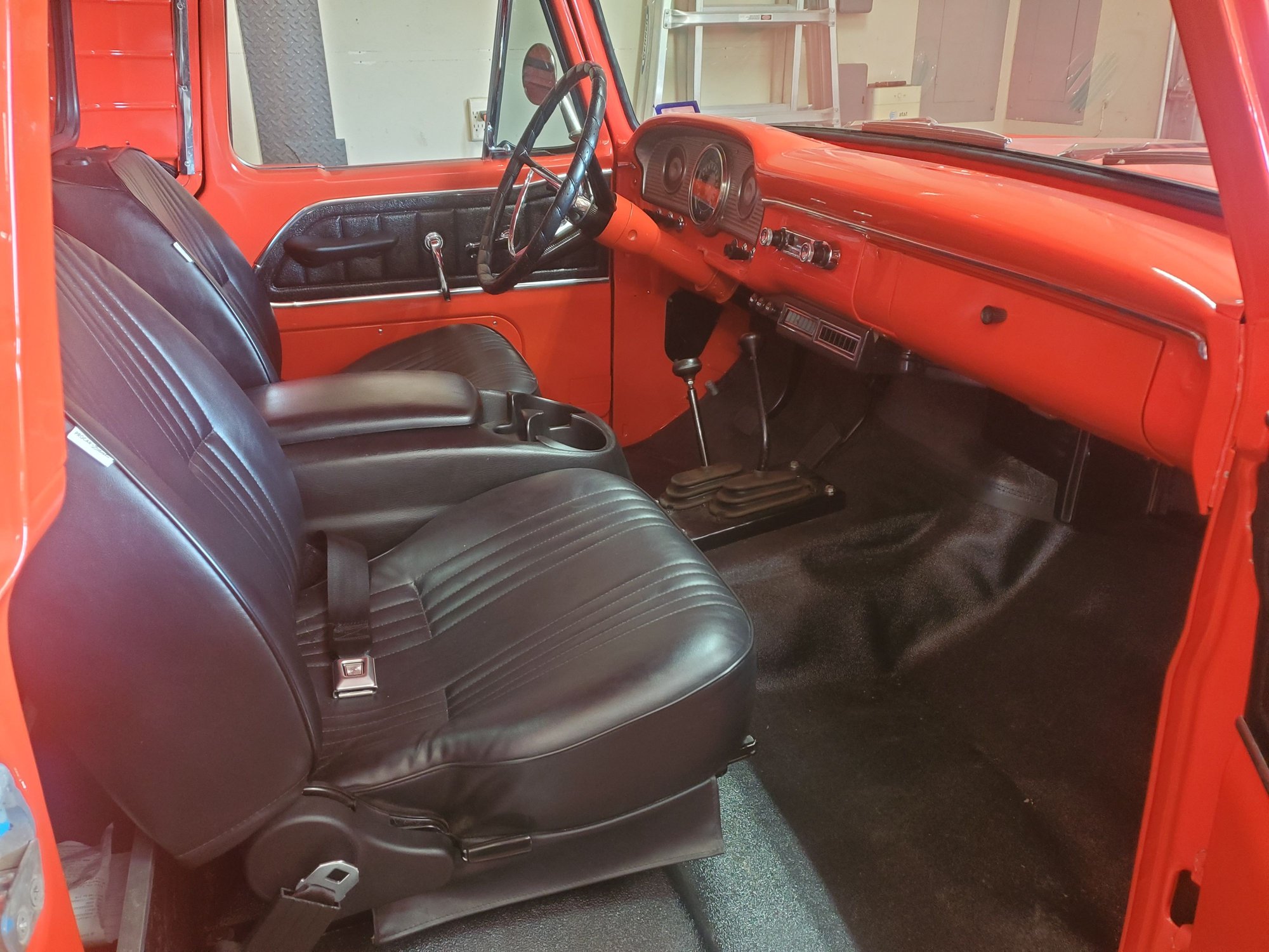

I used a vinyl floor from LMC I believe. I through away the padding that came with it. I used Noico 315mil on top of some foil covered Butal deadening mat. Neither will soak up water and both are self sticking. Very pleased with end result.

I'm in the process of doing that. What insulation and foam did you use and where'd you get it?
