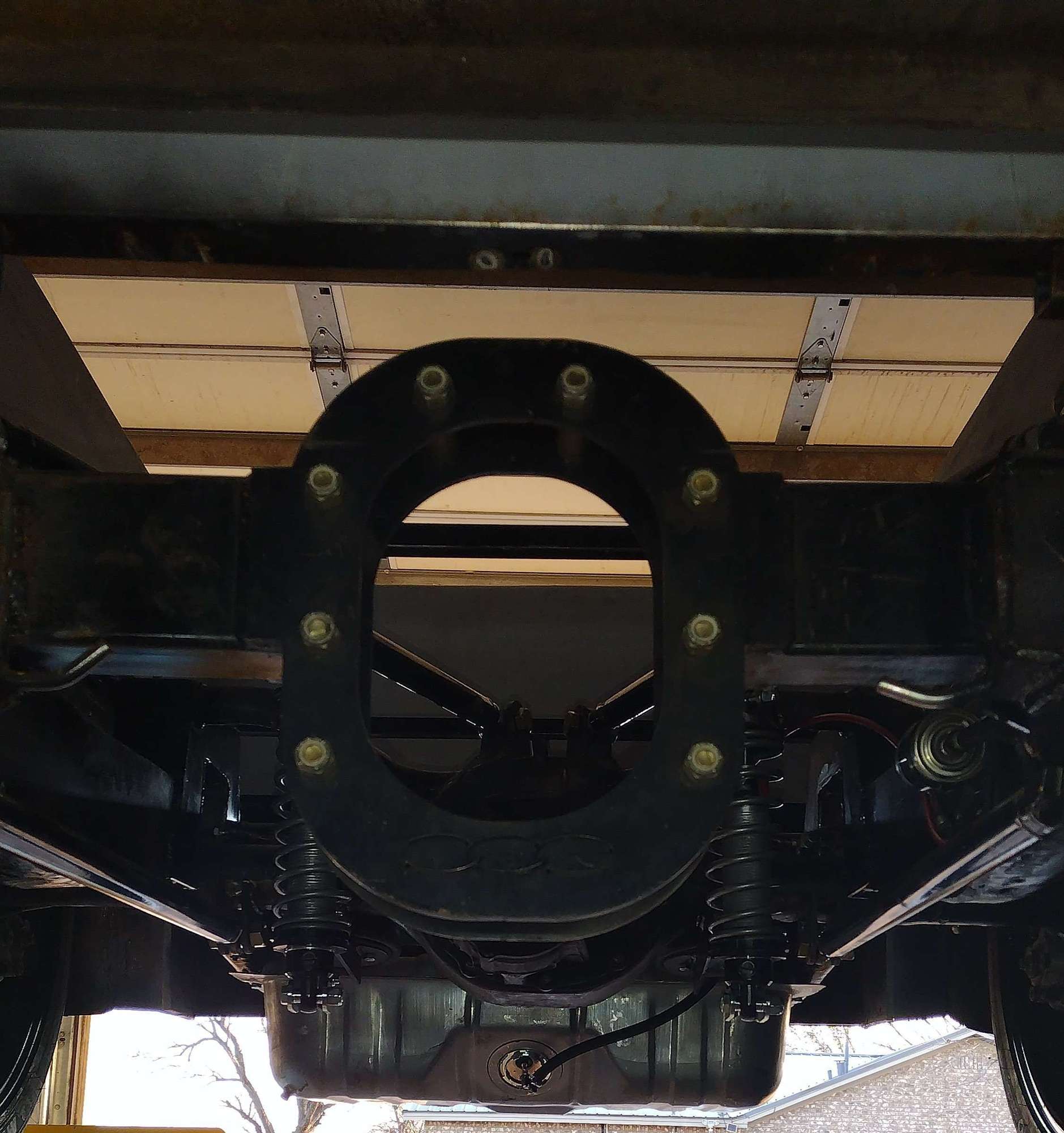

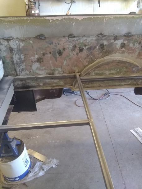

I will take some photo's of the raised floor I created under it to hide the suspension. I added to the sides and changed the bed shape entirely to match the cab as well.

Here is a photo of the supports that I added to raise the bed up to clear the suspension. I am considering the best way to make this area less prone to moisture from the underside. Potentially even using something like a ABS and sealing to the bed before installing the wood above it.

My plan was to place 1 bolt in each piece through the support with a hidden rubber grommet around the threads to allow a little expansion. The waterproofing is the dilemma at this point. I will seal all 4 edges of the wood for sure but considering how to block the water splash from below using something that I can seal and needs no expansion. ABS or another plastic seems it would be best but I am open to ideas.

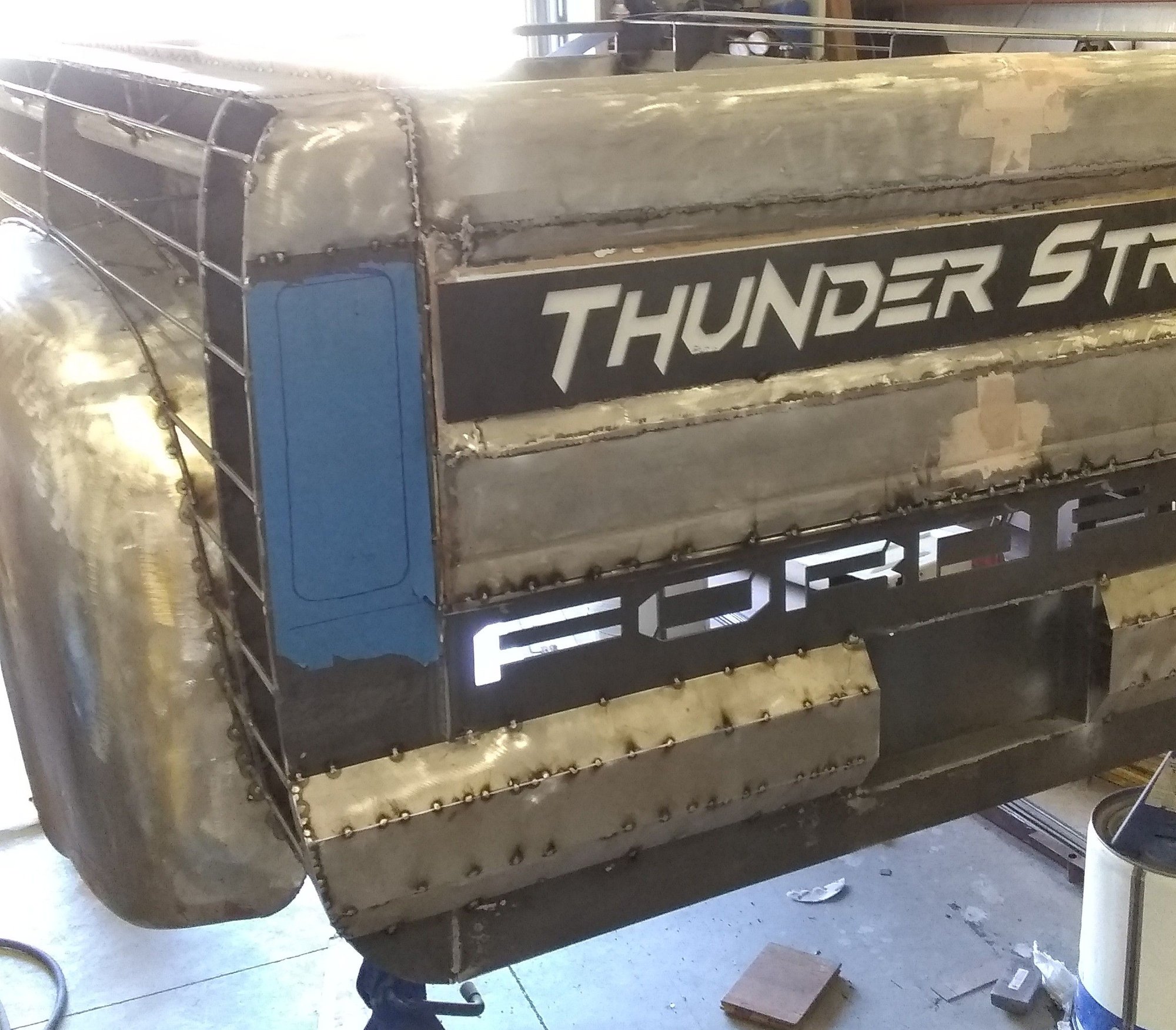

Here is before the Side Sheet Metal and progress on the Tail Gate I am creating. Still 100's of tack welds left and at least a day of grinding left. The Ford F-100 Cut Out is going to be an LED Light Box when finished.

A few days ago I got one side of my Truck bed sheet metal installed. It is far from ready to paint but I sprayed some rattle can Primer over it until I finish the other side to avoid surface rust. I will have to do body work to the rail and sides of course but this is step 3 in the process.
Today I got the 2nd side installed using what I had learned on the other side and it was much easier and will need less body work.
