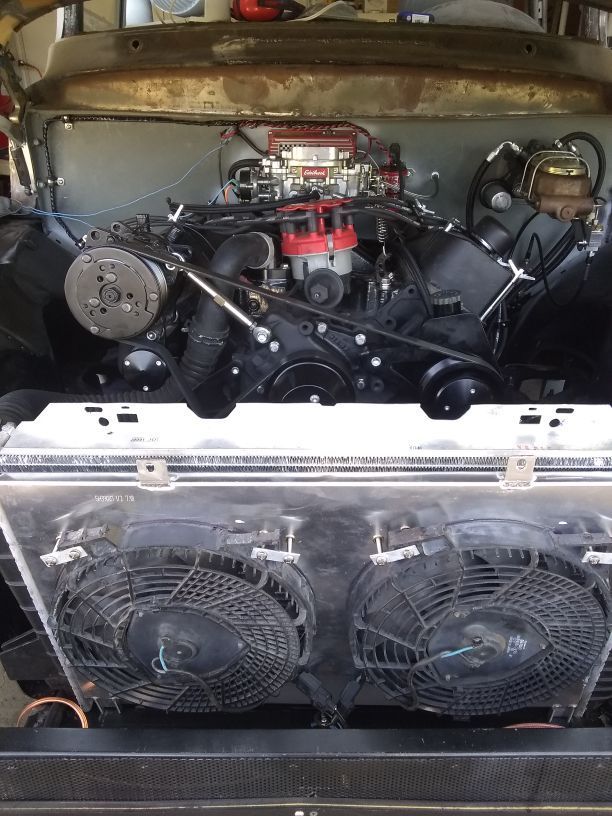

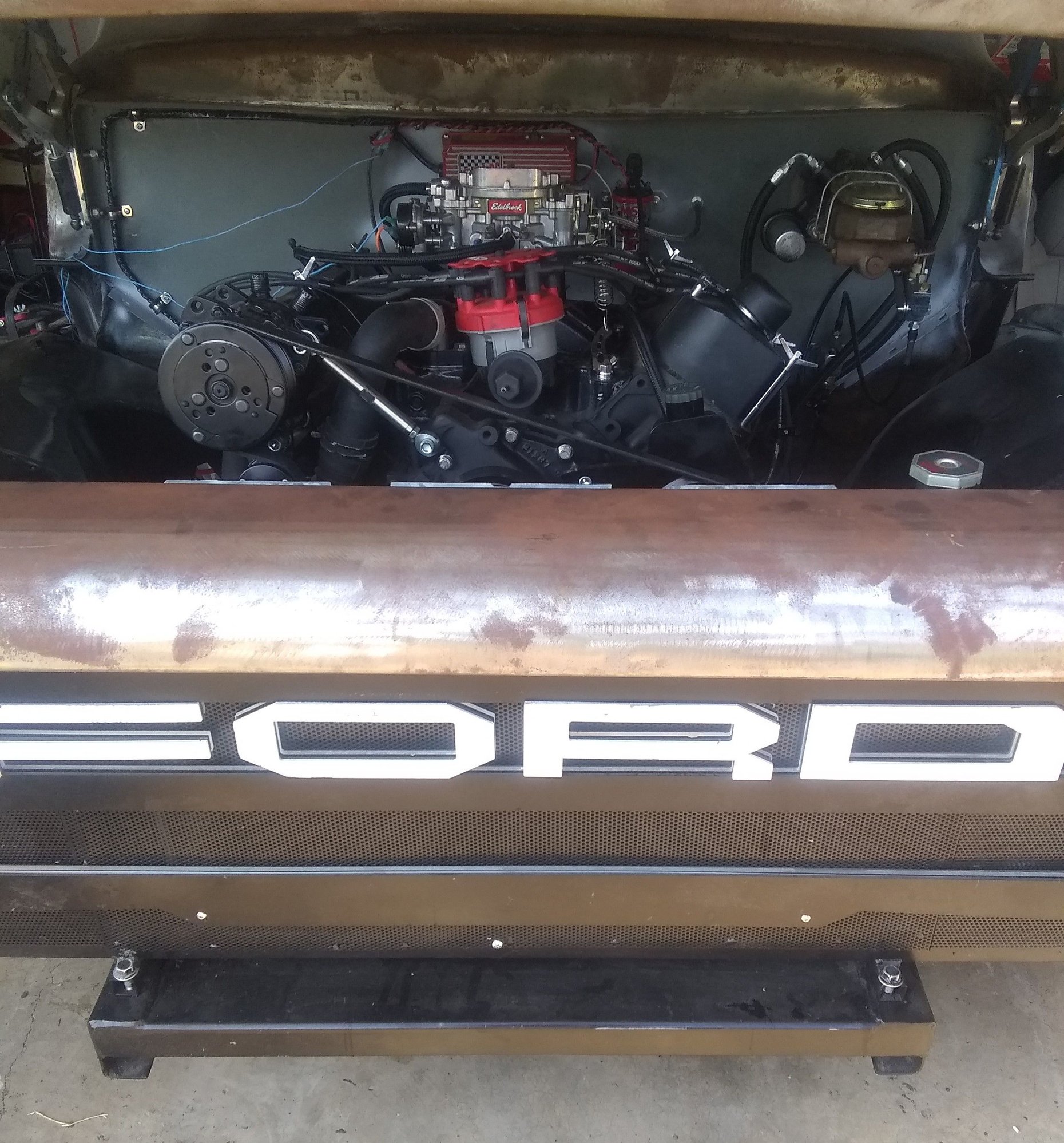

In the last 3 Months I have been making real progress on my Project and it feels good.

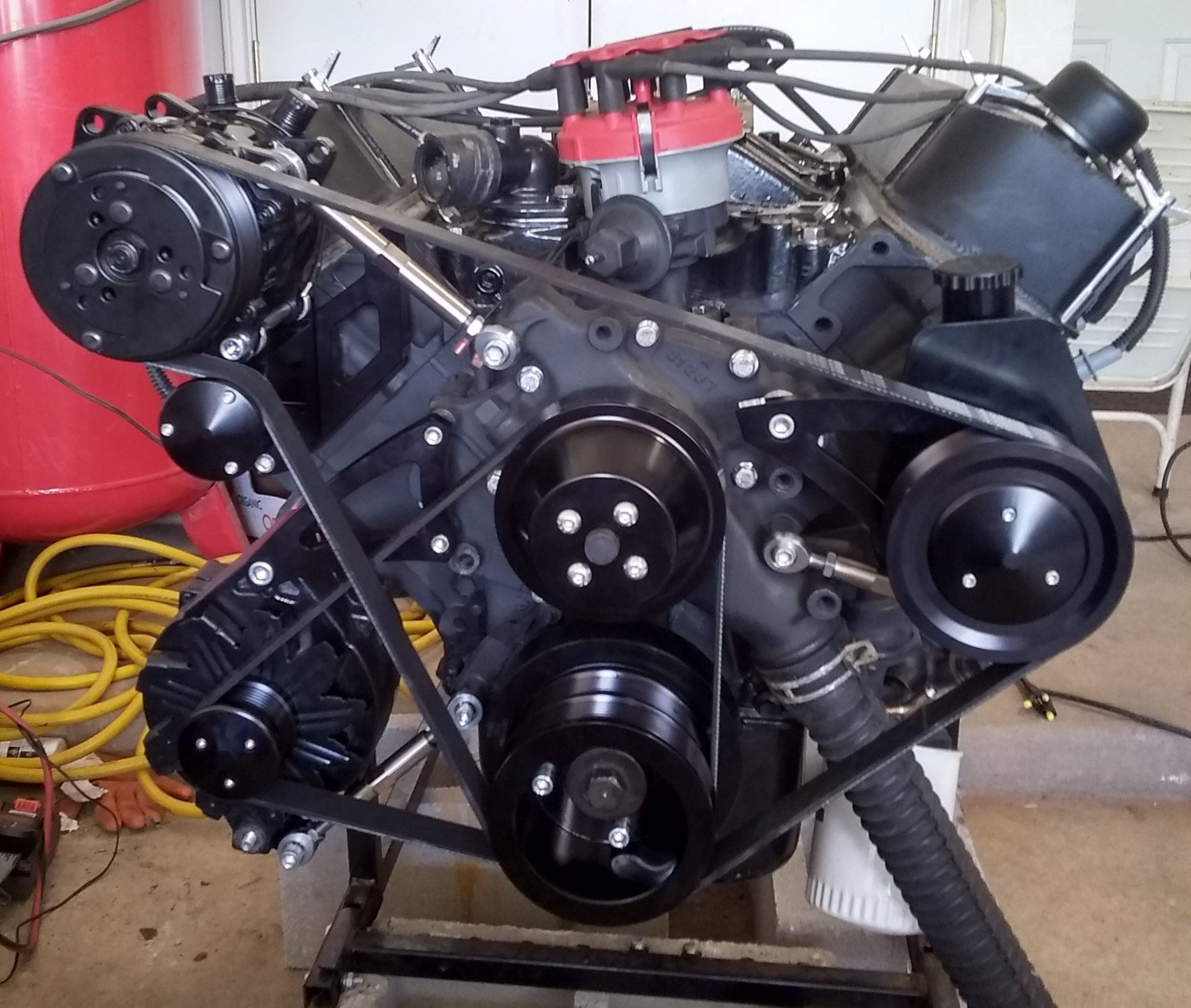

1) I have Built my Motor and Installed it.
2) Installed Brake Pedal, all Brake Lines, Hydro Boost, Power Steering Lines
3) Installed Gas Pedal and Cables
4) Installed One Piece Power Windows
5) Installed Shaved Door Handle Actuators & Poppers
6) Began wiring Electrical
7) Rebuilt Rear End and Mounted Transmission
8) Installed New Driveshaft
9) Installed Gas Tank, Filter and Fuel Lines
10) Installed and wired Two Radiator Fans
11) Installed New Wheels and Tires
Currently working on Installing Remote Oil Cooler and Filter before taking my Transmission in for a Rebuild. Next is to wire Starter to actual keyed Ignition so I can remove those blue wires to a starter button on the side of my truck.
Hopefully this will inspire others to work on their Trucks as well.

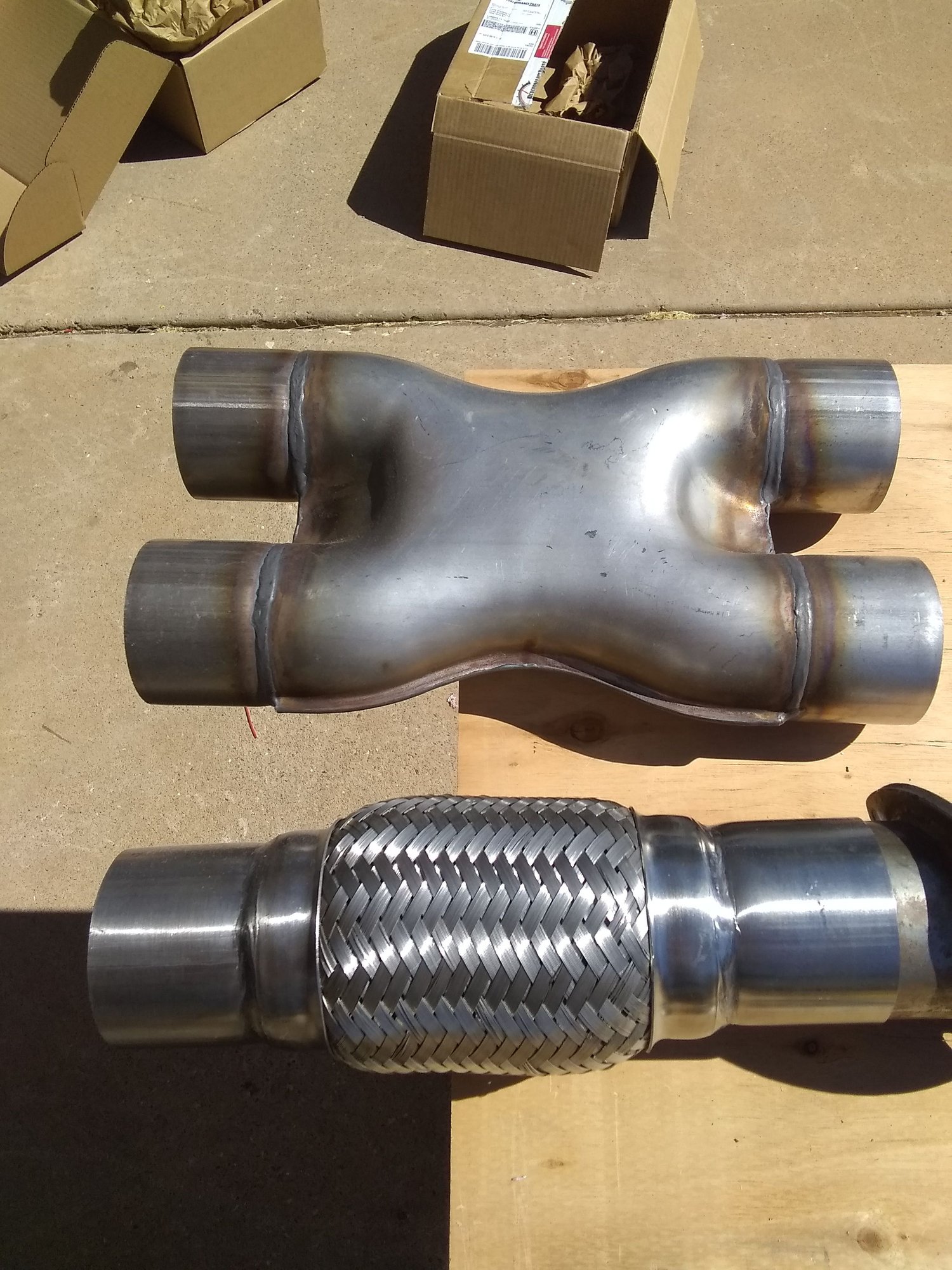

Also starting on the Exhaust soon.
The Exhaust will consist of the Following.
Sanderson FF462 Headers
Heavy Duty Double Braided Stainless Steel Exhaust Flex Pipe with 2.5" ID / 6" Braided Length / 10" Overall Length
Exhaust X Pipe 2.5" Inlet, 2.5" Outlet 12" Long Stainless Steel
Flowmaster 12512409 Super Hp-2 Muffler 2.50"In/Out 12" 409S

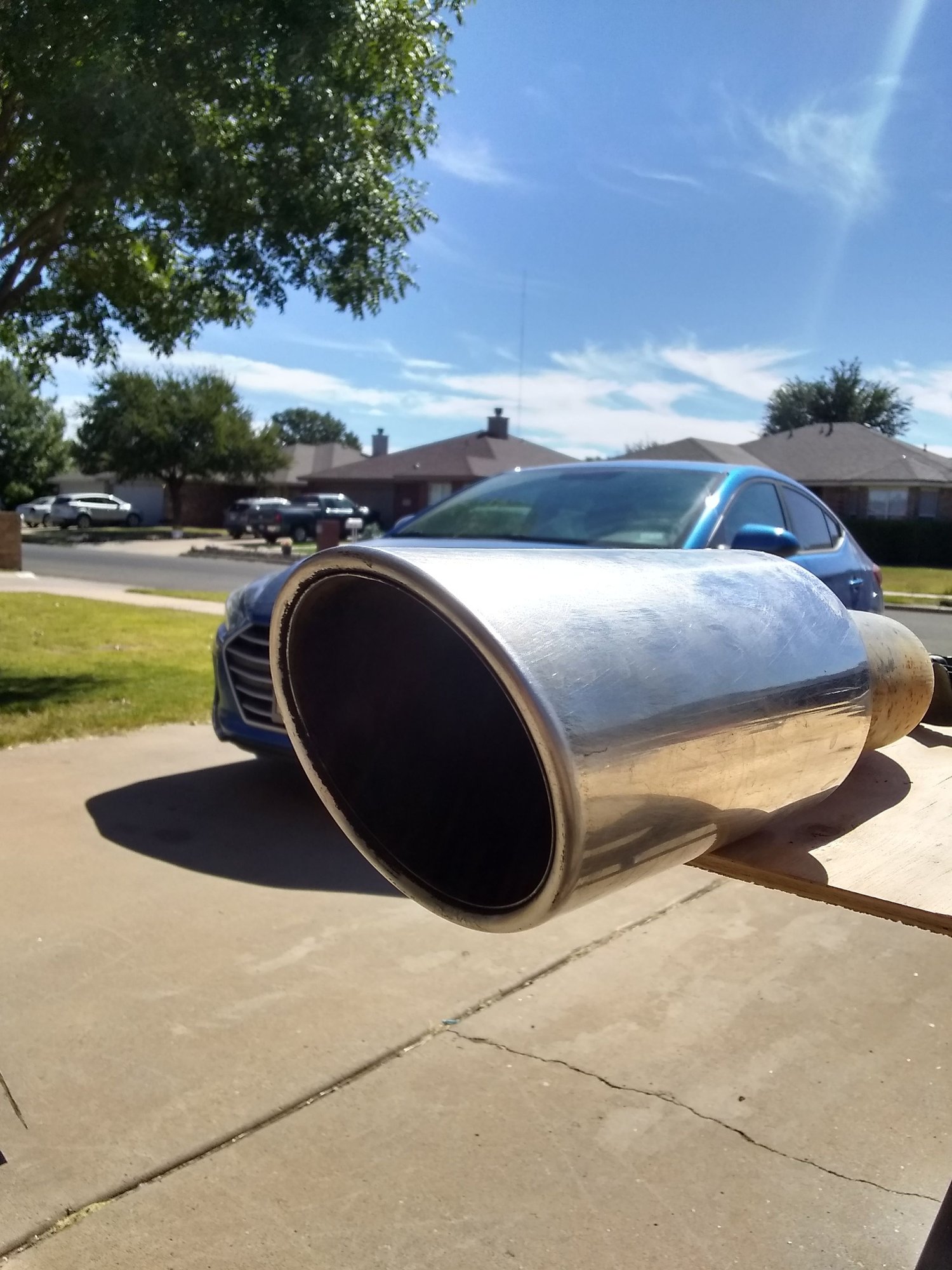

2008 Infinity FX45 Tips (Got at Auto Yard for $4.00 Each on 50% off day) Plan to have them Ceramic Coated Black.
