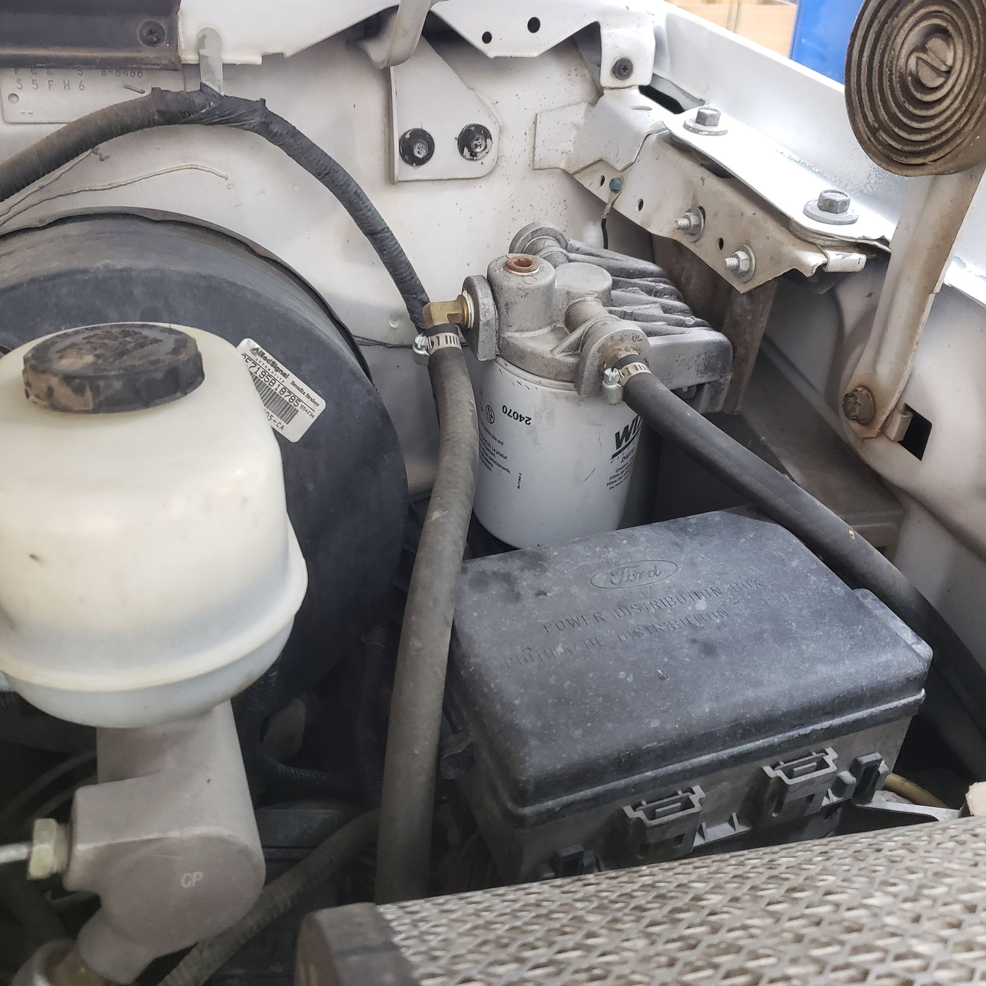

I have what is probably borderline paranoia about my coolant temp gauge failing, so I'd like to add a second one that will read actual temp and display on a gauge mounted in the cab. Has anyone done this? If so, how did you add the port for the additional gauge?

I ran the sender off my coolant filter head from Diesel Site. There is a 1/8" NPT fitting there. It is up under the ashtray area with a few other vitals.
All electrical gauges, mechanical are more of a nuisance to install. I THINK the stock water pump also has a good size bung you can remove if you wanted it there.
just ordered a coolant filter from there. What gauge and sender did you use?

Before you get started, you may want to consider a coolant filter like Eric has. You can either do a stand alone or get an international water pump with an integrated filter

I did a 3 gauge pillar mount with boost exhaust temp and temp, the temp gauge is on a 6 position rotary switch with a probe for coolant, engine oil temp. Transmission temp and rear axle temp.
for the coolant temp I removed the plug under the thermostat facing the driver side fender and put a T in it with the temp probe pointing up. Then a nipple on the end for the hose to the filter. Then another T in the return heater hose for filter return.
