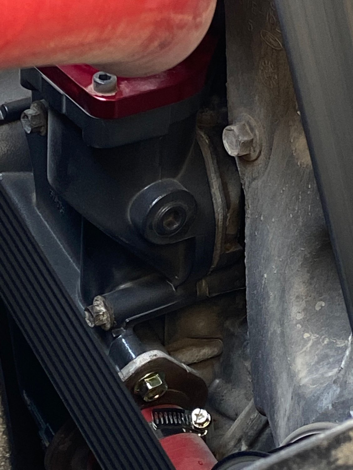

I’m still having a little problem with engine temp gauge climbing higher than I’m comfortable seeing it on the factory gauge when pulling heavy up a long steep climb. No idea of the real temp so I bought an actual gauge. I’ll install it tonight if it cools off enough. Can I put the sensor in the plug that’s on the side of the water pump?

Yes, it will work there well. Drain radiatr out the bottm and that lets enough out for your install without a mess.

What Eric said... Also, be mindful of the belt and pulleys when routing the wire.
