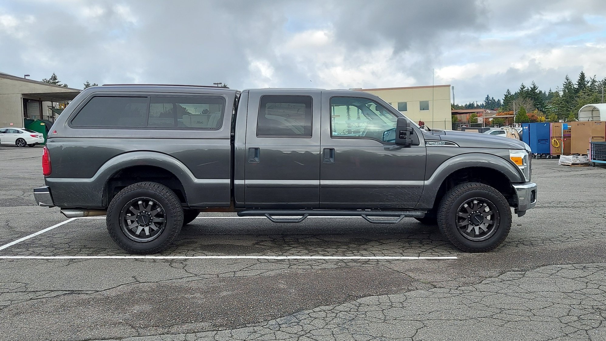

Hey that is my truck.
FWIW I was told by my local Leer dealer that they could replace the back glass with one made for a step tailgate on my particular shell model (Leer 100XQ). If I recall correctly the cost was about $400 installed. I have not had that done, but probably would in hind sight. The back glass has worn a groove in my tailgate cap plastic right where the glass meets it. It also does not seal very well like that.

After seeing this thread, I did a quick search on craigslist and actually found one offered that fit my truck. Picked it up today and love it so far!
Old Oct 14, 2021 | 06:55 AM
mikereidjr's Avatar
mikereidjr
Joined: Apr 2006
Posts: 241
Looks GREAT!
