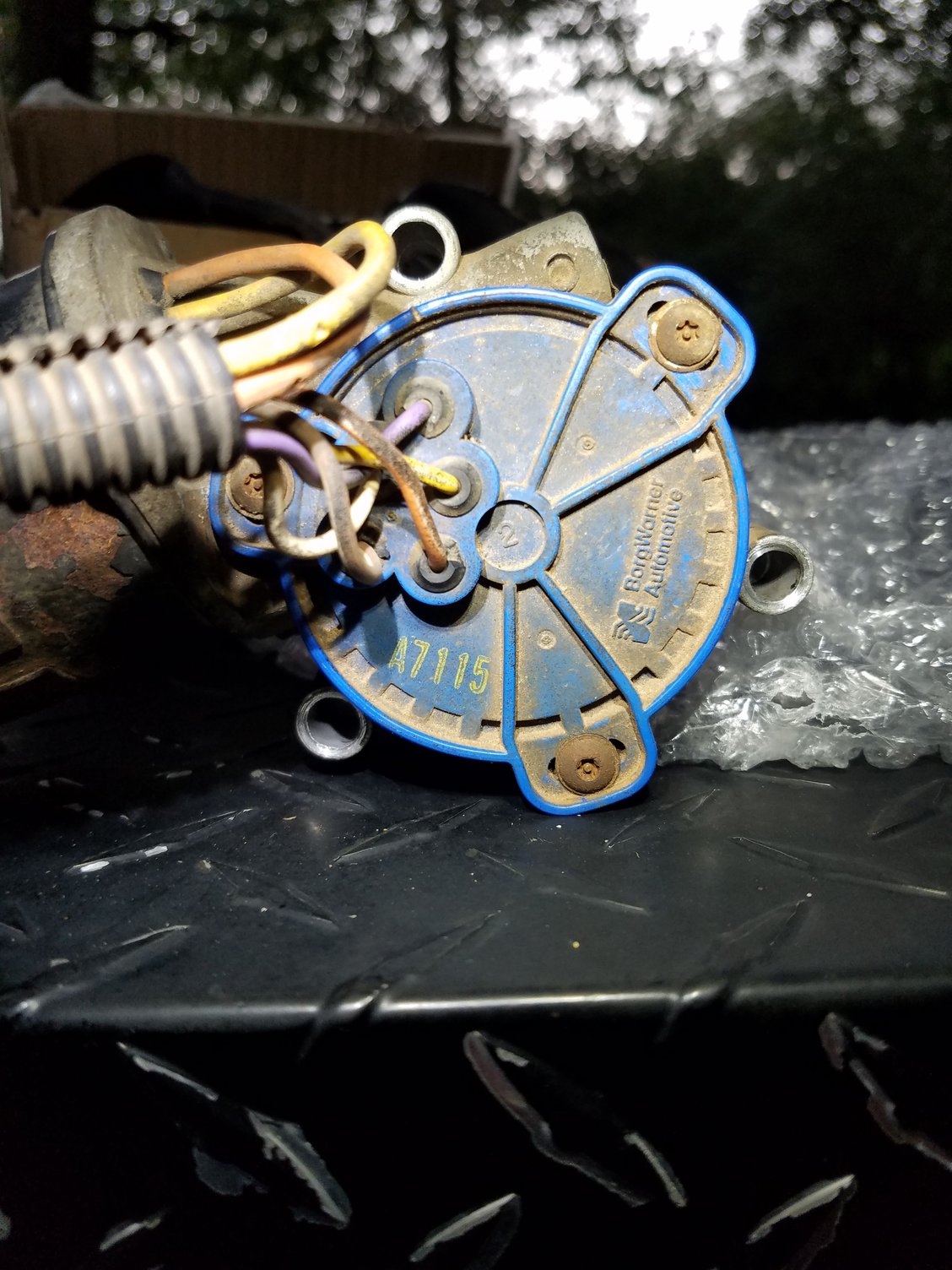

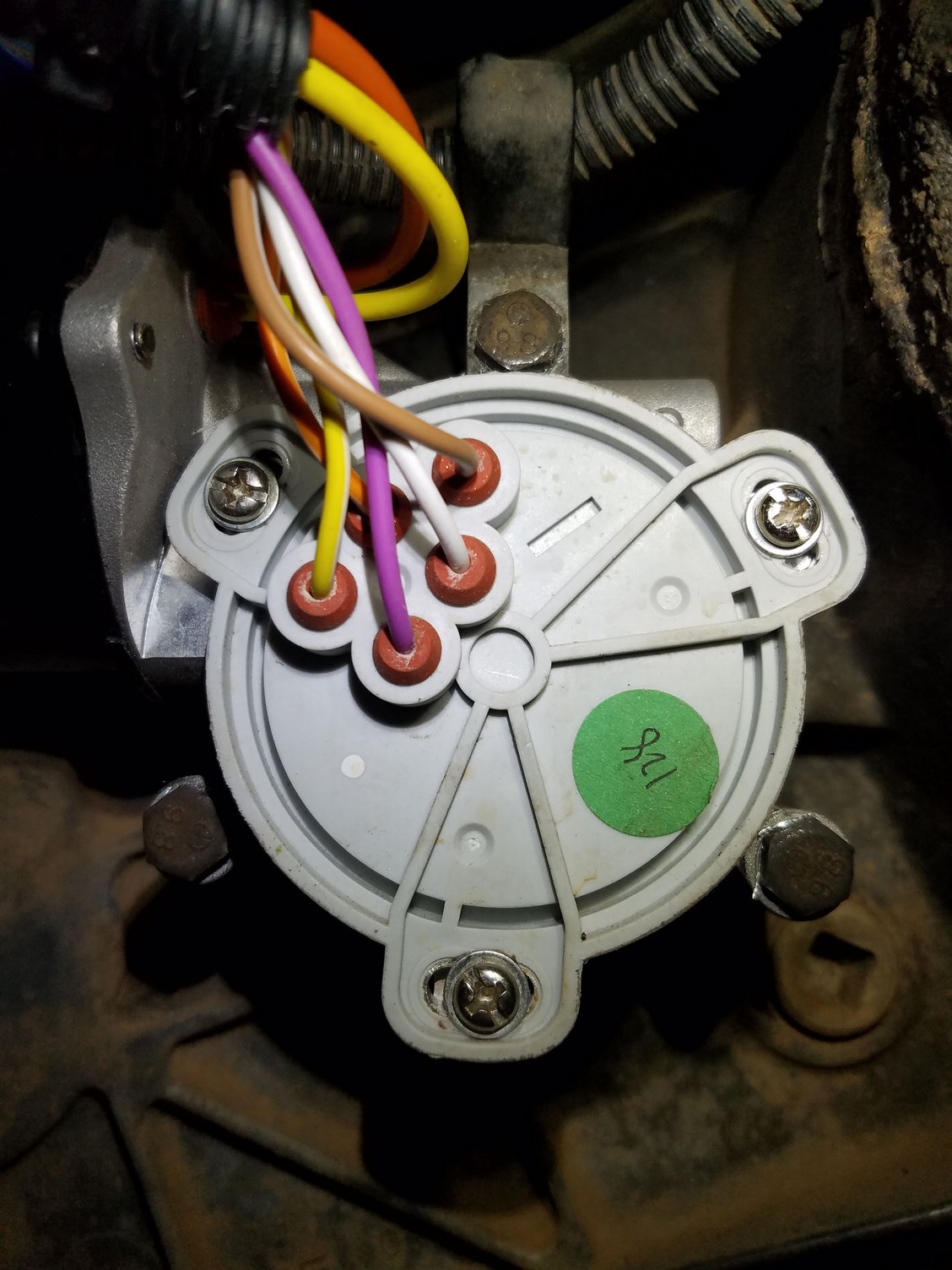

No I didnt move anything. My transfer case shows the 2H 4H and 4L positions under motor and it was in 2H when I put it back on. Didnt spice no wire the colors matched my hook up on the plug but I have notice they are in different places when the wires go into the motor itself than my old one was by the color wires. Would that be the problem?
My old 1
My new 1

The mew one looks like it is the the 4auto option.
