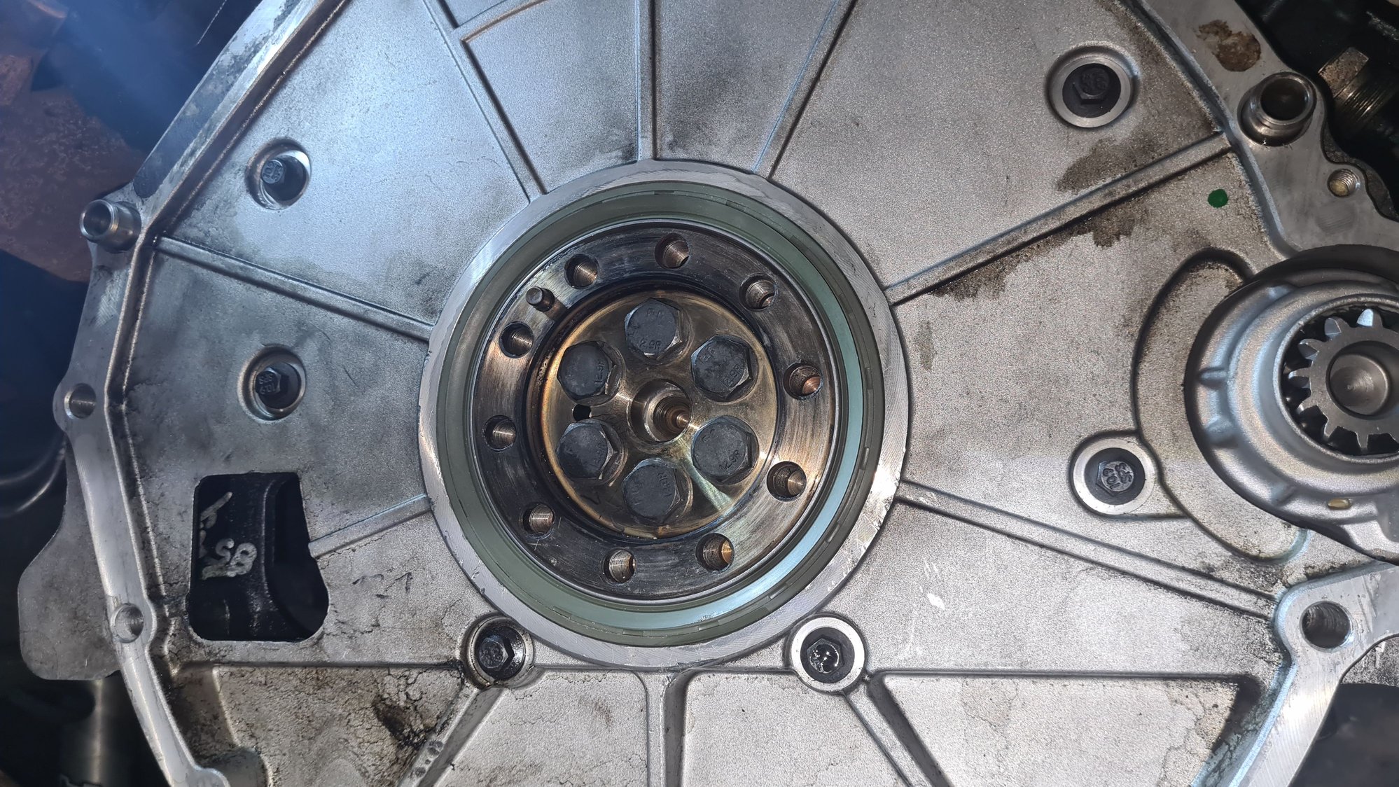

Very few specialty tools -- other than the Rotunda/Moto for the rear seal. He'll need a trans jack (cheap as hell at Harbor Freight), no special stands, and can set the thing on its *** during rebuild:
