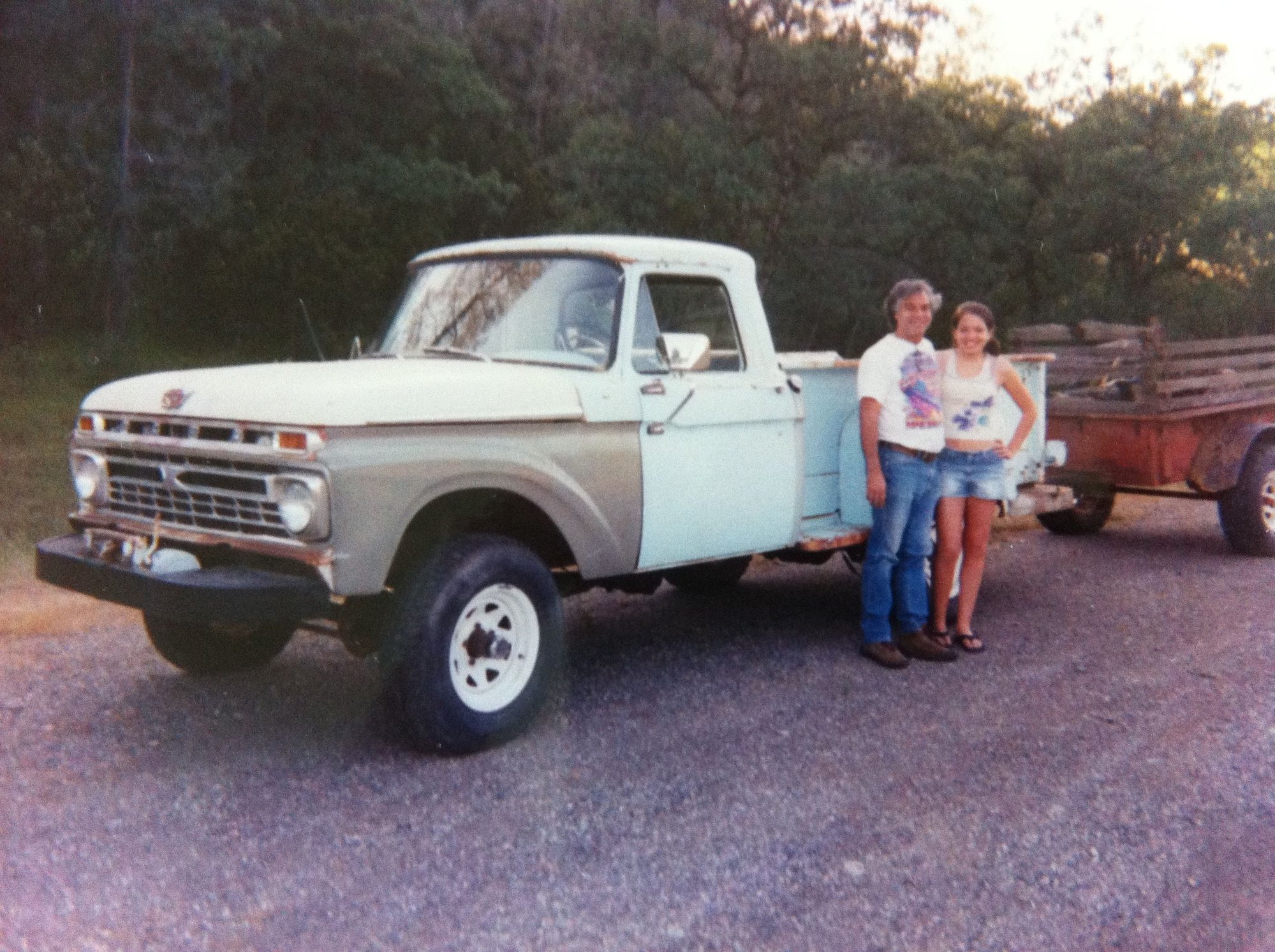

Bucks5050,
I have a '61 Ford F10 4x4 with battery box in the floor.
A couple of years back I swore to my wife "I'm missing one of my good batteries" and had zero luck finding it.
Well, as I was snooping around cleaning spider webs off of my '61, i decided to pull the battery cover.
Yep, there sat the 'missing' battery from my search a few years back. dag-nabbit, it has sat discharged for too long, and is expired.
My '61 4x4 conversion was done by "Lambert Co. Ltd." in Los Angeles june 8, 1961. kinda cool.
Above photo was taken on Hwy 36 between the Pacific Coast and the Sacramento Valley.
It does have a 292 Y-block V-8 w/ 2bbl, a 4-speed w/ granny gear, and divorced T-case.
The PTO winches are bullish for pulling.
The front clip is from a '66 nearest I can figure.
So, are my front fenders the standard F100 radius openings ? and not the F3 to F6 openings ?
