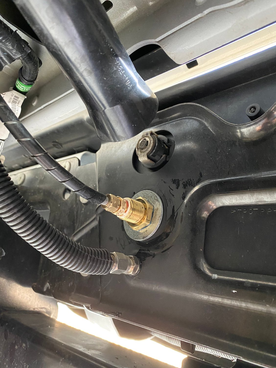

Completed a couple smaller projects for this recently. Made a inflator/deflator two tire kit, still need to make an adapter for the Viair compressor. I also installed my PMF Track bar and Daystar Airbag cradles. Since I had the drag link off, I went ahead and painted it black, a little less rust underneath.

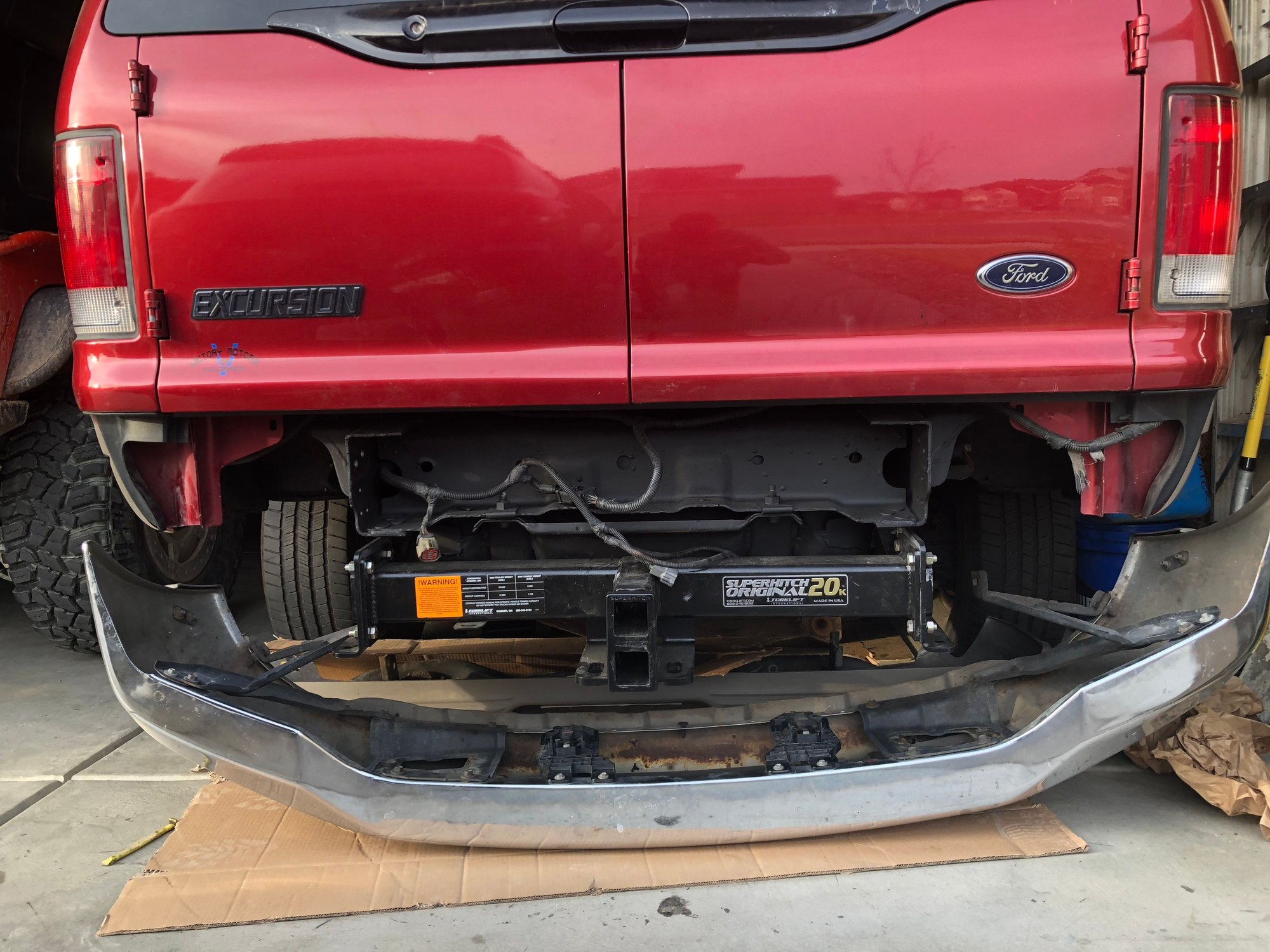

Final update as @Squirrel13 recommended and persuaded I ended up going with a Torklift Super Hitch. This thing is super stout, great quality, powder coated everything, zinc coated hardware and the instructions are solid too. I took some time and painted underneath my truck, removing some rust and scale in the process. Some of the bracketry really aids in tieing the hitch to the frame. Plus it just looks fantastic.
In September one of my 34" tires had a blow out, ended up on the factory spare for a little while, the 34" did fit underneath but was rubbing the exhaust a 33" fits with a little bit of room, something to keep in mind. Unfortunately the tire plug kit didn't arrive at home until the next day and we were coming home from a camping trip.

Not just one, but two vertical frame web ties per side plate, fore and aft, at each flange bolting center?
This means that lower frame flange cannot peel or bend down.
There isn't another receiver hitch on the market for this application that provides that much backup.
Dang.

Correct, very stout well built and powder coated receiver.

Wow, that's a nice one! I almost bought a Superhitch when I was still carrying a cabover, but one thing led to another and we ended up in an F-53 instead.
