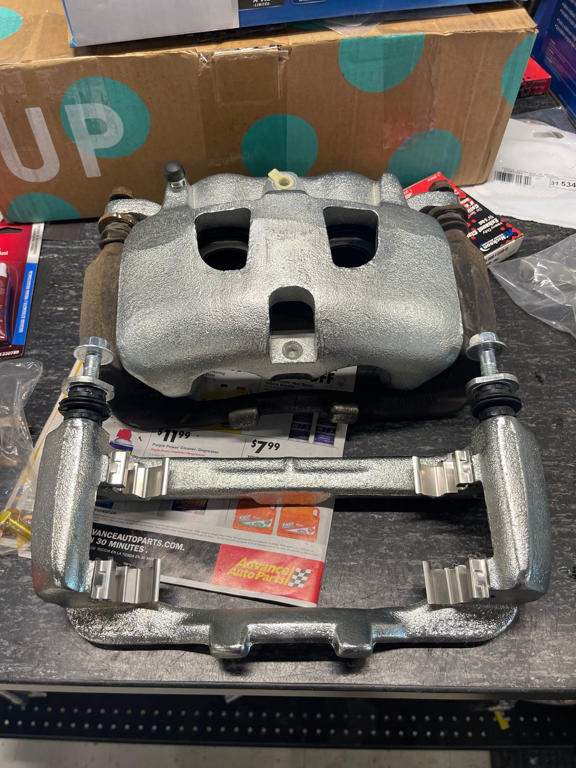

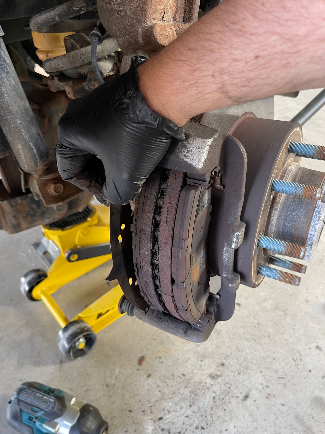

So...I completed ONE caliper this evening, before dinner time. Took just a little over 2 hours and here is what I've learned so far:
The calipers are location-specific....there is a LR RR RF and LF. Brake pads are Front and Rear, but there is no (apparent) inboard and outboard pads...none of them have any discernible difference from the other. As far as the old ones, they look pretty much like the new ones.
I started on the Right Rear side and I hope that this one is not typical of the others. This one was heavily rusted and needed to be pried off the bracket. The backing plate on the inboard pad was rusted to the caliper...I think I found the source of the original problem!
As for the clips...this had me stumped for a while. I could NOT figure out how they worked....even with the old ones right before my eyes. No matter how hard I looked, it wouldn't add up. Then, the coin fell into the slot and my brain kicked into gear; all I had to do was install the NEW clips on the NEW pads, in the same manner as the old ones. At first it still didn't make sense, but then the light came on. The clips fit over the ends of the pads and the springy, curved part extends into the sides of the calipers, pointing away from the rotor. Upon closer examination, each of the clips has an angle to it that matches the angle of the casting on the caliper...if you use the proper clip, the pad will orient itself parallel to the rotor. If you select the wrong clip, the pad will be askew. Once I figured that part out, the process became a whole lot easier.
My tips for rookies:
- Loosen the banjo bolt BEFORE removing the caliper. It might drip a bit, but you won't have to fight with it later.
- Before removing the banjo bolt, make sure the master cylinder reservoir cap is on and closed tight....this will help in preventing too much fluid loss.
- Make sure you remove the old copper washers from the banjo fittings...they won't fall off on their own, you'll probably have to pry them off.
- Grease the caliper brackets BEFORE you install them, or apply the grease to the clips, it will help to hold them in place during install.
- Use brake-specific grease and don't get any on the rotors or pads. If you do, clean it off with brake cleaner. Apply a thin coating to the BACK SIDE of the inboard pad...the metal side that the pistons press on.
- While the calipers are OFF, clean your rotors.
- In order to swing the old REAR caliper(s) out of the way, you have to remove a retaining bolt on the brake line...scope it out so that you don't have to do it while holding the caliper.
- Use BLUE loc-tite on the bracket bolts and caliper bolts...you don't want those fasteners walking out while you're driving.
- Gravity bleed the calipers once installed; remove master cylinder reservoir cap and crack bleed nipple on caliper. Once the fluid arrives, close the bleeder then proceed to bleed brakes in accordance to the method you you are most familiar with.
- Don't forget to pressurize the system before you drive away....that is to say, make sure you've pumped the pedal while still in the driveway and verify that your brakes are working.

Turns out the RF caliper was also "dysfunctional"...that's TWO of four that weren't in optimal operating condition!
The front calipers were a bit more of a challenge with regards to wheel placement to access the works, otherwise it was much of the same.
I started putting the calipers together (with pads) on the bench before installing the whole assembly. An issue with the threaded mounting hole on the right side slowed me down by about ½ hour.
The new front pads come with the same clips as the rear ones AS WELL AS another little clippy thing that I couldn't figure out for the life of me. The old ones didn't have these extra items, so I didn't bother putting them in. If this proves to be a problem, I can always add them at a later date...I kept ALL the clips that were left over!
I ran out of fluid (a whole quart!) so I wasn't able to cycle the ABS at this time. Most of the Parts stores will be closed until Tuesday now, so it will have to wait....there are no plans to use the truck this weekend anyway.
Finished in about 5 hours for three wheels, but I like to take all the rusty lug nuts and mounting bolts and run them through the wire-wheel to clean them up a bit. Then, factor in the ½ hour I killed finding a tap and re-threading a mounting hole...I'd say the whole process could take 4 - 5 hours for the average weekend warrior.
If anybody can show me how to install those extra spring clips..that would be great!
Why don't the new pads have the "squealers" (wear-indicators) on them?
