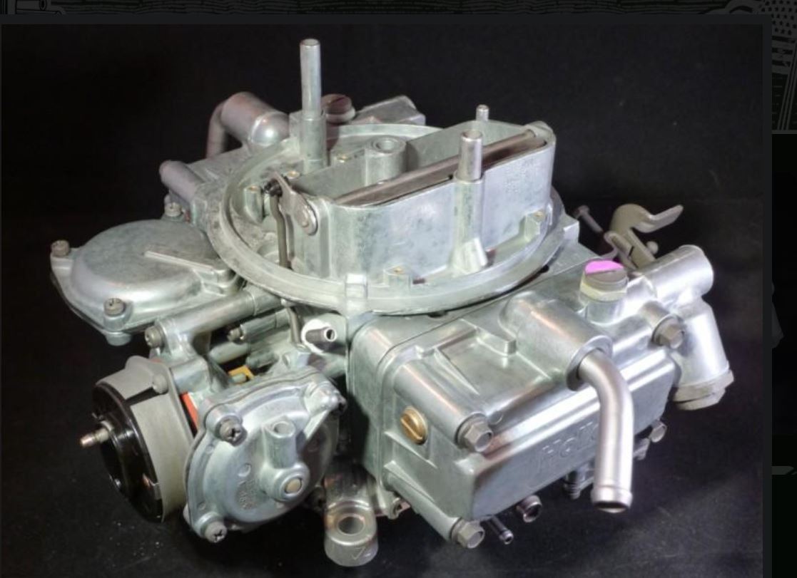

From 79'-87' the engineers at Ford used a 620cfm Holley 4180 square bore on the 460. This is the last of the carborated Ford trucks. There are many who believe Ford finally got it right including myself. Sure there are some quirks but all holley parts are available to you, it can be adjusted at all four conners, and it has Ford linkage. You can pick a builder for $75-$100 send it out to a pro for rebuild for $225-$250 and be into a great Holley 4-barrel for $350. It's like the 4160 but with more bells and whistles.

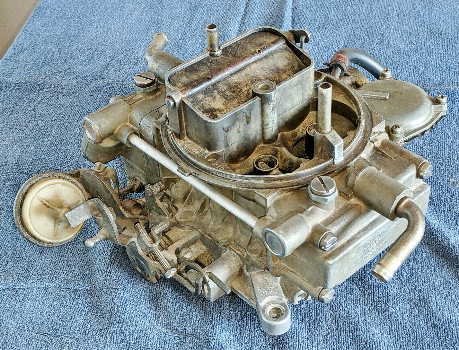

too funny my pos 4180 has that same patch on the fuel plug.

If you have a 4180 you have the Ford kickdown and you have the base of the 4160. If you couldn't manage the 4180 what makes you think buying the 4160 is going to make things better for you.
Maybe Holley just ain't your thing partner or do you care to expound on your POS comment and enlighten us on why a 4180 is a POS but buying a 4160 which has you in a better scenario for your 460 match up.
Things to do to your 4180C for performance
