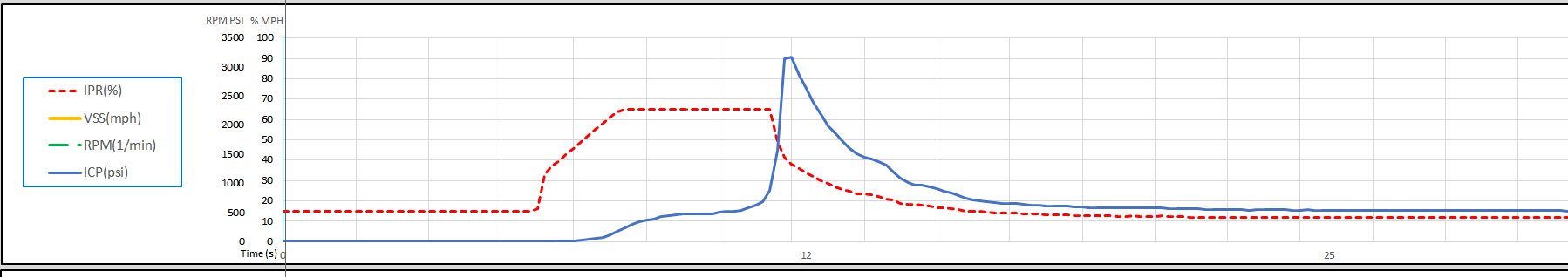

OK, first time so I'm not sure what I'm doing here, nor do I yet understand what I'm looking for???
Les, you may be on to something....I put a meter on the bats while my wife cranked it over. i think it came very close to 10.5, I'll do again a pay better attention. Side note on GP. I tried to set Forscan to monitor GP and if I did it correctly, it never showed any percentage?? I have not inspected HPOP in AM. This could be a false assumption, but I figured if there was no oil observed outside, I should be good on that account? Thanks again you guys for each of your inputs and time...really appreciate!
