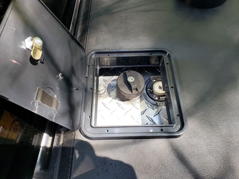

RV access door showed up a little while ago, and it is going to work just like I had in mind.
The door edge nearest the back window will attach to the frame of the bed cover, and along each side I will be installing pieces of .125" thick aluminum stock to support it between the cover frame crossmembers.

DONE!!!
Worked out pretty much like I pictured it would, just a little bit of wrinkling of the vinyl when I screwed it down tight to the frame.
Oh well, the important thing is it worked, and demonstrates that I can do it again if I decide to go to a hard folding cover later on.
Of course, now I have one more key to deal with, key ring is getting full!
Last pics, first showing the aluminum supports between the frame members that the access door is screwed to.
And, the finished pics.

Cover doesn't roll up, it is a tri-fold, fold the back two sections over onto the front one to tow a 5th wheel, no interference from the access door, just have to fold the rear sections back over to add fuel, no issue at all.
