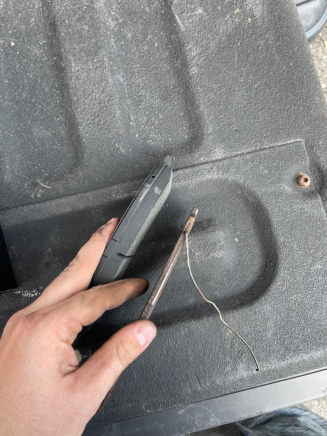

howdy, came across some things. Haven’t began the process of repairs but had to take the wheel off to look it was driving me crazy. What I’m thinking happened is the caliper ejected this bad brake pad! Crazy to think. And from there it leaked out fluid.

First I would the suggest the 4WD was not a factor. The pad is completely gone from the backing plate as you can see, the backing plate looks as if it's been heated, possibly caused by the absence of the pad, this should have been noisy and noticeable though unless it came off just as you were starting to back up. Did you find the pad? If not the pad may have been defective or just got hot from failing to disengage properly, possibly falling off just prior to you parking.
In any case the fluid you see is due to the piston over extending and should be resolved with a pad replacement. As mentioned check the caliper for wear, and the piston for function, if there is no visible damage a pad replacement should be your remedy. I have had this exact same issue, backing out it threw a shoe causing immediate brake fade. My problem was a badly worn brake pad and rotor. My fix was replacing pads and the rotor. Best of luck, hope this helps.
thanks for the response, when the problem happened I remained in a parking spot. I was not able to find chunks of the actual pad anywhere in the event that the pad broke in that instant. Everything is pointing towards the piston fully extending, and I’m just going to go ahead and change the caliper, pads and rotors, and bleed the system. I’ll post updates!
