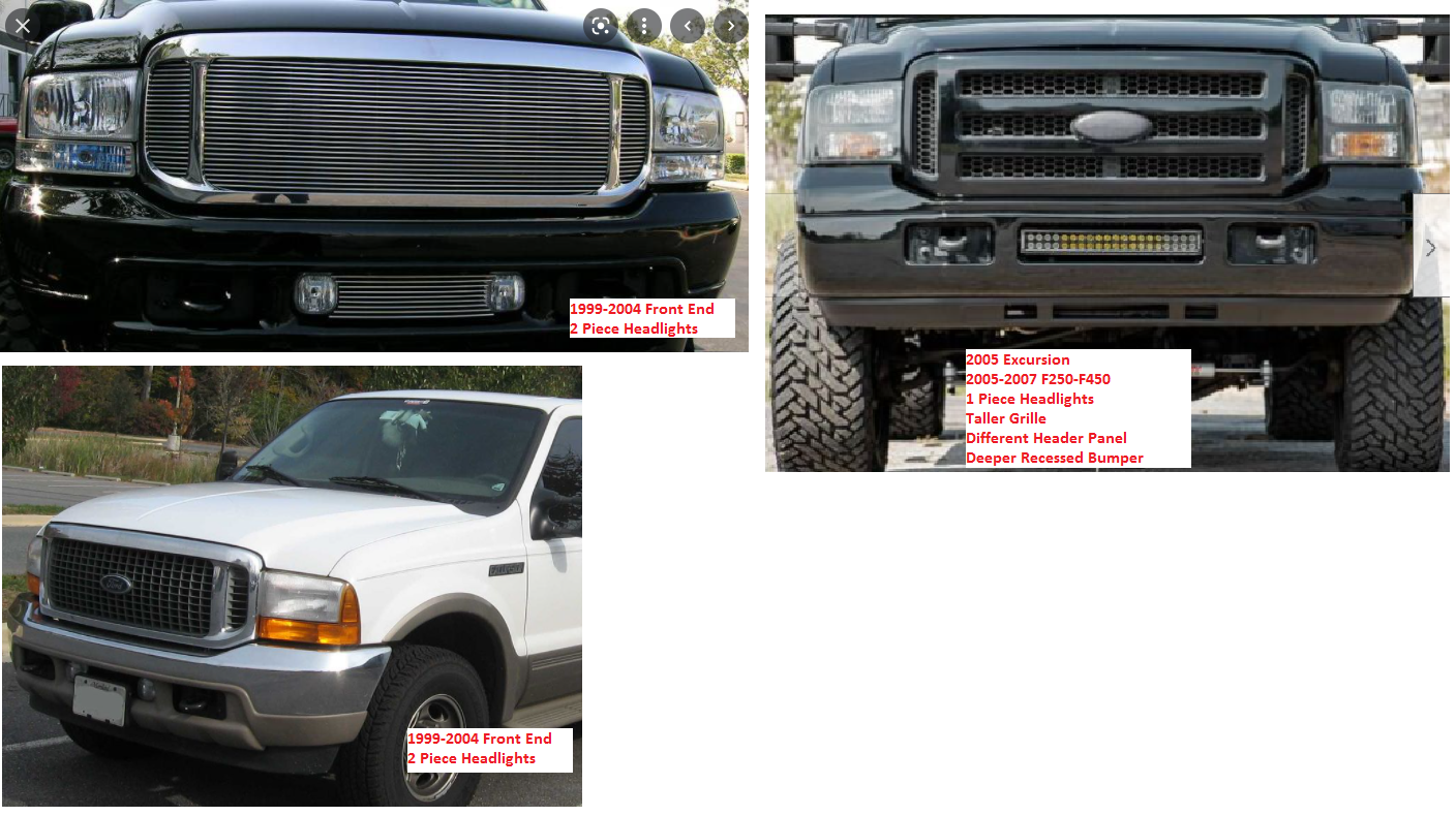

First of all, ONLY your 2005 takes H13. 99-04 Excursions do NOT, unless they have been upgraded to the 2005 headlights, which also requires either replacing the header panel with the 2005 version, or cutting up the 99-04 header panel a lot to make them sort of adapt. the 05 is different than 99-04 Excursions for Bumper, Headlights, Header Panel, Grille, and some odds and ends.
When you are going to go and correct someone, make sure you are correct in your statement. The bulbs you just linked to him, are useless to him unless he has a 2005 front end swapped on, or feels like doing one at the same time.

2005 Excursion Limited 6.0L 4WD. Nitto LT285/65R20 with V/C ATS Springs. Red Top steering gear. Sinister coolant filter. 160 Amp alternator. Banks Ram-Air intake. Power fold towing mirrors. Double DIN w/backup camera. Viper alarm w/GPS tracking. Alla LED lighting in and out.
