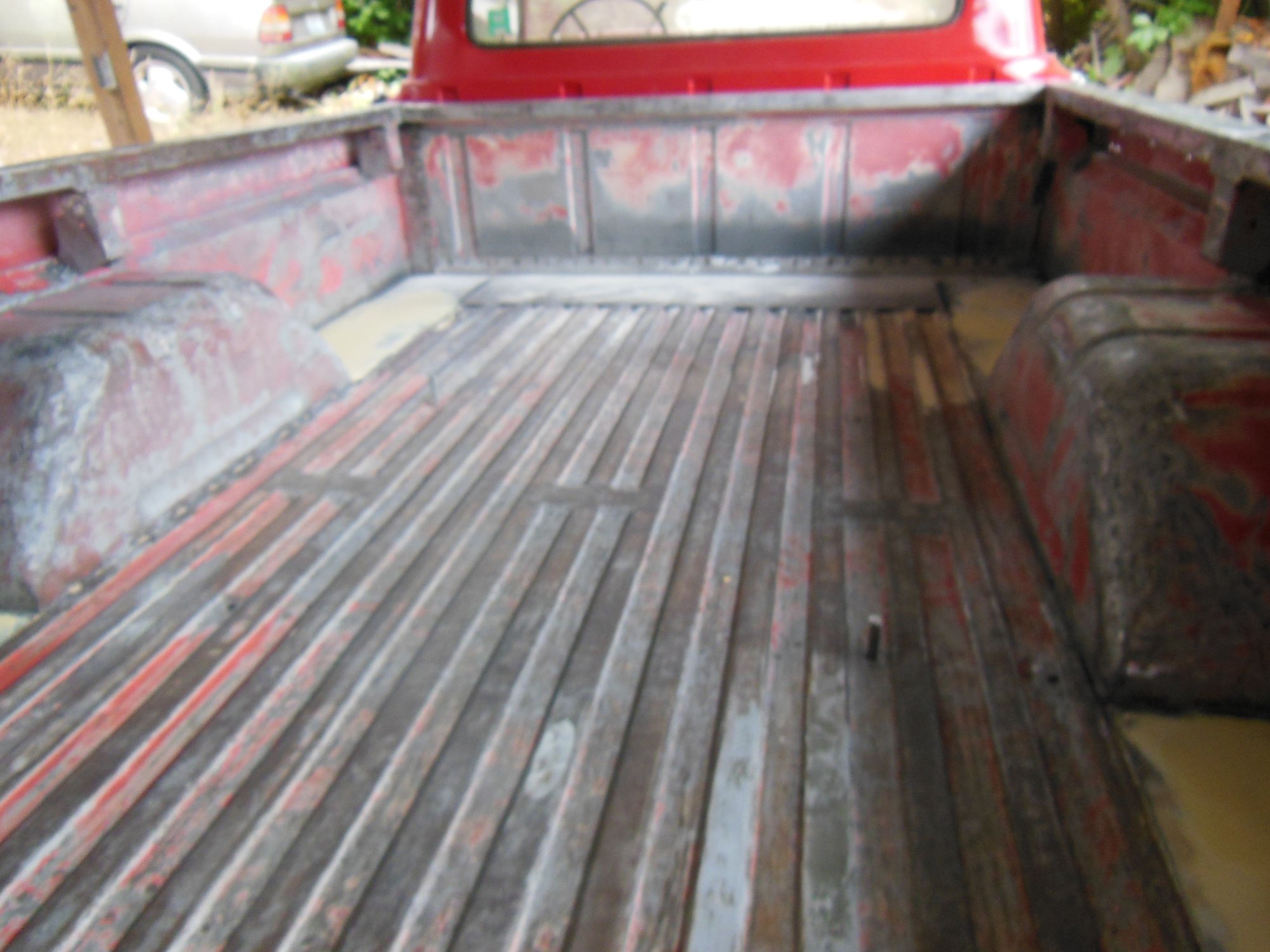

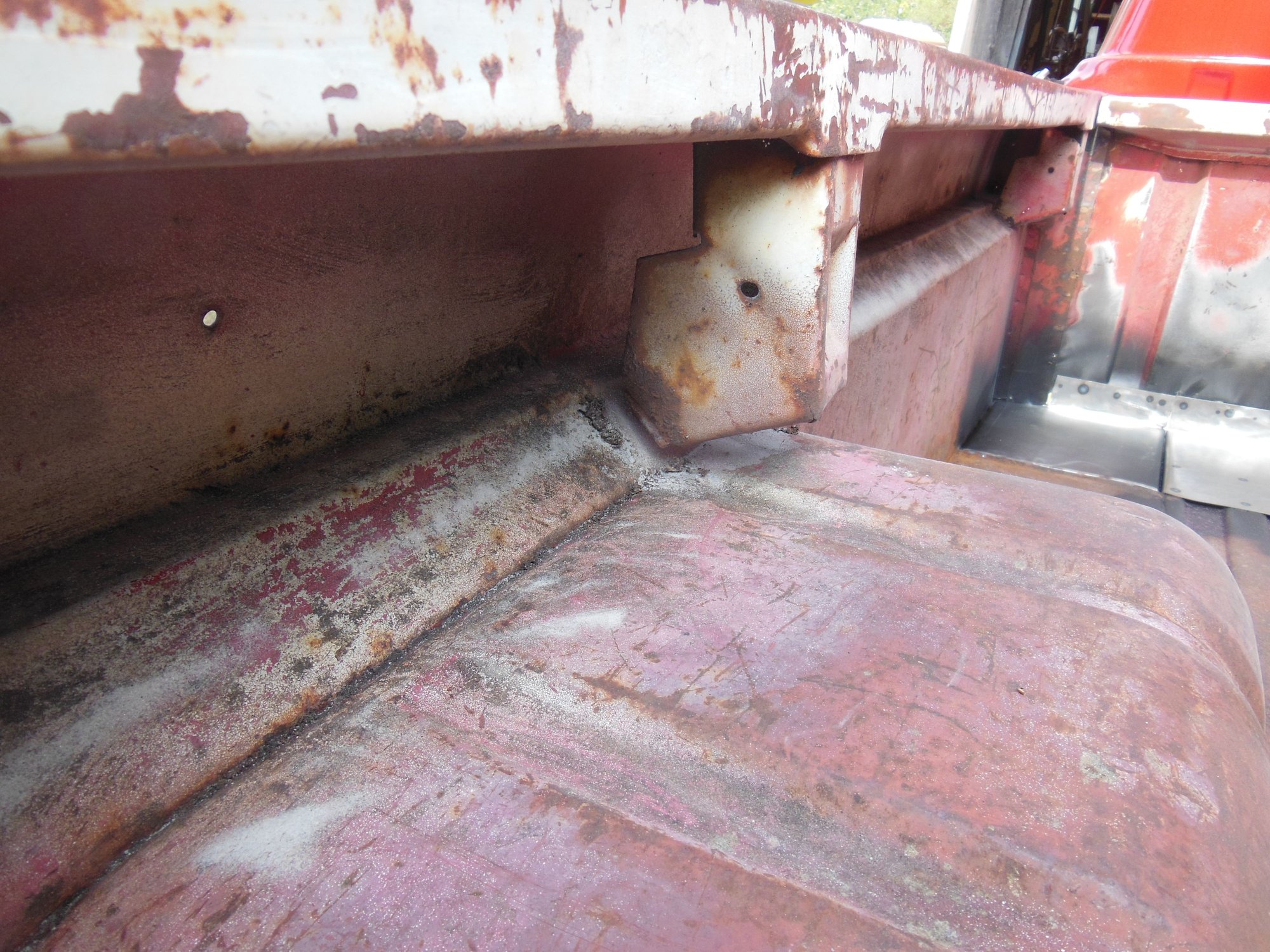

I wanted to make the two tone paint set up on my truck correct for a 1966 cc. I found a picture of what my truck may have
looked like new, I guess. My truck had a lot of over spray in the bed with the white overspray color coming down to almost the wheel arches in some places. I have seen pictures of the two tone color paint break line traveling the center of trim on the outside and inside on the edge of the fold of the bed. Does that sound correct?

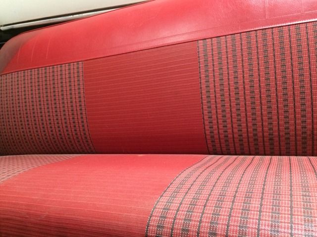

Your seat would have originally looked like this

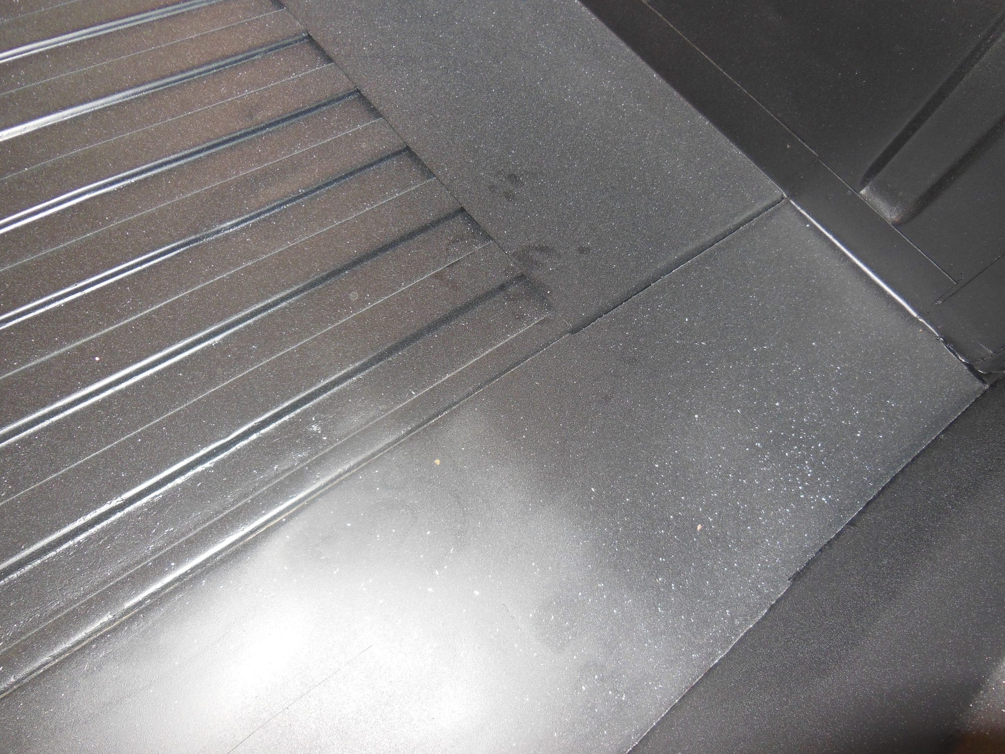

I sandblasted the bed and put epoxy primmer down on the top side of the bed and POR 15 underneath the bed. In addition, I put some coats of high build primmer over the epoxy to help hide some of the pitting and dents. My concern now is keeping the box clean from dirt and dust until I get the top coat in place. I will probably hillbilly up some plastic.
I do have the majority of the flaws out of the side panels and I might get by with one more coat of high build, so if we one of those beautiful falls I might go for it and put the top coat on to stop moister and dirt from working their way into the primmer. Yes that was my seat. I hated the material because it would wear out with these little sharp hairs like a cactus.
