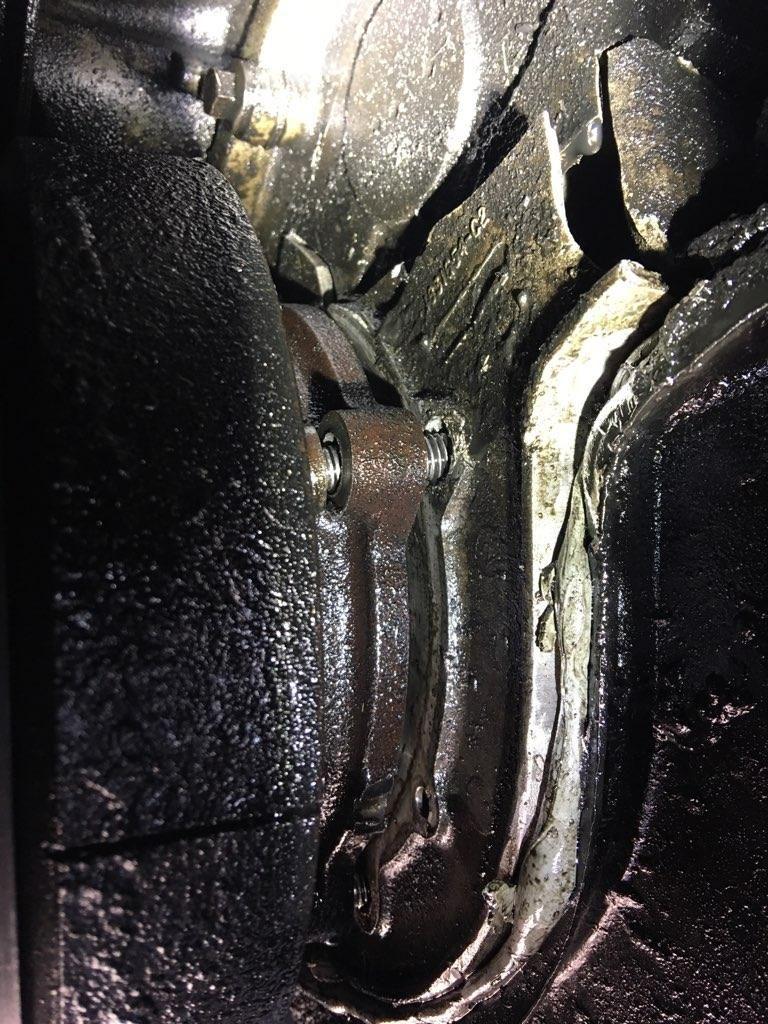

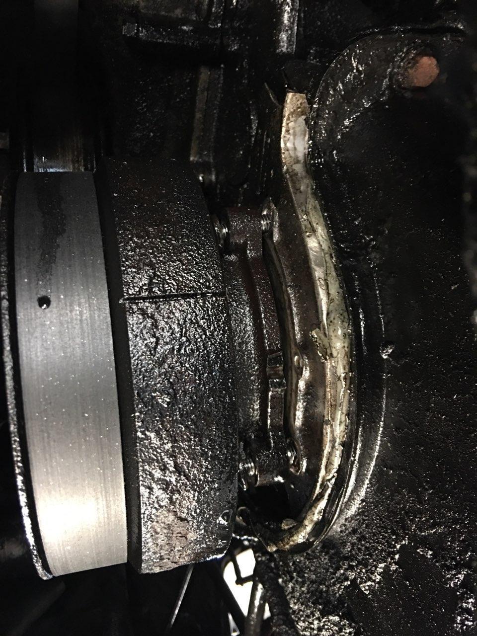

Old Sep 14, 2021 | 04:01 PM
HKusp's Avatar
HKusp
Joined: Jun 2007
Posts: 7,760
Likes: 27
From: Hampton, Maryland.
I haven't compared the 2 yet. I'll show you my front cover from the 2003 right now though, it ain't pretty.
